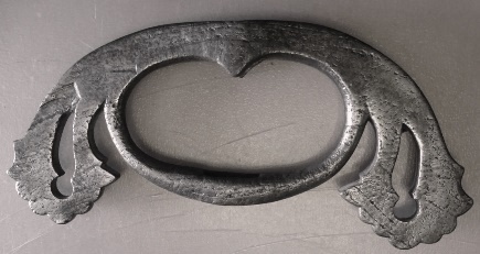

Guard now in hands; new pictures uploaded.

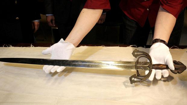

The closest example i find is the XVI century hilt El Cid Tizona blade has:

Old 30th January 2019, 03:15 AM   #3
M ELEY
Location: NC, U.S.A.
Posts: 2,211
That's it! That's the sword I saw and remembered had a similar guard! I kept thinking for some bizarre reason that it was on a Chinese sword!
Old 30th January 2019, 12:04 PM   #4
Let me first feel much obliged to Victrix, Udo and Mark for their participation in this topic's previous incarnation.

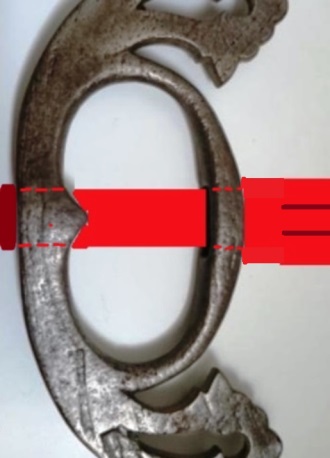

But of course, midleburgo, this is much too evident to be otherwise. The thing is that, i and my fellow collector skipped such hypothesis from the beginning as we became blinded by the double tang hole "detail". This differentiation only prevents us from calling it a replica in a strict sense but, this guard has definitely followed the Tizona style.
Now, what are we facing here ? The seller said this was found in the manor house of a family with military tradition, in the center of Madrid. Could it be ... or not. But then, why has the smith made it with with such particular difference; to fit a blade also with a particular shape ... or some kind of personal (or customer) innovation ? i (also) have paged a dozen books and found no guard with such mounting style.
A question i would ask: how old would it be ? It looks as having been hand beaten made ... no cast seams.
And worthy of note are also its specs.; 22 cms. between guard ends and an impressive 600 grams.
Old 30th January 2019, 03:50 PM   #5
midelburgo
Join Date: Jun 2005
Posts: 290
What I find weird is not the present piece design, which seems logical in the evolution of sword guards, but the lack of similar examples.
1)The first possibility is that it is a real early XVIth century Iberian hilt. But these swords are fairly light. 600 grams just for the guard is a lot.
2)I have been checking copies of Tizona, some of them well 130 years old, and none have that design in the lower guard. There have been pictures of Tizona for longer, some 160 years. If somebody wanted to make an accurate copy that was easy. But your piece is just a resemblance. I wonder why. If somebody would have just the picture from Laurent below, possibly he would have come with that design, not knowing what is at the other side, but the rest of the hilt would have been closer to Tizona.
3)Another possibility is that the guard was made in XVIIth or XVIIIth centuries for a San Miguel or Santiago church image. They wanted something looking medieval but at the same time technically closer to what was done at that time.
Old 30th January 2019, 04:50 PM   #6
All points noted; lots of reasoning ... thanks a lot.
I take it that, the smith who made this guard (or whoever commissioned it), was familiar with arms making and not passive of having to wonder what would be in the Tizona's opposite guard side, when looking at a flat drawing or a picture; meaning to say that this design was intentional and served a purpose ... be it for practical reasons or a challenging essay.
I myself, as you, keep thinking of its sturdiness; a guard with this weight would call for a blade and pommel to match with, perhaps also an unnecessary overweight for the relative solidity of a Saint's image; my uneducated guess.

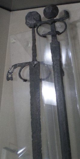

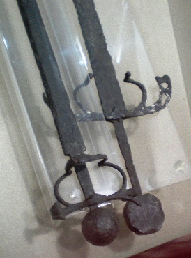

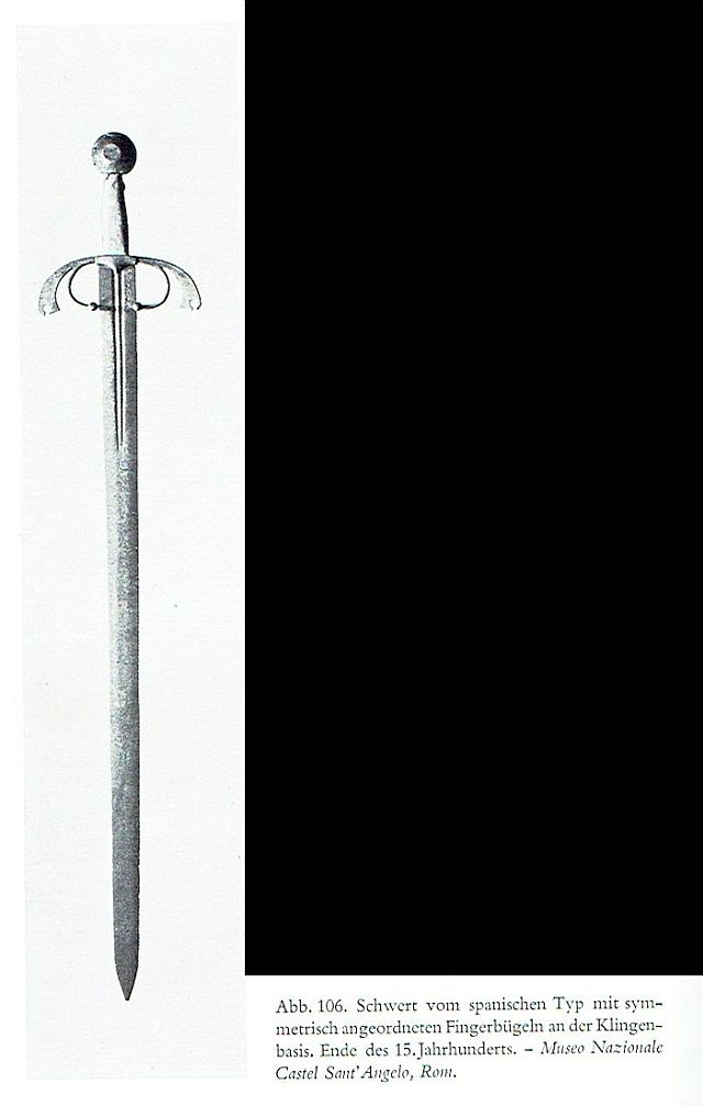

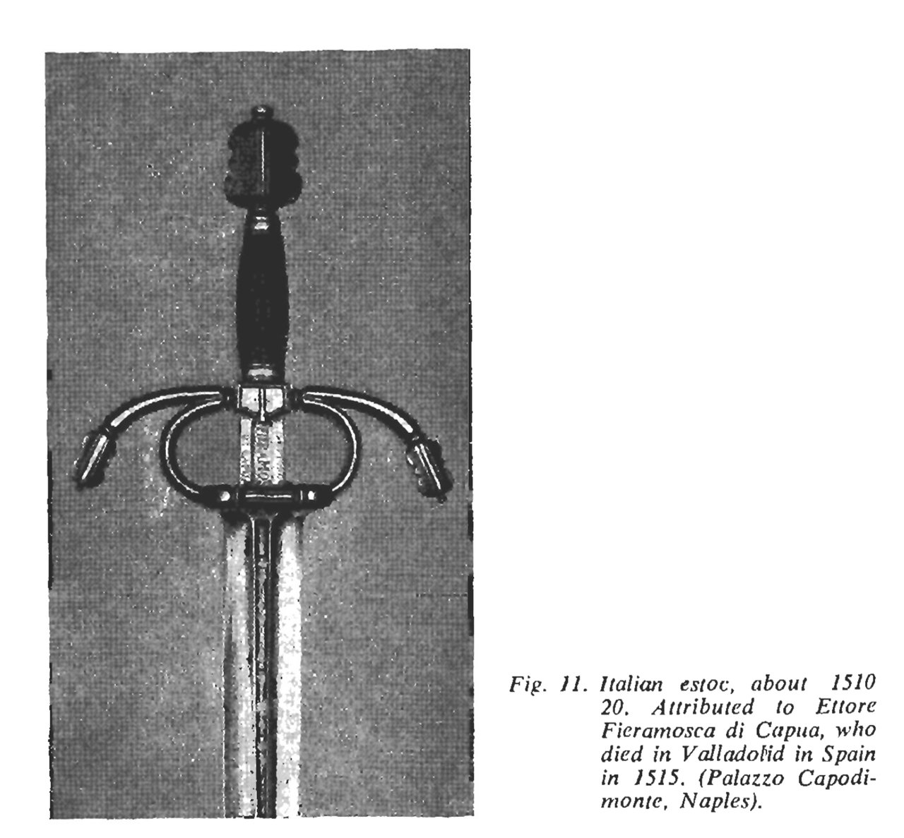

I found the following items in Heribert Seitz, Blankwaffen, Volume I and in the catalogue of the Wallace Collection, European Arms and Armour, nr. 539
corrado26
corrado26 is online now   Reply With Quote
Old 30th January 2019, 06:32 PM   #8
Udo, the main problem remains in that all of this type you see out there have side rings in their guards and not a full ellipse where both tang and ricasso have to pass through solid holes.
Amazing; i was precisely paging the Wallace collection and also recall having once taken some lousy clandestine pictures in the Sant'Angelo castle museum.

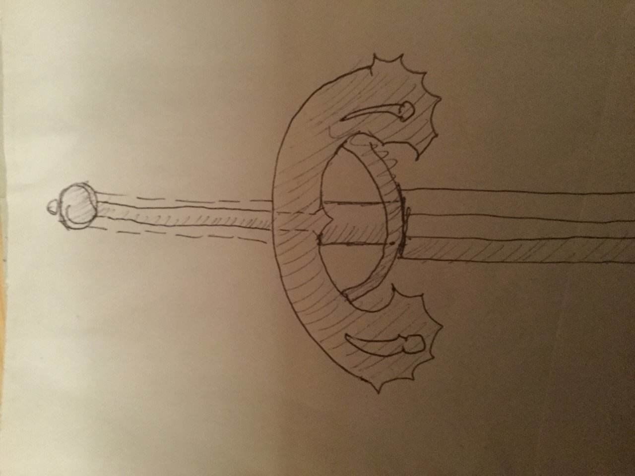

If only Victrix has kept the perfect drawing he has previously uploaded in the original thread !

The drawing is still with us. Luckily I scribbled something unrelated important on the other side so I kept it with me when I came home from my ski trip. I think the width of the tang should be narrower than the ricasso. The guard hole for the tang is smaller than for the ricasso.

Thanks for bringing back that good drawing. Yes, it is reasonable to consider that the tang is narrower than the ricasso. In my sketch i only cared to emphasize the blade passing through the holes.

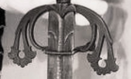

Take a look at this XVII century exponential example, in that only three fingers would fit onto the grip, two fingers left to hold the ricasso.
Note that the quillons are welded to the cup bowl rim, and not fixed with interior extensions, the first being a (more) Portuguese way.
... And don't forget to read my suggestions with a pinch of salt; i am only playing by ear .
(picture courtesy of "As Armas e os Barões" de Eduardo Nobre).
