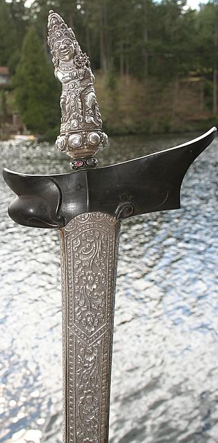

Hi All, here are some scans of my 1st Kriss. It was love at 1st sight - I even dreamed about it! After scanning some of the wonderful kris posted on the forum I can tell that mine is of recent manufacture. I think it's Balinese, based on the handle. The handle and scabbard are silver. The little ring with the stones are real star saphires and rubies (of low quality) - confirmed by a jewler friend of mine.
I love the handle, heavy carved silver - a beautiful sculpture! Being a neophyt to Indonesian weapons, it's a good 1st blade. I welcome thoughts and interpretations from the advanced collectors.

OK, let me make this clear to you guys who are suddenly becoming interested in keris.....you've made a terrible mistake......it's, ah, dha, yeah that's it....dha....it's dha you guys are really looking for. Ain't that right Andrew?
Seriously Greg, that's a really nice first keris you've got there. Frankly, from your photos i can't really tell if it's a newer Madurese "Bali" or late 19th-early 20thC actual Bali, though i do lean more towards a later blade. I can't really get a good feel for the finish based on your photos. The Bima hilt is probably 20thC, but very nicely done. I can see why you would be drawn to this piece.
Wouldn't mind some close ups and views of the sheath.

Very nice keris. I vote for late 19th-early 20thC actual Bali.

THAT IS A VERY GOOD WAY TO START A KERIS COLLECTION, THEY ARE MAKEING SOME VERY NICE BLADES IN BALI AND ARE EXCEPTIONALLY GOOD WITH THEIR WOOD CARVINGS AND METAL WORK ON DIETY HANDLES AND SCABBARDS. THE HANDLE ON YOURS IS A VERY NICE REPRESENTATION OF ONE OF THE MALE GODS, PERHAPS SOMEONE CAN SAY WHICH ONE.
I LIKE THE BALI KERIS BECAUSE OF ITS LARGER SIZE AND THE SHAPE OF THE ROBUST BLADES. I ALSO LIKE THE CARVING, METAL WORK AND STONES USED ON THE HIGHER END EXAMPLES. THE BALINESE DRESS IS SOMETIMES VERY BUSY COMPARED TO MOST OTHER KERIS WHICH ARE BEAUTIFUL IN A MORE PURE AND SIMPLE WAY. THE PARMOR CAN BE BUSY OR SIMPLE ON KERIS BLADES FROM MOST ANYWHERE AND ON SOME PENSULAR KERIS IS NOT EVIDENT AT ALL. YOU CAN FIND LOTS OF GOOD INFORMATION ON KERIS IN THE OLD FORUM POSTS AND HOPEFULLY SOME OF THE GREAT PICTURES WILL STILL BE THERE.

Hi Guys, thanks for the welcome, yes I've caught the bug . Here is a scan of the the full keris. The scabbard is covered in repousse' silver. Would this be a tourist piece or perhaps a presentation piece? I'm just starting to comprehend the place of the kris in Indonesian society.

Certainly not a tourist piece Greg. There is far too high a standard of quality of workmanship here. This type and quality level of silverwork and wood carving is still being done in Bali. I would still like to see some more close-ups of the blade though. I think this might be 20thC work, but that hardly implies tourist, just not very old.

The attribute held by the deity (Bayu?) is quite nice, with the fish eggs (telur ikan) on it. Anyone seen other hilts with such works?

Even though i wrote Bima before it i had meant to say Bayu, so i think you are right there. What is it about th held object that make you say fish eggs? Isn't Bayu often depicted holding a mirror?

Come on guys. You know the attribute of Bayu is a container of Amrita. See
http://www.mythfolklore.net/india/en...dia/amrita.htm
The figure seems to be missing the required crown for Bayu and has a mixed up head piece which resembles Bima's top knot hair work rather than Bayu's more elaborate styling.
Since it is a new piece I guess it might be a combination of specific portions of traditional hilts rather than a particular figure or possibly a representation of a Brahamn priest.

Guys, I know nothing about Hindu mythology, but the object in my guys' hand looks more like a calestial mirror.

Oh, I didn't mean the attribute was fish eggs; that would be a most interesting thought.
"Fish eggs" or "telur ikan" refers to the small little metal beads which resemble... fish eggs. Its a technique commonly employed in jewellery-making (including keris accessories) in India and S.E.A.
This is the 1st time I'm seeing it employed on the attribute of a Balinese figural hilt.
