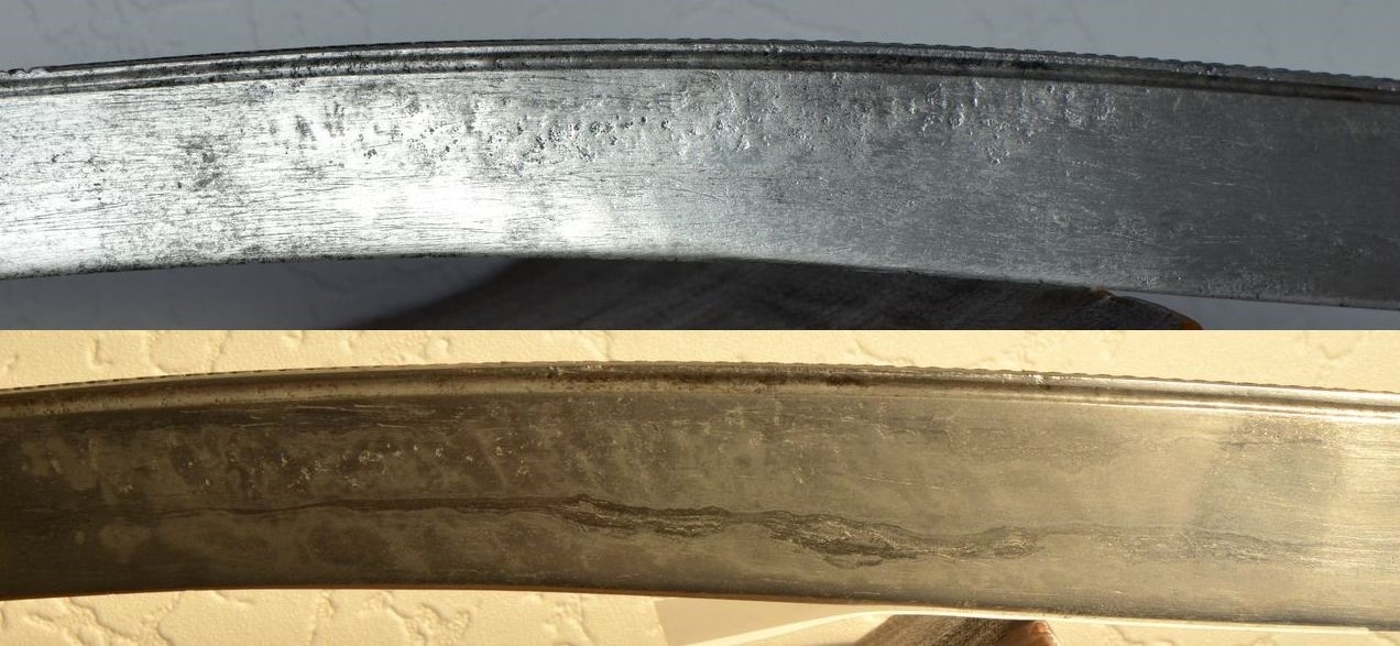

Hi,

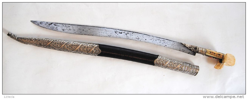

When dreams become true, here is my dream Yatagan
A Yatagan which was a present to an Austrian k&k-Officer, he served in Bosnia around 1900.

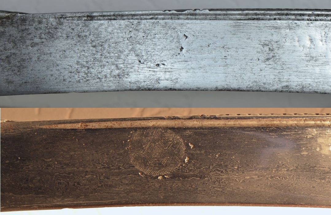

One side has an inscription, I hope, someone can translate the text. Thank you in advance. I found out, that the text starts with a number, probably a year, 1229 which equals 1814. The blade itself is older than the inscription, because on the other side are remains of a Koftgari and decoration in the middle of the blade (picture 8 & 9).

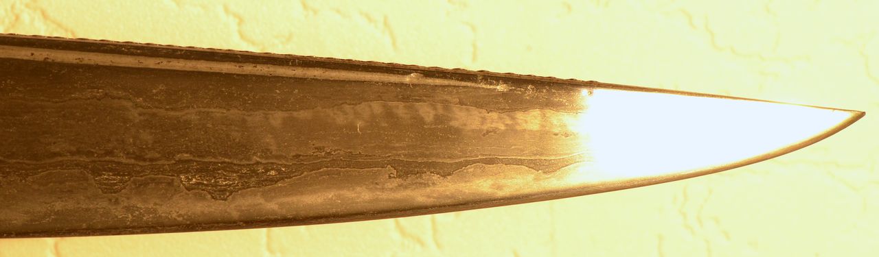

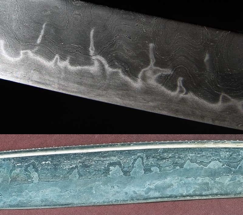

The steel is flawless and high quality. The steel below the silver inscription looks like very fine wootz, which turns slowly into pattern welded steel. I never saw such a type of steel before. It was a big surprise, to see this pattern after the treatment “What, How did he make this?” (this is no chevron blade), picture 4.

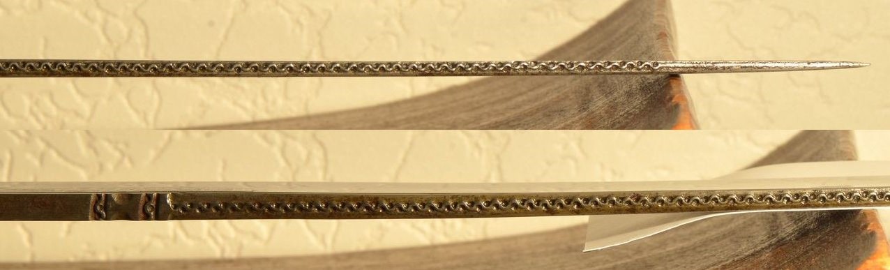

The back of the blade is decorated with hundreds of tiny drillings, which forming a sinuous line (pic 10).
The blade is twisted around 10 degree to the handle and my first impression was “omg, what a disastrous restoration”. But a few days later I found out, with the hand in the right position this unusual shape is very ergonomic. The heel of the hand must simply be located between the ears.
This is one of the few blades in my collection, which I define as my personal legendary blades, so I hope for benevolent comments and it would be very useful to see some other Yatagan blades.

The blade is of laminated steel with some impressive heat treatment "clouds". The first picture shows the blade in the best light. The other pictures seem to be photoshopped or taken under different light.

Agree with Rsword, this is laminated/layered steel, not wootz.

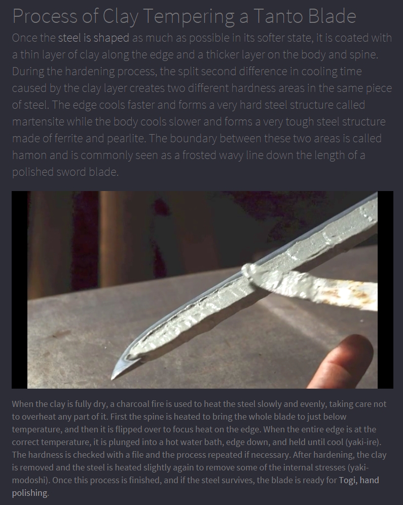

The steel used in this yatagan reminds me of the steel used in a Japanese sword, which is the result of folding and tempering.

I'm sorry, but these are no heat treatment "clouds", these are ultrafine layers of steel (there are structures inside the clouds).
Yes the other pictures are taken under very bad light conditions, it is completely dark, when i'm back from work. And i forgot to correctly adjust the white balance of my cam, thats all.
Roland, the structure of the metal looks exactly what one could find in some traditionally made Japanese sword. In a Japanese sword the temper line at the edge is created when the hot blade is quenched in water, sections of the blade are coated in a clay mixture, when the hot blade is quenched the metal coated with the clay cools at different rates creating the different looking patterns (differential heat treatment, simplified version). This method was not just used by the Japanese, other cultures used it as well. From the pictures you provided your yatagan blade looks like it could have received a similar treatment, there could also be a completely different explaination.

I have a Yat with a blade that looks constructed just like this one. Honestly, you don't often see this in Yat's; usually they're Turkish ribbon construction.
Not this crazy-pattern mechanical Damascus.

As a layered/laminated steel, it is a mechanical Damascus in a way, but not a typical one. There's no methodical attempt to manipulate steel into a particular pattern. This is a random mix, and the result of impurities that happened to be. There are many blades like this, especially Ottoman blades because they used all sorts of different types of steel. not all were designed or supposed to be etched.

Very nice and interesting yataghan, congratulations. I do not think there is wootz in the blade. To me it looks like it was forged from many (as in hundreds) of layers, somewhat similar to what we see on some Japanese blades.
