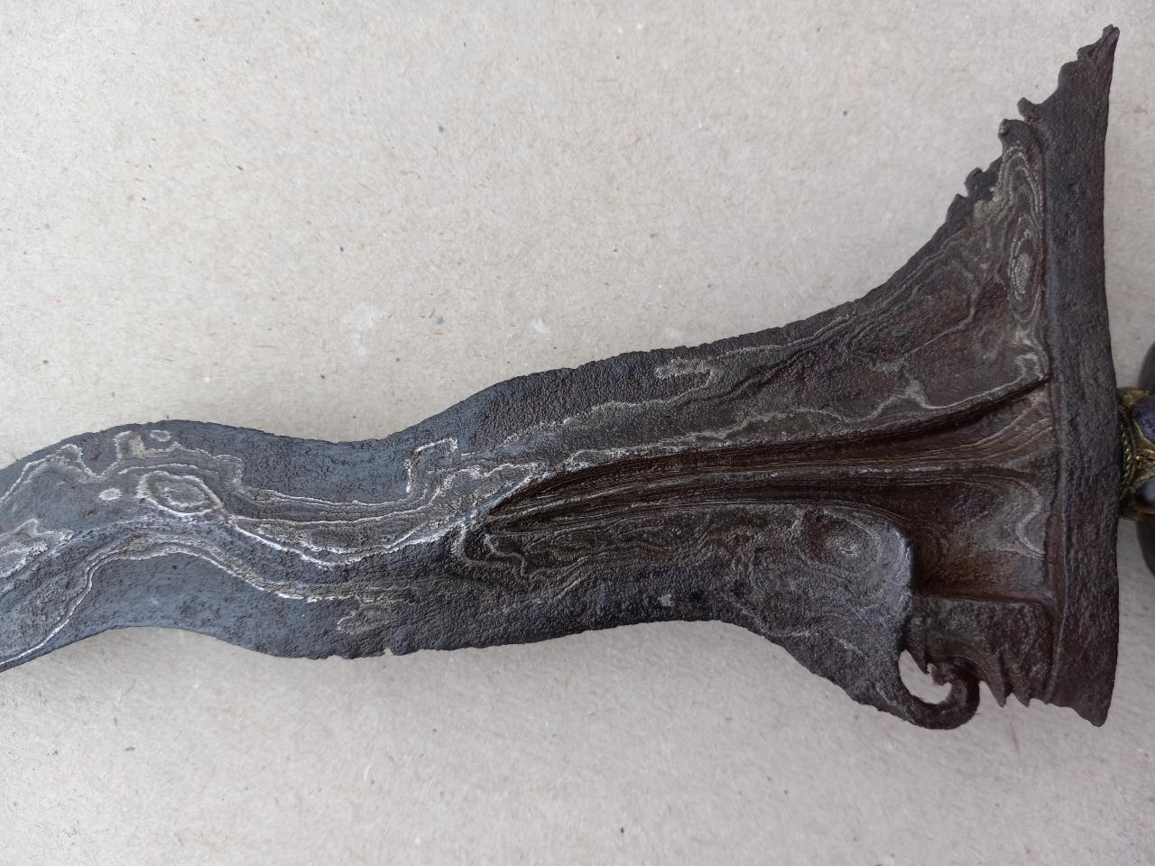

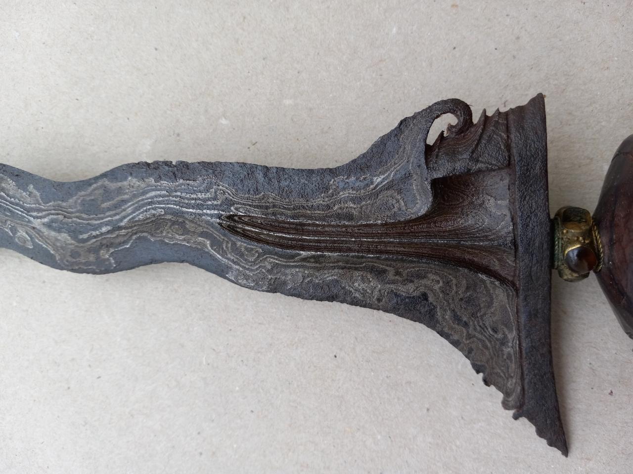

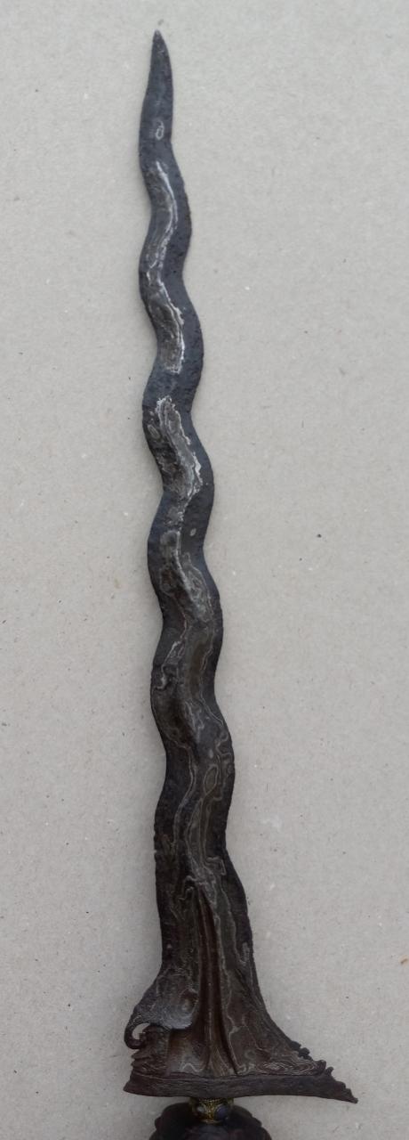

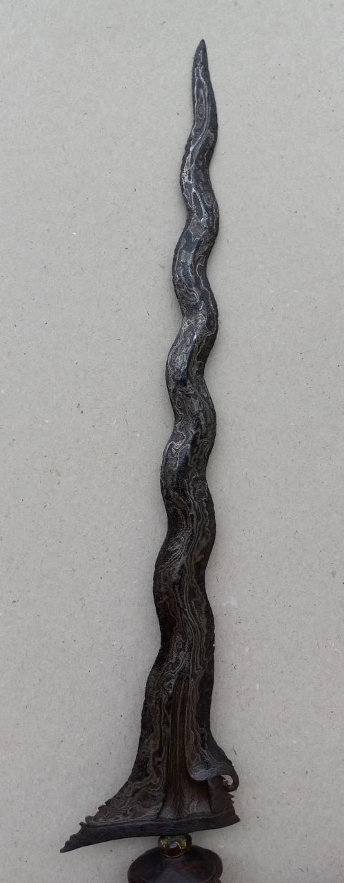

Hi,
I'm new, and I just thought I'd share some items from my collection. I would appreciate anyone's thoughts on this keris esp. in terms of dapur and pamor (which is something I'm still trying to familiarise myself with). It's dressed in fairly typical "dance keris" fashion, so I decided to just put up pictures of the blade. My apologies in advance for the low image quality.

Greeting Orang Lama and welcome to the forum. Nice to see another Maritimer here (i live in Nova Scotia ).
I suspect your keris might be more likely from Lombok rather than Bali. Firstly it has a rough topography, rather than the polished treatment most Bali blades received, but certain features like the gonjo don't seem quite fully in Bali form, but that might just be due to erosion. I am also not used to seeing Bali kembang kacang actually touching the gandik as it does in your keris, and i usually expect to see jenggot with ron dha on top of the kembang kacang when greneng is present on a Bali keris, but that also might be gone due to erosion.
We often see older blades like this in "dance dress". I think that perhaps before they began making those awful fake pamor blades they filled this tourist dress form with old unwanted blades. Not that this is a terrible keris. I actually quite like it. It is a 13 luk blade and i think the pamor is a standard wos wutah.
