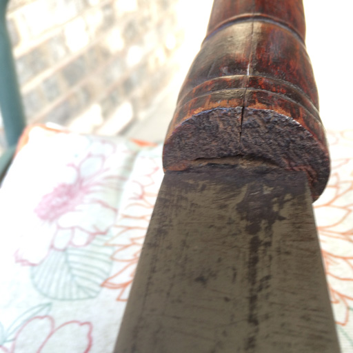

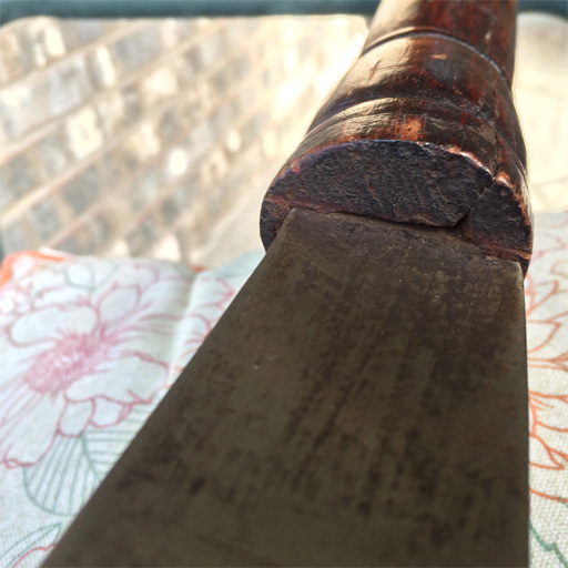

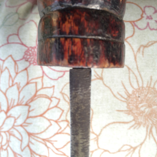

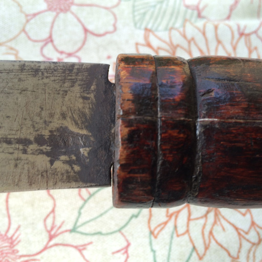

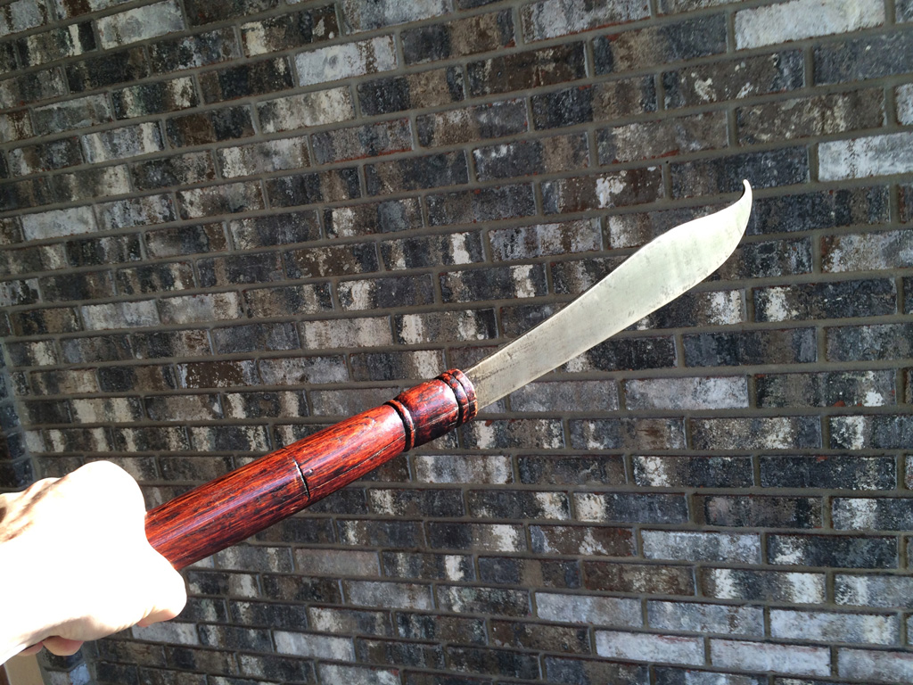

Hello all,
I have recently obtained a very interesting sword from a fellow forum dweller who is also a respected dealer. Let's call him "FFD" for now. The sword in question has what would seem like a solid identification from a respected previous owner (who indeed was so certain that he published it). However, FFD and I agree that the features don't seem to match. So what is it?
So as not to prejudice the investigation or produce a hasty conclusion, I will reveal the clues one by one.
Here is the first clue: the pommel. It is a hard wood with a deep brown-red color, lacquered. (The entire hilt, long enough for two hands, is the same and of a single piece.) The shape of the pommel is an elongated cone, at the base of which the shape is a reverse truncated cone that leads to the hilt grip proper. See the attached photo.
Anyone recognize this shape pommel?
Best Regards,
Dave A.

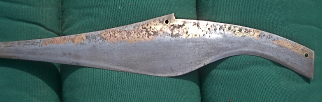

Hi Dave,
when I not complete wrong it is the pictured chopper you ask about. It is for sure not Indonesian like suggested but a Thai or Laos chopper when I am not wrong.
Old 9th December 2014, 10:35 PM   #3
Posts: 7,127
Looks a bit like an old-time Aussie cane knife, used for cutting sugar-cane --- yeah, yeah, I know its not, but it has similar features.
As Detlef says:- not from the Indonesian Archipelago.

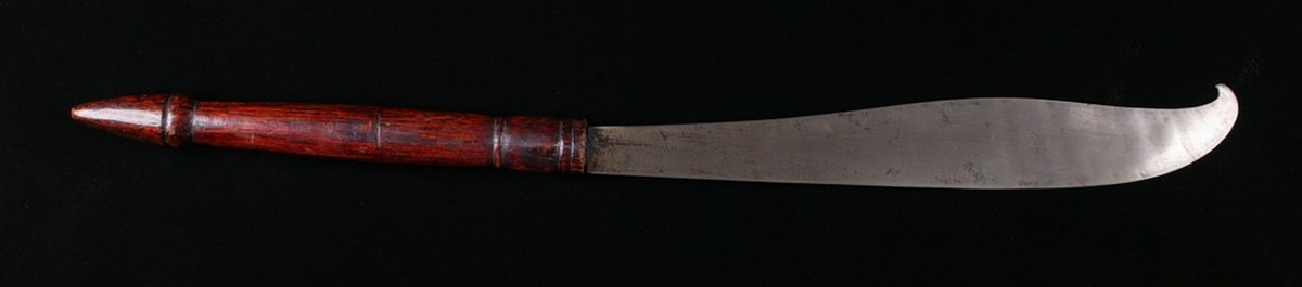

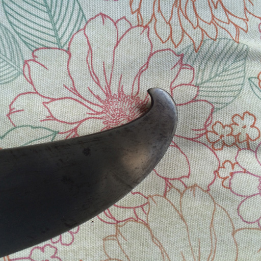

This is the same sword once in Tirri's collection and depicted in his book as you cite.
Here is what sets it apart from similar style cane knives/swords: It is sharp along the flat straight edge as shown in the picture, not the curved edge.
The Laos idea is interesting.
Other ideas?

Aussie cane knives are sharp on the opposite side to the hook.
After the cane has been burnt to get rid of excess foliage and snakes you cut and then turn the knife over and use the hook to throw the cane behind you. Its rotten work.
Like I said:- this knife is similar to the knives used in Oz to cut cane.
Interesting thing to me is that this knife has no ferrule. Balinese tools for cutting cane, grass, light scrub have either a solid ferrule, or a socket to accept the hilt. The construction of this knife shown appears to have no ferrule, which means that it seems not intended for any sort of heavy work, and certainly not as a weapon --- first bone you hit the hilt would split. Even knives intended to cut grass in Bali have ferrules --- in fact even the fruit knives and kitchen knives have ferrules.
So what was it designed to do?
Maybe harvesting some sort of fruit, or nuts?
Place a partial cut through the stem and use the hook to pull the fruit down?
No impact that way, hence no need for a ferrule.

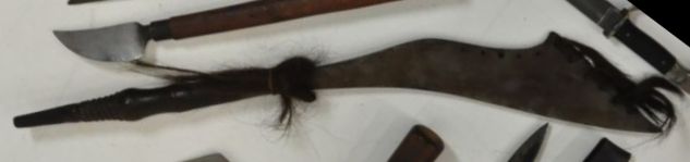

Hello Kai,
let me some time, my friend think that he have a picture but need to dig it out. The dimensions will show that it is not a cane chopper.

Posts: 7,127
Kai, Australia's early cane field workers were Melanesians. Essentially they were slaves. Young men and women were kidnapped, either by guile or by force and taken to work in the Queensland cane fields.
The practice was known as "blackbirding". It was a bloody disgrace.
But the upside is that the descendants of these people have produced some brilliant brilliant footballers.
Maybe the Australian Rugby League and Rugby Union should make ongoing donations to the Solomon Islands, and the other places that the ancestors of their best players came from.
Anyway, back to the knife.
Chisel grind?
Hook forms a hand-stop on the blunt back edge.
This design would be perfect for splitting bambu.
No, of course it is not any sort of chopper, let alone a cane chopper. No ferrule on a wooden handle and with a longish blade? How long would that stay in one piece if it was used to chop anything?

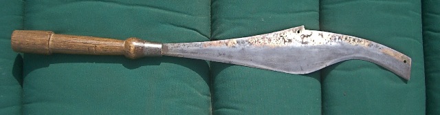

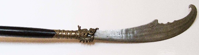

this blade is from an auction (Posting a link to a live auction is against forum rules.) and looks a little similar, especially the hilt. Description claims "Klewang".
Greetings

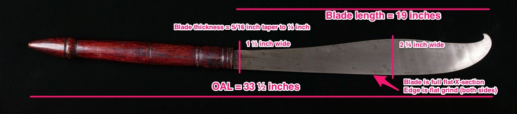

OAL is 33 1/2 inches
Blade length is 19 inches
Blade thickness is 5/16th inch with distal taper to 1/8th inch
Blade width is 1 1/2 inch at base and 2 5/8 inch at the widest point of the bulge along the backside.
The edge is sharp along the straight edge on through the curve up to the tip.
The blade cross section is full flat with a flat grind (on both sides).
This is a very solid and relatively heavy weapon. I've no doubt it would find good use chopping in the fields or in battle.
I will post some close up pictures soon.
Dave A.

Ian, the pommel resembles more closely an uncircumcised penis than a flower, but for me that is no clue.
Alan, we've discussed nomenclature before and I concur with your view. My interest is far less in what this sword is called and more in its regional and ethnic origin and function.
The idea that this sword might be related to a Naga Kabui weapon used for dancing was the first to occur to me when I saw it for sale. Please see the pictures attached - two depict my Kabui dao and the third is a dancer with a substantially smaller Kabui dao. My Kabui dao is a two-handed weapon of roughly the same size and even greater heft as the mystery sword we are discussing. The overall length is 25 1/2 inches with a 16 inch blade. Also, the Kabui dao is sharp on the curved edge, not the straight edge like our mystery sword.
I consider Assam as fertile hunting ground for identification of weapons that don't seem to fit the surrounding regions very well. Consider: The Kabui are one of the Naga tribes who reside in the area around Manipur. The dominant sub-tribe is called "Rongmei". In Manipur, "Zemes" and "Liangmais" together were recognised as "Kacha Naga", while the "Rongmei" and "Npuimei" as "Kabui".In the Brahmaputra valley and nearby are found other tribes such as the Kuki, Kachar, and Khasi. [See references below]
Much blending and cultural interchange has occurred since British occupation, but they retain distinct identities. The Kuki tribe is known to decorate their weapon blades with copper and brass and this may have, for example, influenced the decoration of my Kabui Dao.
This has led me to the idea that Assam deserves more attention; there is scant information available regarding edged weapons of the region.

Posts: 9,470
The here shown blade is a pole arm from Tonkin area owned by my friend, 19th century. The edge is on the same side like the mystery sword from Dave. We think that Daves blade is a similar pole arm blade with a later handle. Please note the reddish lacquer on the handle from Daves chopper, something what is typical for this region. My friend still search for the picture in his large storage.
Old 11th December 2014, 10:18 PM   #29

Default Reiterate Dimensions & more pictures
Since this thread is getting long, for your reference here is an annotated picture of the sword showing the dimensions I reported earlier.
I also am attaching:
  • three pictures of where the hilt and blade meet
  • a top-down thickness picture
  • a tip detail picture
  • a picture showing me holding the sword with one hand -- note this was very difficult due to the weight distribution. This is not a one-handed weapon unless you are very strong.
Thank you very much for the comments and discussion thus far!
Dave A.
Old 12th December 2014, 06:28 AM   #30
Posts: 4,597
Detlef: That Sino-Vietnamese polearm is socketed whereas Dave's sword has a tang. As far as I have seen, polearms from Vietnam are all socketed in a similar fashion to this one. Similarly for polearms from Burma, Thailand, and Laos. While the blade shape and edge seem to have the same orientation as Dave's sword, the attachment to the handle is completely different.
Dave: As I noted earlier, and I think Alan agreed, the Kabui attribution seems a bit shaky based on Rawson's description and picture, and what you have shown here. The blade of the Kabui dao has a significantly different shape from yours, having a diamond shape and being especially wide midway down its length. Also, the hilt of the Kabui dao has a ferrule and its sharpened edge appears to be on the same side as the hooked tip; both of these features are different from your dao.
Thanks for the close ups of the hilt and adjacent blade. That hilt looks as though it has been on the sword for a while. I'm also seeing a crack in the wood that runs through its end, and Alan's earlier comment about the lack of a ferrule leading to splitting in that area may be pertinent.
I agree that Assam and neighboring parts are an interesting mix of styles, with ample opportunity for blending and migration of styles at the local level. The Kuki dao, for example, is another hooked tip sword but has a solid brass hilt of various forms.
