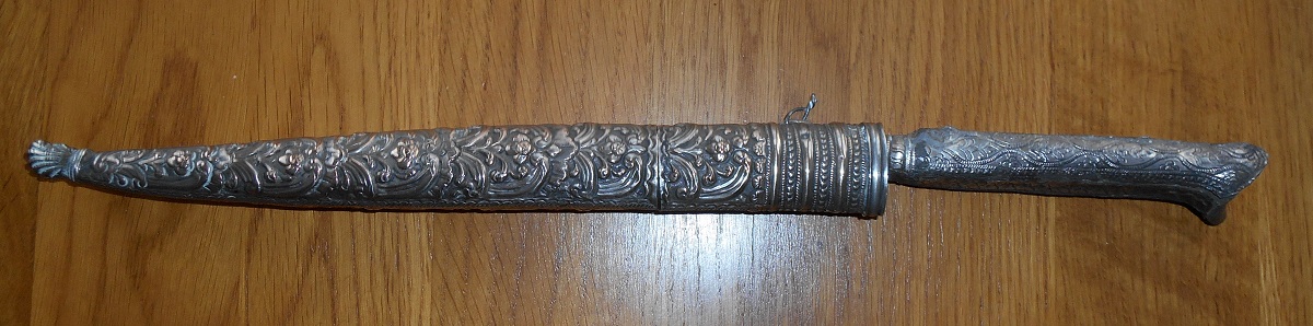

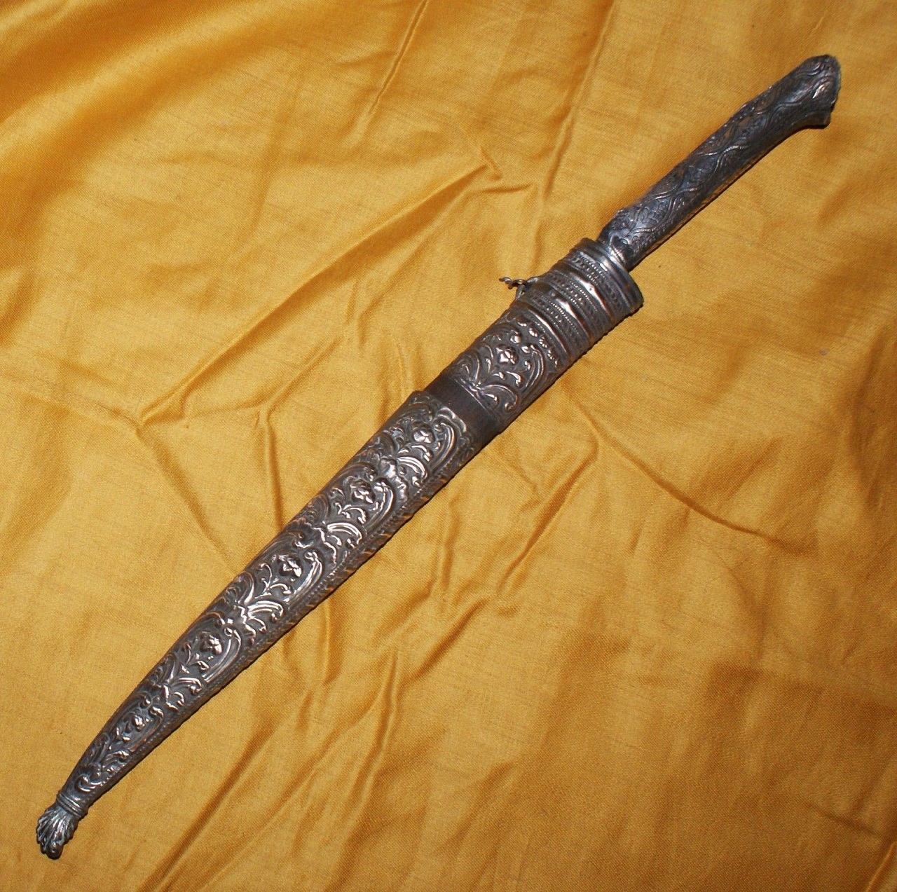

Dear All,
I have a small problem.
Is it possible to remove a silver fitting from a scabbard to fit it correctly?
It's a scabbard from an Ottoman bichaq and the tip of the scabbard was fixed and glued(?)... Is it possible to reverse this bad reparation?
Thanks
