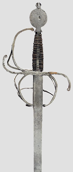

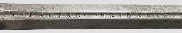

Does anyone have more info on swordmaker Pietro Hernandez ?
All i could find online is https://www.flickr.com/photos/thoog/...57607963343849
Blade: Spain (Pietro Hernandez), Toledo; Hilt: Italy (possibly Belluno), 1580-1610
I saw this swordmakers name on a hilt that looked much like this one, altough the shape of the hilt that is. The one i saw was plain , no etching but some left overs of guilding.
All info on Pietro Hernandez is most welcome.
Thanks in advance
Ulfberth

In a descriptive catalogue of the Real Armeria de Madrid (1898) two sword blades (G202 and G203) are described to be made by Pedro Hernandez, a name not cited by Palomares or Rodrigues del Canto, but with a sword in the Dresden Museum, with the punction of Toledo.
The Pedro Hernandez marks in the Madrid blades are a crowned F and a crucifix.
The Italian sounding name Pietro (and not Pedro) figuring in some blades out there could be from someone copying this 17th century Toledo master.

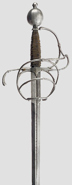

Old 15th July 2014, 01:10 PM   #9
Originally Posted by SwordsAntiqueWeapons
One from the past for reference;
http://www.vikingsword.com/vb/showth...ight=Hernandez
Post # 72 I show another sword by a "Hernandez"
Gavin
Such a beautiful blade, Gavin.
But assuming it was forged by the real Hernandez, it is remounted in a hilt at least one centuty later ... the so called 'boca de caballo' (horse mouth)
... if i am not talking nonsense .
