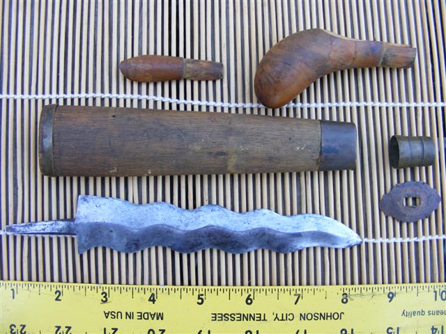

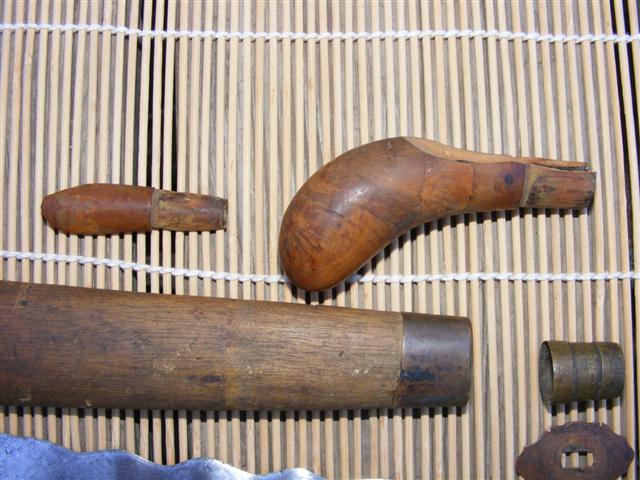

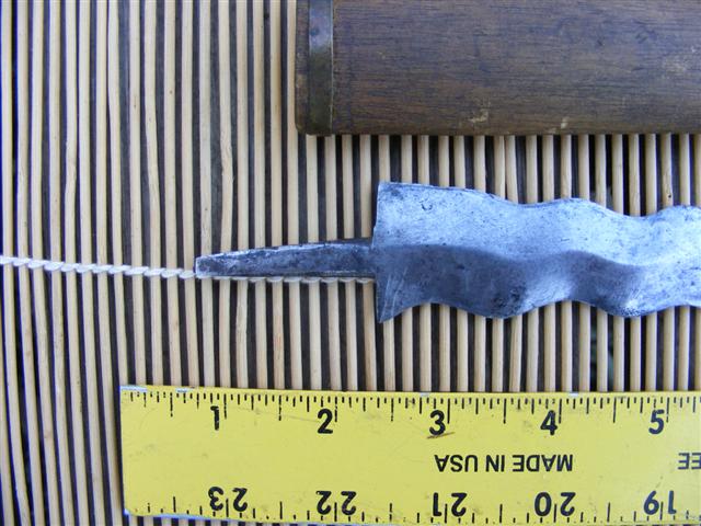

Well. it has arrived and here are a few new pictures taken after I did a light cleaning of the blade. The blade is laminated and it is quite clear when holding it in the sunlight but I don't think it can be seen in the pictures. The hilt as can be seen has a piece broken out of the top that needs to be glued back into position. There are no designs engraved into the rather plain copper guard .
The sheath is missing one of its brass bands which will be quite easy to replace. Any opinions on the best way to proceed with the hilt repairs including what will be the best glue for the wood and where to obtain cutlers resin "or pine resin to make my own" to reset the blade with would be greatly appreciated. The reason I am asking about glue is because what I used to use is no longer being made.

I USUALLY USE ELMER,S WOOD GLUE ITS WHITE BUT DRYS CLEAR AND IF YOU WIPE ANY EXCESS OFF WITH A WET TISSUE WHEN IT DRYS IT IS NOT EASY TO SEE THE HANDLE REPAIR.
I DON'T KNOW HOW TO MAKE THE TYPE OF GLUE YOU WANT BUT PERHAPS TAR WOULD WORK AS IT COOLS HARD AND CAN BE HEATED TO REMOVE IT LATER. THERE ARE SOLVENTS TO DISOLVE IT AS WELL IF YOU MAKE A MESS.

Hello Robert,
Could you please provide a close-up of the inside of the hilt (hole for the tang)? That's a rare opportunity to have a closer look...
I'd also favor a traditional wood glue. However you'll need extra efforts to prepare a mold/cushion so that you can apply even pressure while the glue sets (a good bonds depends on the pressure but, obviously, you don't want to crush the hilt either); allow for some generous extra time (days) for the glue to set perfectly.
If this seems too much of a hassle, an good epoxy glue will also give an acceptable bond.
The break looks clean enough. Woods with higher amount of natural oils can result in weaker bonds though; you could try to degrease the break surface with acetone.

Wood glue for boats is good since it's hardening more fast as normal wood glue. For fixing/pressing you can use wire with underlay tissue of course.
I am very curious to see the dagger when you have finished your work, I am sure it will be a beauty.
Old 30th October 2012, 09:20 PM   #18
ONE THING TO REMEMBER WHEN DOING A GLUE JOB LIKE THIS ONE IS TO SWAB OUT INSIDE THE HOLE FOR THE TANG SO EXCESS GLUE DOES NOT DRY AND OBSTRUCT THE TANG LATER. HARD GLUE CAN BE DIFFICULT TO REMOVE ESPECIALLY THE EPOXIE TYPES.

Hello everyone and thank you all for the advice on what type of glue to use and the tips on making the repairs.
Kai, I will post the pictures of the inside of the hole in the hilt sometime tomorrow both with and without the broken piece in place and one of the open end where the tang is inserted. If there are any others that you would like just let me know before I get everything glued. I always allow a minimum of 72 hours drying time for any repairs using an adhesive before removing the clamps.
Detlef, The glue that I used to be able to get was marine glue from one of the local boat repair shops but unfortunately it is now out of production and they are using an epoxy glue now. The one that I was using was a water based glue that was not affected by water after it had dried.
Barry, tar just might work if I add a few things to it "like when making cutlers resin" to help make it firm when cooled. As far as Elmer's wood glue goes I used to use it before I started using the marine glue and will more than likely use on this repair. I was hoping that there might be something better on the market that someone has had experience using that might be better.
Thank you all again for your help and advice on this project and I will for the first time take pictures during the entire process.

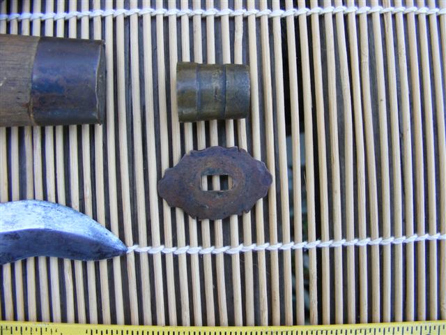

After closer examination of the scabbard it looks as though there are two bands missing. The top of the scabbard shows evidence of a wider band and there is also evidence that there were originally two narrow bands. I was thinking of making the missing top band the same style as the ferrule. What would be everyones thoughts on that?

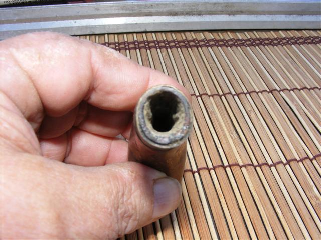

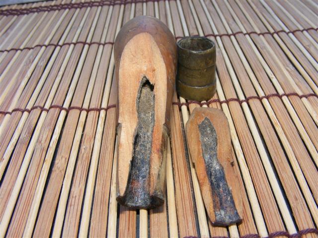

Kai, here are the requested pictures of the hole for the tang. If these are not what you are looking for please let me know.

Hello Robert,
Thanks!
Can you ascertain what tool was used to drill the hole?

Kai, As far as I can tell the hole in the hilt looks to have been burnt in, It was more than likely made by using a small round piece of metal that would be heated red and then forced into the wood as far as it would go then the burnt material would be cleaned out with a small thin blade. This process would then be continued until the hole would be of significant depth for the tang to be inserted its full length. This could explain the irregular shape of the hole, larger at the starting point and smaller at its end but not maintaining a true taper. It would also explain the burnt wood smell that I noticed when cleaning the remaining adhesive from the inside surface of the socket. Of course this is all just speculation on my part and there is no way to prove that this was the way it was originally done, though it does make for a good story.

If there are no more questions on the hilt construction I am going to start the restoration process. There is one more question that I would like to ask. If anyone else has had one of these apart, was the tang offset from the centerline of the blade like this example? Thank you again for everyones help and suggestions.

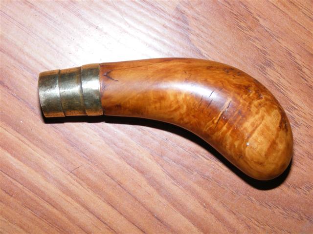

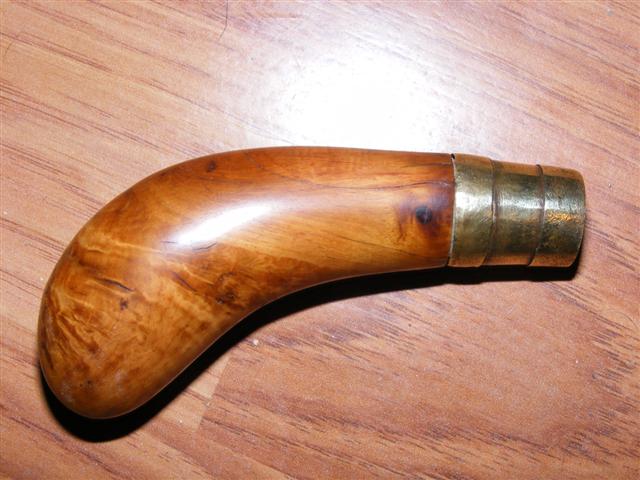

Hello Detlef, Thank you for asking. I was thinking of posting these two pictures when you posted your reply. The hilt is done the best that I can do for the damage that it had sustained. The edges of the brake were really dark so I did a bleach job on the them and this is the result. They are now no where as dark as they were before bleaching and the seam though still quite evident is not as obvious as it was before. All it needs now is some wax and as far as I am concerned it is finished.

Wow, very well done! Now I am curious to see the punal when it is complete again!
Old 13th December 2012, 02:44 AM   #29
Posts: 7,401
Nice job and you brought the burled wood back!

Detlef and Jose, thank you both very much for your kind words on my work so far. To be honest I was hoping for a little better result on the repair that I have done to the broken hilt but sometimes things just do not turn out the way you want them to. I will be posting more pictures as the restoration progresses. Thank you both again.
