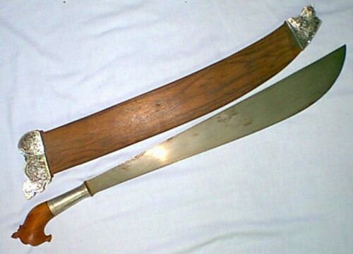

this item ended on ebay last night:
http://cgi.ebay.com/ws/eBayISAPI.dll...tem=6504641355
now, this past weekend while being confined at work for 16 hours each day, i was once again leafing thru cato's book for the umpteenth time. on page 23, there's a sword that has a very similar blade on the item provided above. the only difference being the hilt.

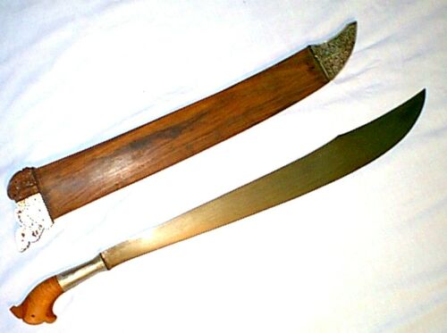

well, about a couple months ago, an item similar to cato's book was sold on ebay. here's the link:
http://cgi.ebay.com/ws/eBayISAPI.dll...762592922&rd=1
to zel, labantayo and everyone else that are very familiar with visayan swords, am i seeing things or has this been discussed before? what do the southern people call this specific sword?

Spunjer:
The same dealer as the more recent item you mention had another similar sword recently: http://cgi.ebay.com/ws/eBayISAPI.dll...tem=6503472828
Both this one and the one you referred to are Visayan. They have a very "sparse" or blank form of the Visayan deity hilt, indicating they likely originated from Panay. The guards and scabbards on these two are almost identical also, although the blade profiles are a little different.
The earlier item you mention I believe was discussed here previously. If I recall correctly, it was thought to be a version of the Moro naga-hilted bangkung.

Remember the other sword being discussed. Though I'd be more inclined to classify as a shandigan barong with sharpened false edge and Naga hilt? Bangkung I've always associated with more kampilan-esque blades or the "Moro" version of the binagong (now this is if Im remembering the Binagong definition right compared to tenegre and of course if Im even spelling it right) or the lumad tribe kampilan-esque weaponry.
I agree with Ian 100% on the first ebay sword. Modern era (well relatively) tenegre (ok Im cautious with this term cause I mess it up all the time, but just because I dont feel like saying Visayan Bolo I'll use it). The sword on pg 23 in Bob's book is a Naga hilted barong. The picture in the book is a little wierd due to printing.

as far as that item that was sold a couple months ago, i believe it was agreed to be a variation of barong/bangkung type. after i saw the picture while leafing thru cato's book this past weekend, that's when i remember that ebay item that was discussed a couple months ago.
as for the binangon (don't worry fred, i didn't know there was a difference between that and a tenegre til zel pointed it out to me; heck, i'm ilonggo to boot ), i just can't shake the feeling on how the shape of the blade is strikingly similar to the one on cato's book and the ebay item, save for the shandigan blade.
Its because it has a rounded clip point. Its there, but because it is somewhat rounded that is why it is throwing you off.
As for Bob's book, I can assure you 100% it is a standard barong blade. Play around with picture angles and barongs, and you can sometimes get some interesting results.

You'll see alot of similarities with weapons among the various ethnic groups in the Philippines...sometimes they look so similar it's hard to differentiate. Take for instance the blade form which is found throughout the Philippines where the blade has a straight cutting edge and widens from the hilt to the point and the spine curves back down to the edge. You see this in the Sulu bangkung, Ilongo binangon, Cebuano ginunting, T'boli tok, as well as the binakoko of Luzon.
The Moro sword you pointed out is one of those rare Moro oddities. Really, I don't know what to call it, but if I had to I'd call it a rare barong variant. At least the scabbard looks like an older barong form. Whether it has a specific name, that I really don't know. I've only seen one other sword like it and it was in an illustration in the book Sword of Valor. Looking at one of those "Weapons of the Moroland" souvenir plaques it looks similar to the laring or the lahot, although I've never seen actual examples of those weapons. I do offer a couple of possibilities courtesy of our own fellow forumite Vandoo who seems to stash away every kampilan and odd Moro sword around . The first is a gupad and the second a kambontouli.
