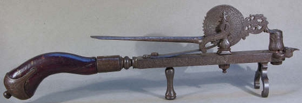

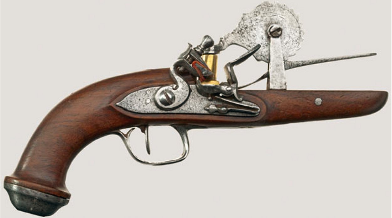

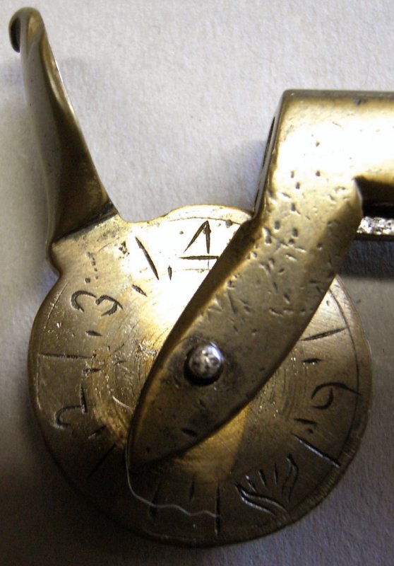

Well, unusual for me, as i have always seen these things shaped like pistols ... handle, trigger and all.
This one has a more austere look, more like a 'lab tool' .
... and the ignition system is fascinating; different from the classic flint or percussion mode. Was the technique priming the touch hole lip with some powder or instead the match cord way ?
An 18th century example for sure, right ?
The handle is horn; which type, i don't know for sure.
... as i wouldn't know the origin of this device .
Any help in part or the whole query, please ?

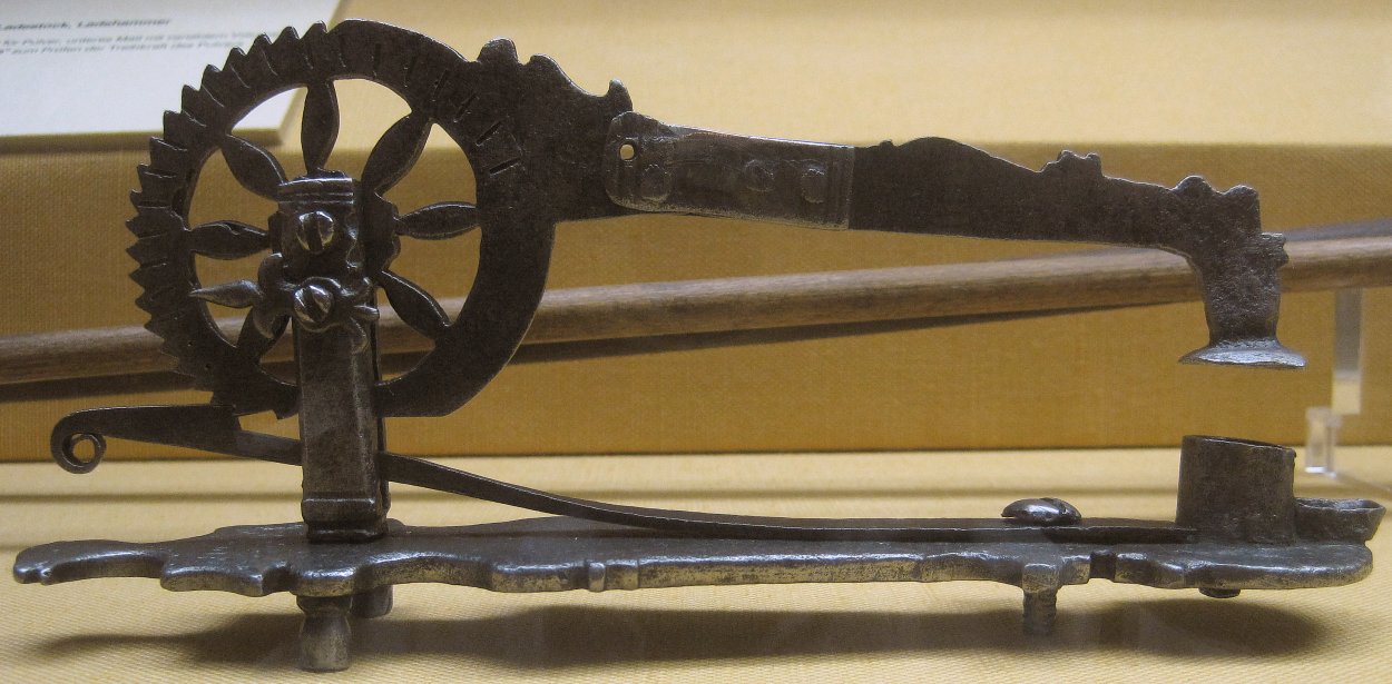

Attached please find images of a flintlock table lighter for ignition of a matchcord, first half 18th c., another for igniting a candle, English, mid-18th c., and a flintlock powder tester, ca. 1800.

Thank you for the prompt reaction, Michl .
I suspect however that my point was missed .
I know (knew) how powder testers work, as i am familiar with candle lighters; but none of those have a straight handle or and a manual ignition system, instead of the current mechanical ones ... flint, percussion, etc.
I also don't see how in the 19th century, this 'cannon/gonne' ignition style was still in use

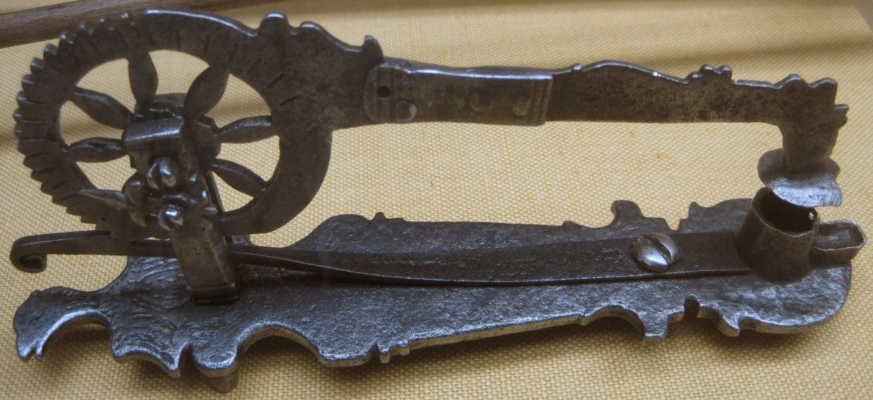

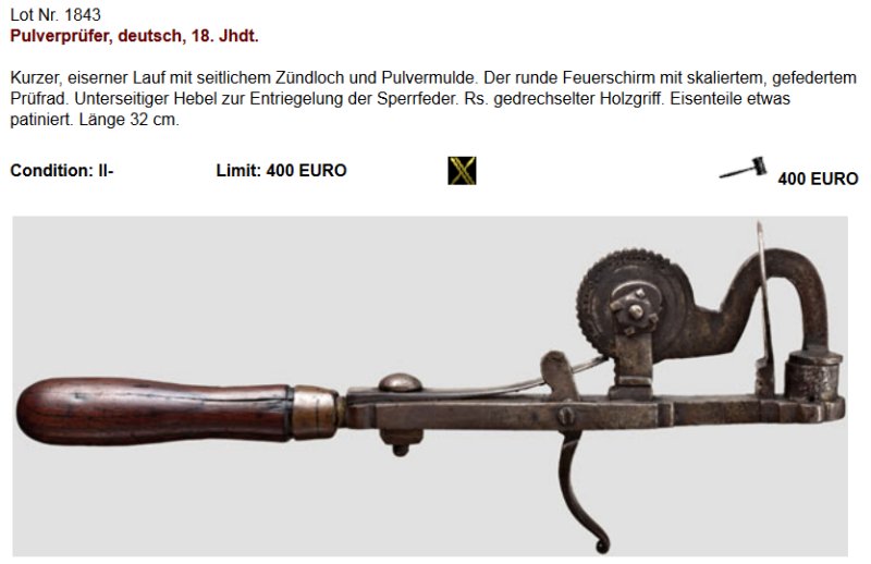

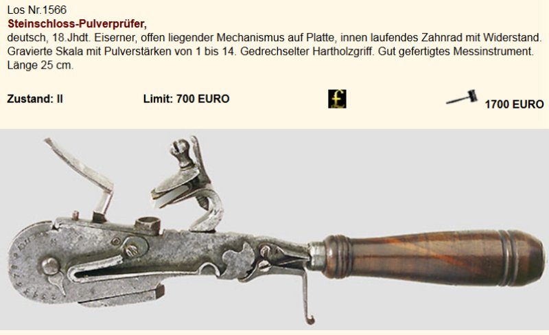

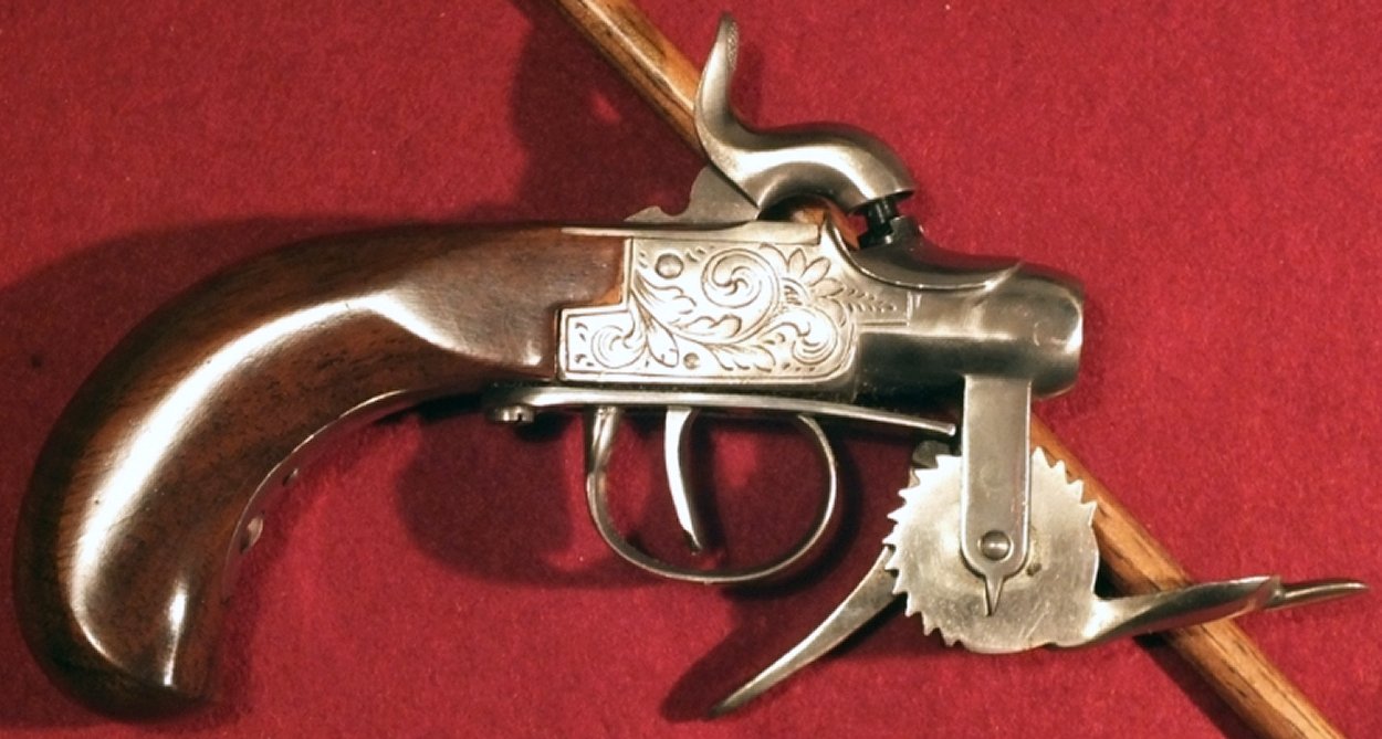

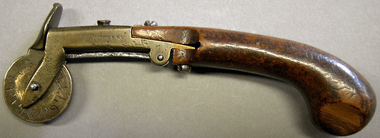

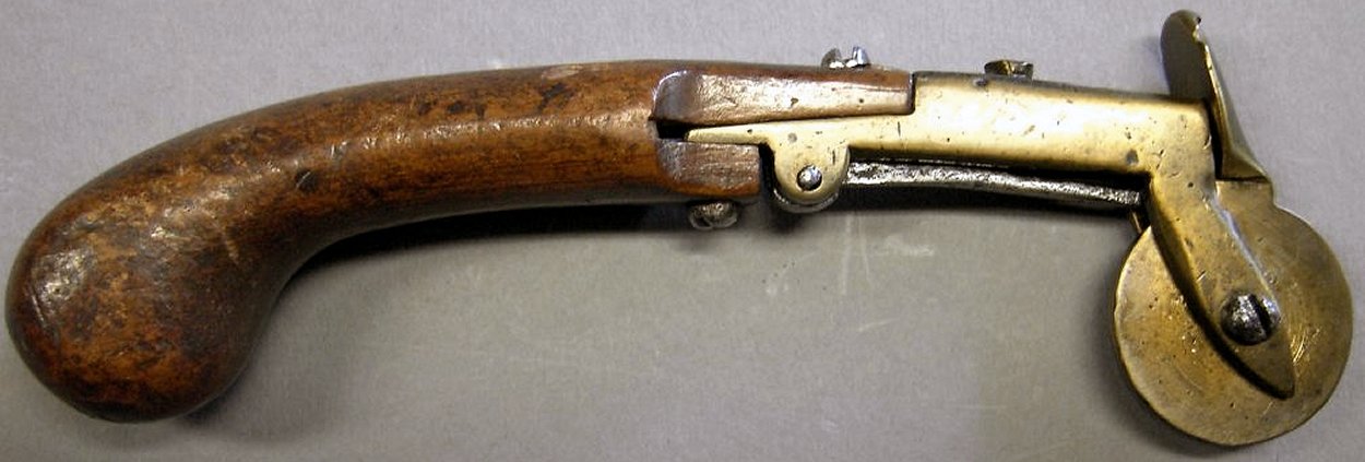

I tried to find similair examples on the web.. acording to the authors on these web pages this kind of powder tester was also in use in the 18th century, but the style differs from Fernando's powder tester and the truthfullness about these claims might be clouded by the sellers "ambition"
I did find a nice website though (pitt rivers museum).
http://web.prm.ox.ac.uk/weapons/inde...359/index.html
http://merzantiques.com/item/very-unusual-powder-tester ( http://www.icollector.com/17th-centu...ture_i11291595 )
http://www.icollector.com/Early-powd...rule_i11291691

And as requested:

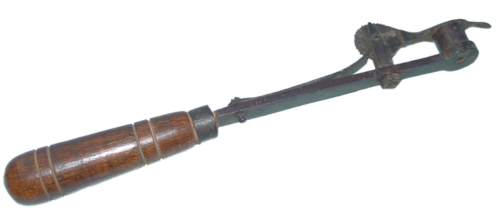

"This device for testing gunpowder was made in Avignon, France and dates to the 17th or early 18th century.
The amount of powder charge needed to pour down the muzzle of a gun depended on the strength of the powder, as well as the barrel length and bullet size. Testers tended to use the same mechanisms as the guns of the day, so this example with a nicely turned-wood handle and iron ratchet wheel, probably dates to the wheel-lock era. Samples of powder were ignited in the touch-hole and forced the wheel to rotate by means of a spring. Originally the wheel would have been marked with graduations from which the strength of the powder could be calculated."
"In the shape of some sort of mythological peacock/serpent standing on four feet. Bird's head on one end and a turned wood grip on the other. Very nice item marked "H K C". Graduated wheel is marked from 0-25. Very decorative piece. Well made and in excellent condition with a nice aged brass patina coloration."

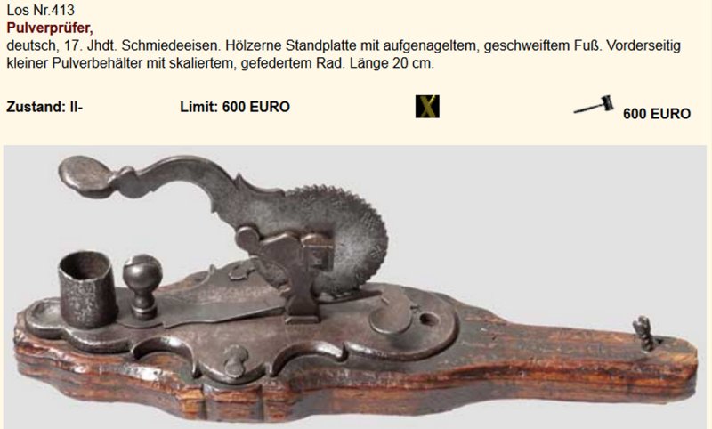

The auction discription:
"17th century style cast-brass body powder tester with turned wood grip of 20th century manufacture, signed by Coulter “HKC / 12-67”. Measures 13” from end to end. Made with a high degree of quality and precision andshows good aging. Keith Coulter was an excellent craftsman and he did work only for his own purposes, not for resale or forgery. From the Keith Coulter collection"
"Early powder tester circa 1700 – 1750. 10-1/4” overall, 4-1/2” turned wood grip with brass ferrule connected to a straight steel platform with graduated wheel showing hand-engraved numbers and tension spring.With touch hole cover. Very good condition, normal aging, small chip to the grip. Similar to example pictured in Eprouvettes by Kempers, page 92. From the Keith Coulter collection"

I profoundly disagree with the early dates obviously assigned by dealers to the objects; to me they are all 1st half to mid-19th c.

Very good and fast input, Marcus. Thank you for bringing in 'non pistol' style examples .
Certainly PittRivers and the 'ambitious' seller of the other example are claiming wrong dating.
... and the sexy 17th "style" four legged one might even be a 20th century replica ... or contemporary imagination .
I wonder if both PittRivers and the Commercial site are making some confusion with the touchole issue ... or is it me ? One thing is the little 'hole' in the base where you submit the ignition and the other thing is the 'deposit' where you fill the powder to be tested ... sorry the funny lexicon. It seems as they are calling touchole the late part.
Obviously i might be wrong; my knowledge is very superficial. Correct me if i am wrong .

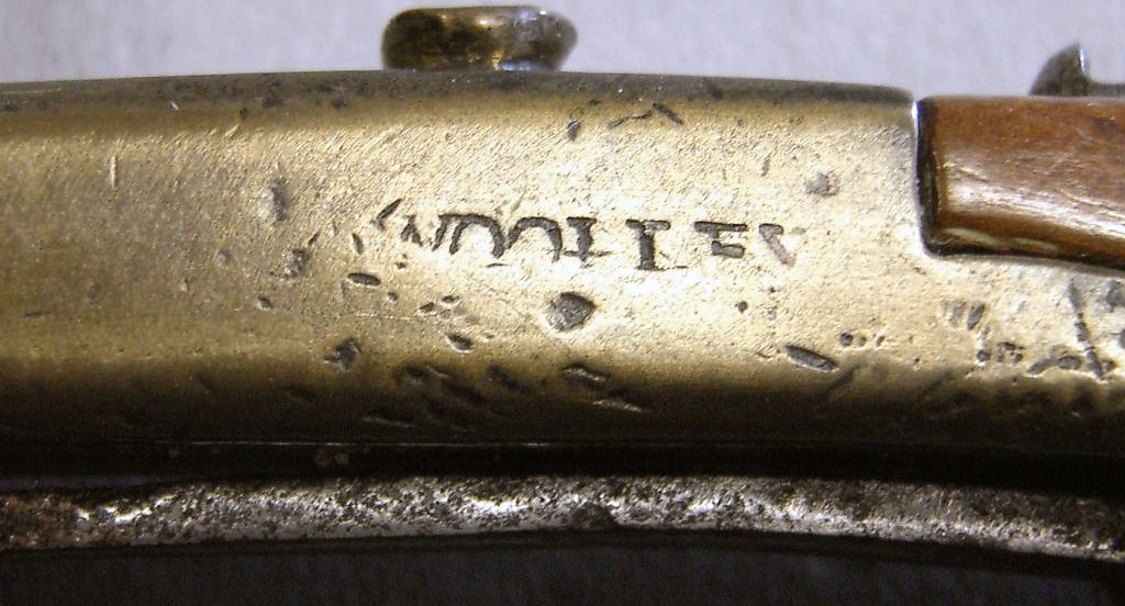

The bronze 4 legged one and the third one from post #7 where both made by the collector Keith Coulter, who according to the auction website who sold these items before, made these powder testers for his own collection and not for fraudulent purposes. Thus these are modern replicas, most likely using multiple styles? (confusing )
Here are the pictures from the touch hole side, notice the second powder tester of this post. It has a spring next to the powder 'deposit', i wonder what this might do.

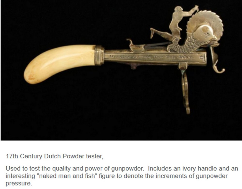

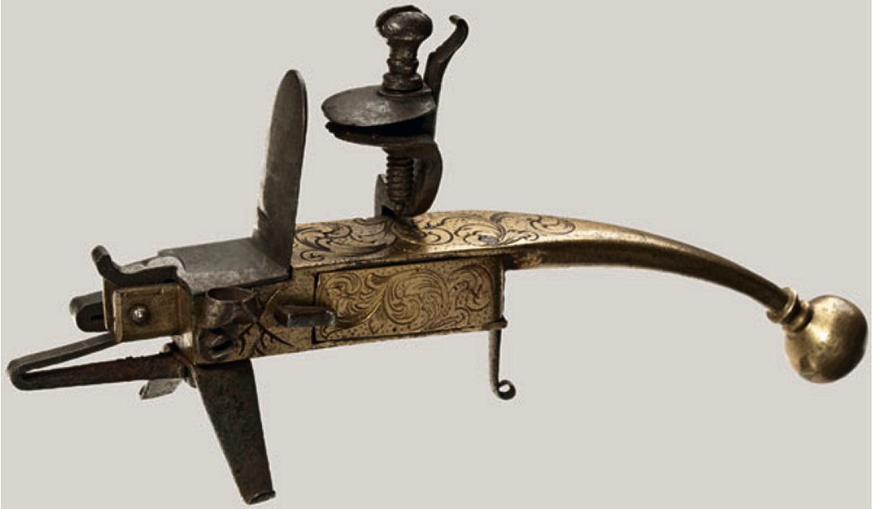

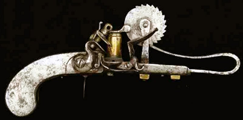

With these on our site we have, I guess, a full spectrum of powder testers, starting with an early instance of the second half of the 17th c. (top attachments), featuring an English model signed by Woolley, ca. 1780 (made of brass), and including a modern copy (the one on the percussion system).
m

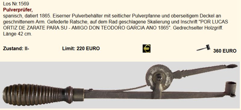

Two more, the one on top Spanish, dated 1865.

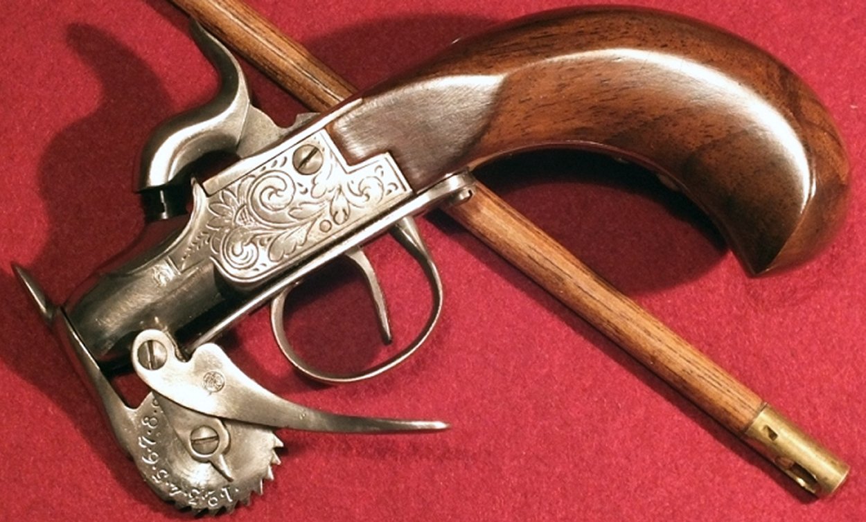

A Dutch model with ivory grip, 2nd half 17th c., a mid-18th c. specimen and two of late 18th c. date, the second employing a Spanish miquelet lock mechanism.
m

If you read the description, it says "with touchole cover". Perhaps that is a sort of dust cover ... or for avoiding the priming powder to fall off (?). The spring is there to secure the cover ... and maybe to turn aside to open.

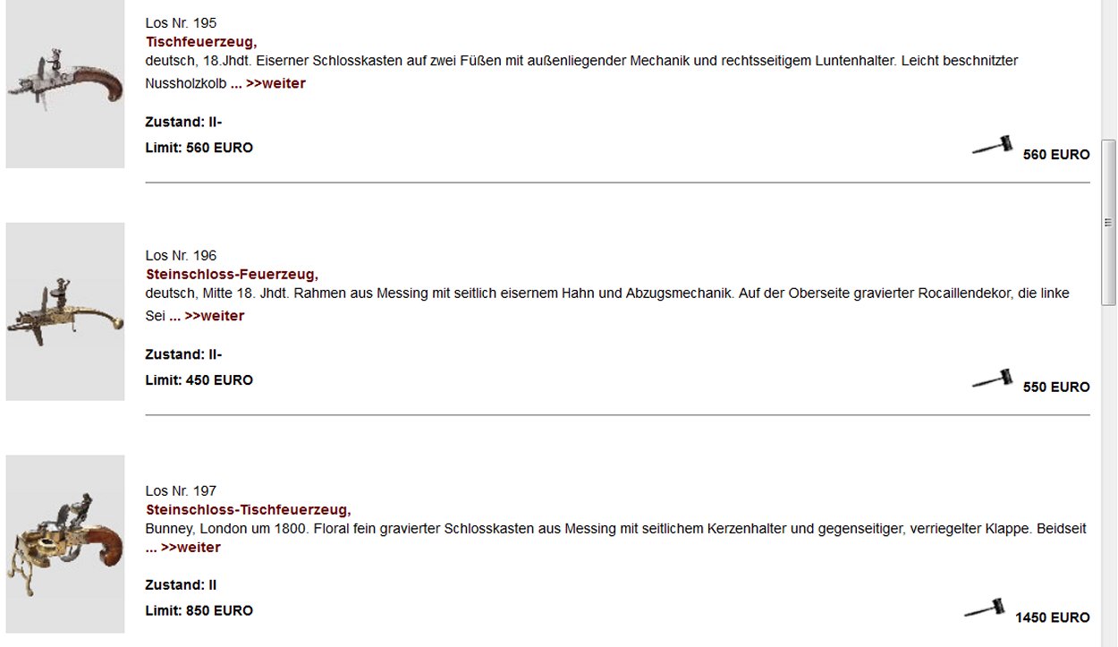

Say Michl, how long ago has this auction taken place ?

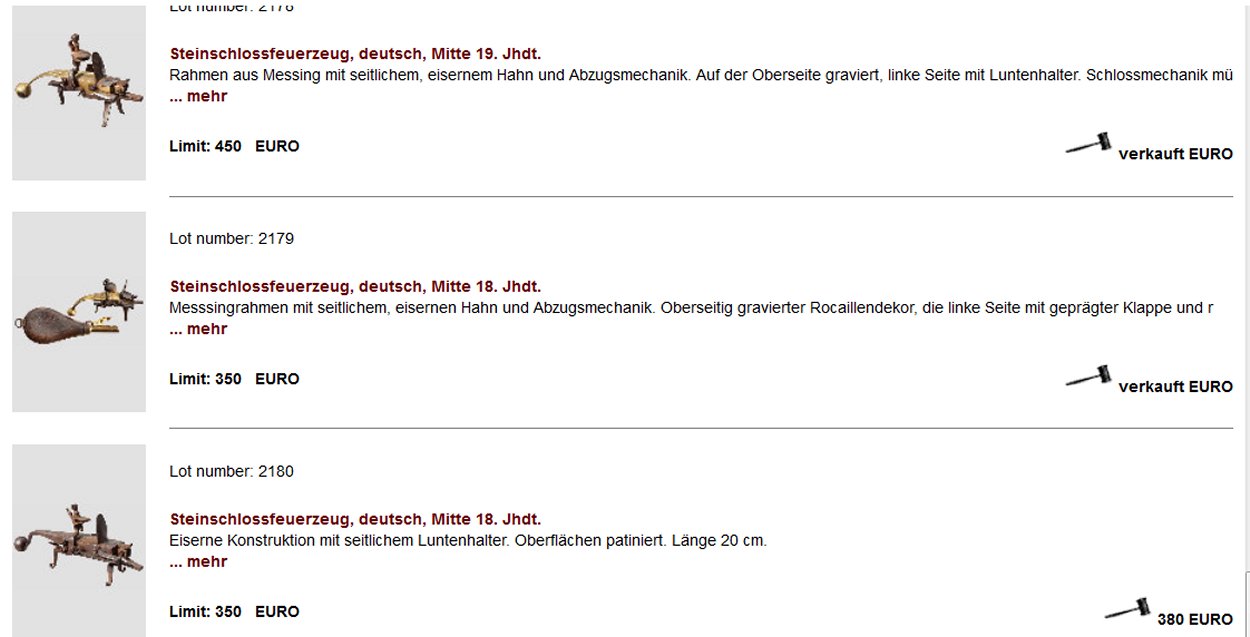

I am trying to figure out whether my example, just acquired, cost me a good or a bad price.
Old 28th February 2014, 07:37 PM   #20
Matchlock
Matchlock's Avatar
Join Date: Sep 2008
Posts: 4,310
Of course, Sir Nando,
Right at your command and service:

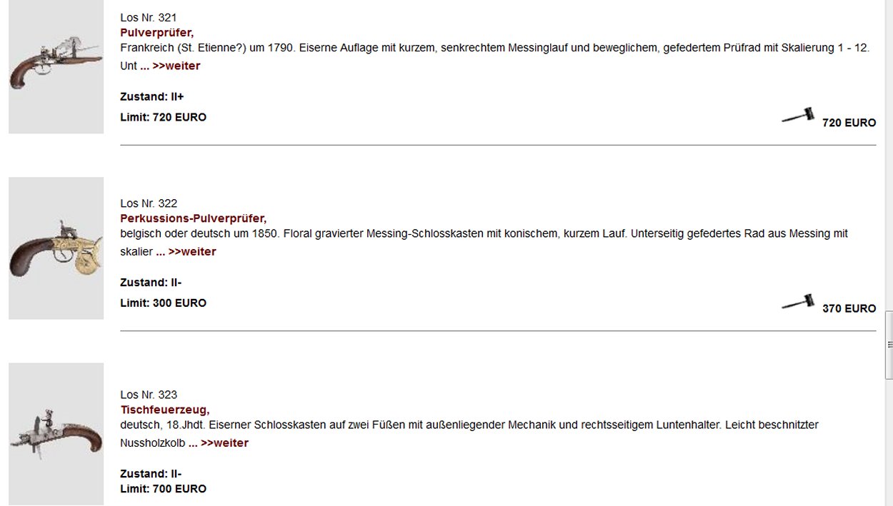

here are the hammer prices (plus 23 per cent commission for the buyer, minus 23 per cent for the consigner) of Hermann Historica's Munich back till 2012 (descending). As they prove, prices greatly vary.
Please forgive me for not finding exactly the items posted before as I picked them up from the web at random.
Michl

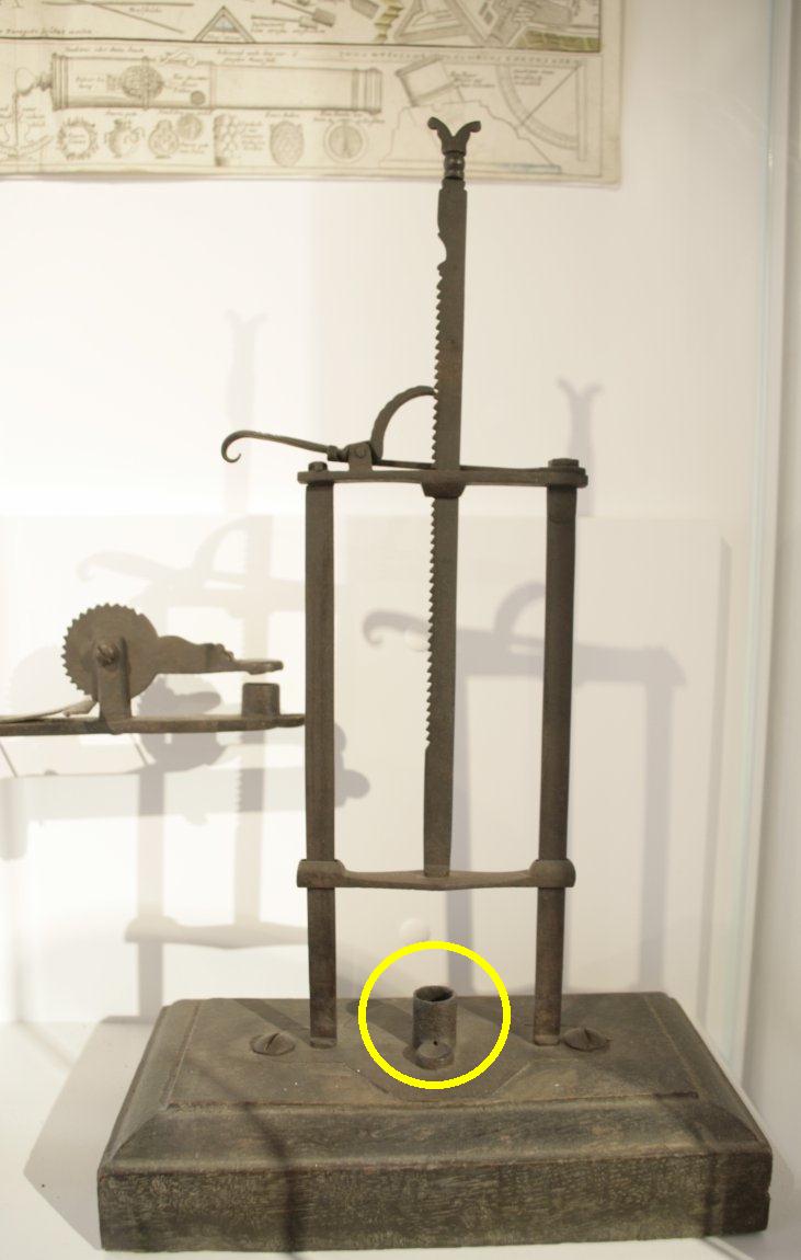

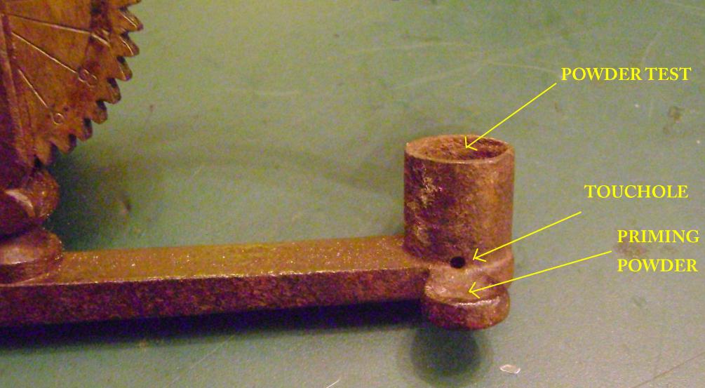

Hi Nando,
Not being in the least familiar with these objects, I have been wondering ever since you asked this question in post #9.
I guess you must be right: the small external trough marked by you must have been an igniting pan for priming powder, probably lit by a glowing pinewood chip always kept ready in any average home (German: Kienspan). This then lead to the explosion of the testing powder.
m

... I guess you must be right: the small external trough marked by you must have been an igniting pan for priming powder, probably lit by a glowing pinewood chip ...
Sure thing Michl,
... Reason why i found this primitive system example more appealing that the mostly seen ones operated by 'mechanical' striking.

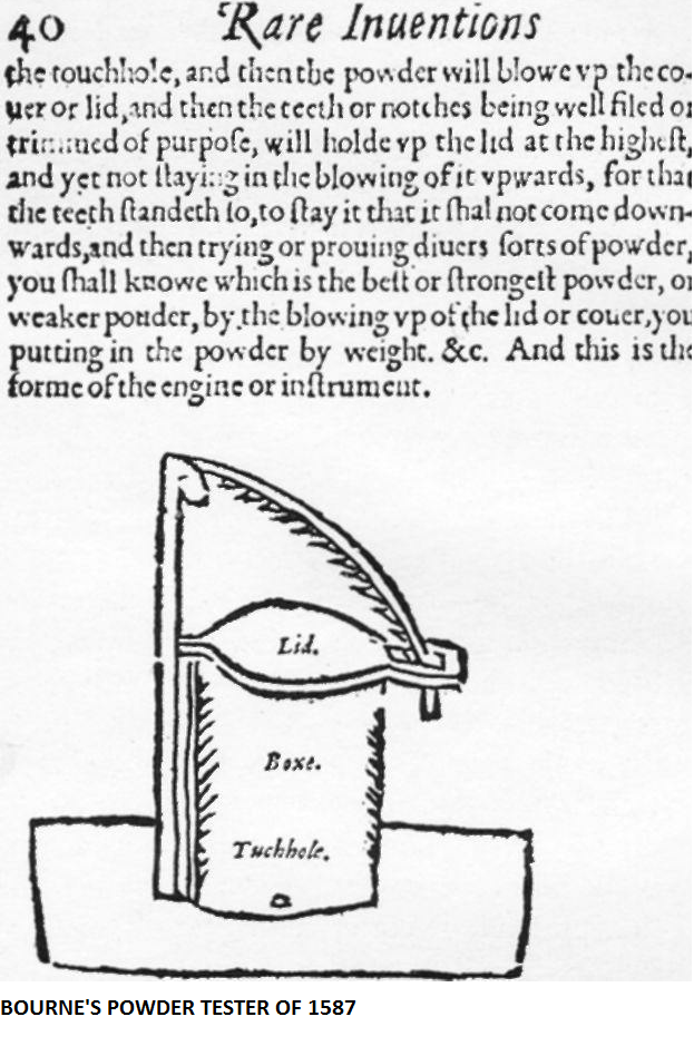

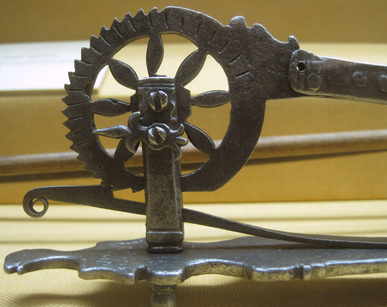

Let me then widen the spectrum ... back to the dawn of powder testing.
Images drawn for a rather interesting article written by Dr. H. G. Muller:
http://www.reenactor.ru/ARH/PDF/Muller_H._G.pdf
I am trying to find the author's email address, to query him on my example but, so far, had no result. Anyone has an idea how to get it ?

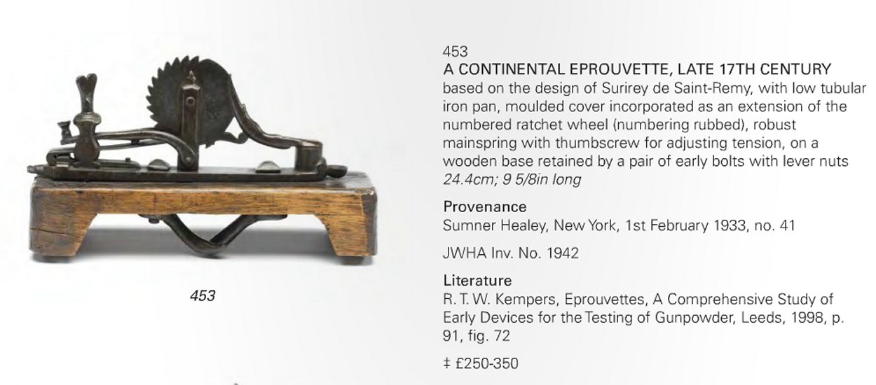

Some more samples of powder testers, all four 2nd half to late 17th c.
m

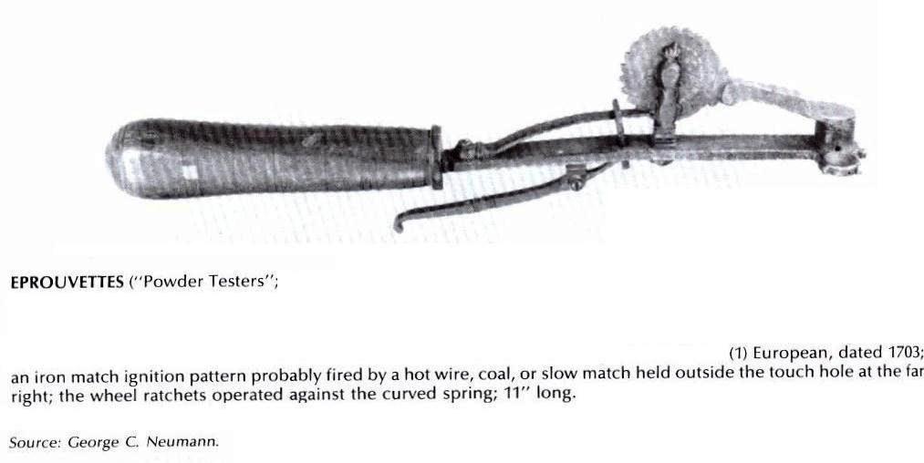

Scanning and selecting an example shown in page 166 of Collector's Illustrated Encyclopedia of the American Revoliution, by George Neumann & frank J. Kravic.
Recalling the 'early' origins of this type of tester plus an interesting description of the ignition system.

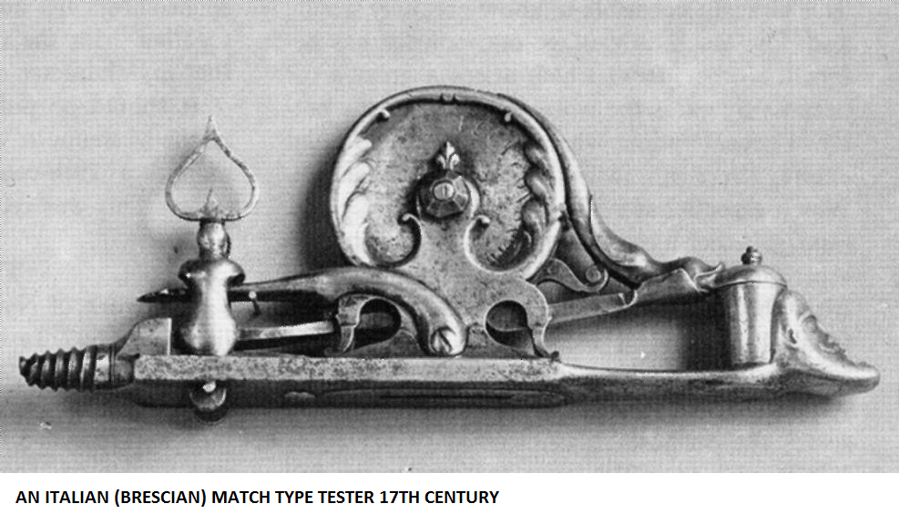

I have received comments from Spanish collector, author and documentalist of the former Montjuic Museum of Barcelona, Mr. Juan Luis Calvó, in which he concurs that my example is Spanish, apparently earlier than 1800.
He also sent me a picture of the (only) example in his collection, attributedly Spanish, in which we can see a strong resemblance with mine.
