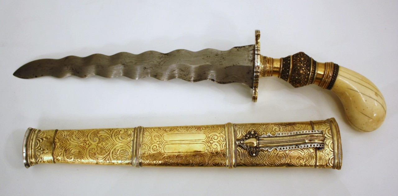

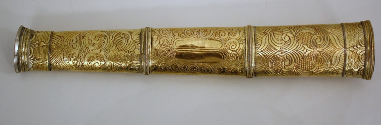

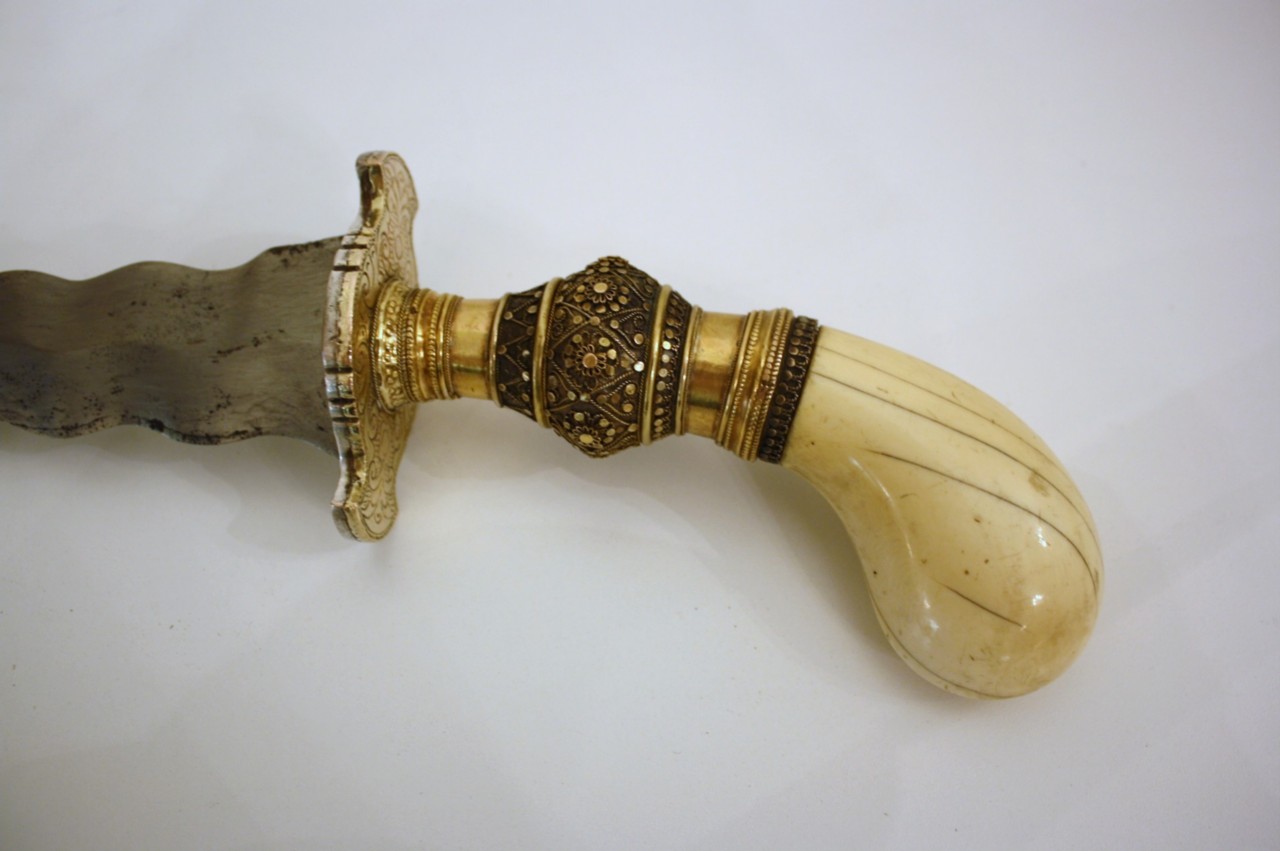

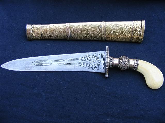

This was directed to me through Lee and i am curious what the thoughts of our gunong-loving friends are. It came with a whopper of a story, which personally i am a bit skeptical of, but maybe we can sort it out. I will share the story soon, but would first like to hear what people thing of this gunong, especially how old you think it might be based upon style and materials. It was described as gold to me, though i am more inclined to believe this is gold-plate and not solid. The pommel does look like ivory to me. The owner has given me permission to post here for your assessments. Whatcha all think about it?

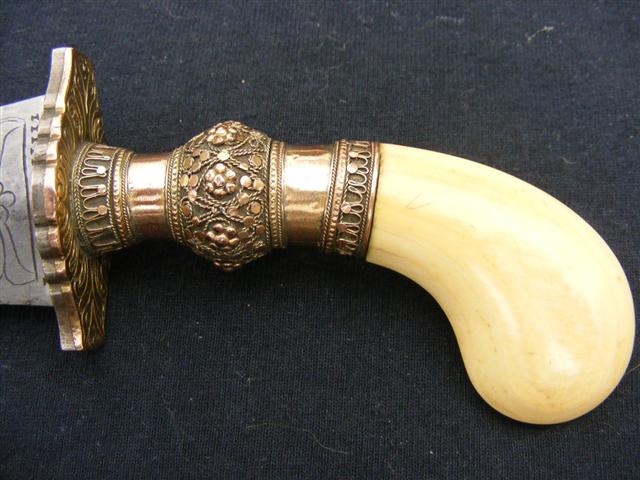

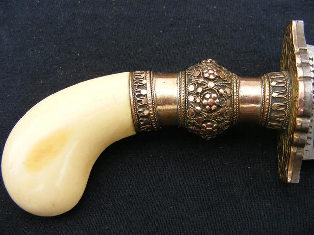

Hullo everybody!
Just thought I'd post these pix. I am led to believe that on this item, the gold has been tested and that the pommel is bone.

DaveS
Join Date: Feb 2006
Posts: 327
David: That pommel is definitely Ivory........Dave

Nice gunong Amuk. Lots of similarities in the fittings stylistically, though yours seems finer. It would be helpful to THIS discussion if you have any provenance of age for your piece. That is probably what i would most like to determine for the gunong i posted.
Old 19th February 2014, 01:03 AM   #5
Posts: 7,363
Dave, although the pommel is ivory, I am seeing evidence that your gunong is gold plated copper. interesting blade. I would say that this could be no earlier than the 1930s.

Posts: 7,363
Amuk, I think that your pommel is also ivory, but having it tested yourself would determine if it is gold plated silver or low grade gold. Your blade is definitely older, so I would place your piece at around the 1920s.

Hullo everybody!
David,
My apologies. I did not wish to murky the waters.
When I first saw your photos, it triggered some memory at the back of my mind. So I searched through my archives until I found the right pictures and posted them. I thought they may be somehow useful.
I have since looked through my archives for notes on the item:
It was presented to me some years ago as a 19thC, 20K-gold and silver Keris Soenda with bone pommel. I doubted the 20K, it looked much lower. 19thC? Perhaps early 20thC. Bone pommel? More like marine ivory. Having said all that, however, I loved the craftsmanship!
Sadly, it's been gathering dust since, as I have not been able to attend to it.
Maybe it's time for me to dust and do some research on it.

No worries Amuk. It's a good comparison piece to the one i've presented.
Here is the story presented to me and perhaps you can see why i am skeptical. This gentleman wants to return this gunong to the Iolani Palace in Hawaii because he believes it was taken from there in 1942 and once belonged to the King of Hawaii, a gift from the king of Burma when King David Kalakaua visited there in 1881. His story is rather detailed, but i suspect someone was telling tales to someone along the way.

To me, and it seems there is some agreement, stylistically this gunong couldn't be any older than early 20th century. AFAIK the hilt style with the nail and filigree work and the more bulbous pommel piece all point to this. I would also question why the King of Burma would gift a Filippino dagger to a King from Hawaii instead of an item from his own culture.

So my bottom line question here is does anyone think this gunong could possibly be as old as 1881? I don't, but i am always open to new information.

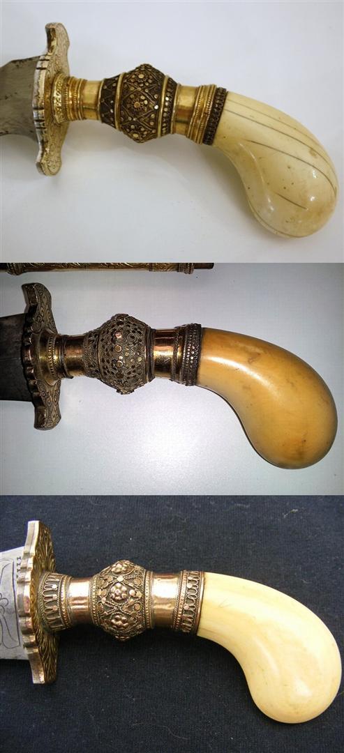

Hello Dave, I am going to have to agree with Jose on the age of both these pieces and say that your example was made in the 1930's. Often stories have a tendency of getting slightly exaggerated especially when a little horse trading is going on. Case in point, when one has a dagger that they are trying to trade for a jeep.
Here is another example of one of these highly decorated gunong's and a comparison photo of all three hilts. Sorry for the poor picture quality of the complete piece.

I DOUBT THIS FANCY FORM GOES BACK AS FAR AS THE 1800'S AND PROBABLY STARTED IN THE MID TO LATER 1900'S . THATS JUST MY OPINION ,BUT THE OLDER ONES I HAVE SEEN WERE PLAIN COMPARED TO THESE EXAMPLES. MY UNDERSTANDING IS IN OLDER TIMES THIS DAGGER HELD NO PRESTEIGE AND WAS OFTEN WORN AS A CONCELED WEAPON OFTEN ILLEGALLY. WHEN DID THESE BECOME A FASHON ITEM WORN TO BE SHOWN AND IN LARGER SIZES. THE GOLD ONES I HAVE PERSONALLY HANDLED APPEARED TO BE GOLD PLATED WHICH IS A TECKNIQUE I DON'T BELEAVE TO HAVE BEEN COMMON IN THE PHILIPPINES IN EARLIER TIMES.
THE PATINA ON THE IVORY IS ANOTHER CLUE WHEN IVORY IS HANDLED AND GETS THE OIL AND GRIME ON IT, IT TURNS ORANGE ANYTHING CARRIED AND WORN SINCE THE 1800'S WOULD SURELY HAVE A DARKER ORANGE PATINA. NOT CONCLUSIVE BUT MY 2 CENTS WORTH. I DO LIKE THESE THOUGH AS THEY ARE PRETTY SHARP LOOKING.

Thank you gentlemen, for your frank assessment. As previously stated, it was exactly what i expected to hear, but hopeful the numerous in concert opinions on the age approximate age of this piece will satisfy the owner that the story he was told of it's origins was embellished at someplace in the chain of the telling.
