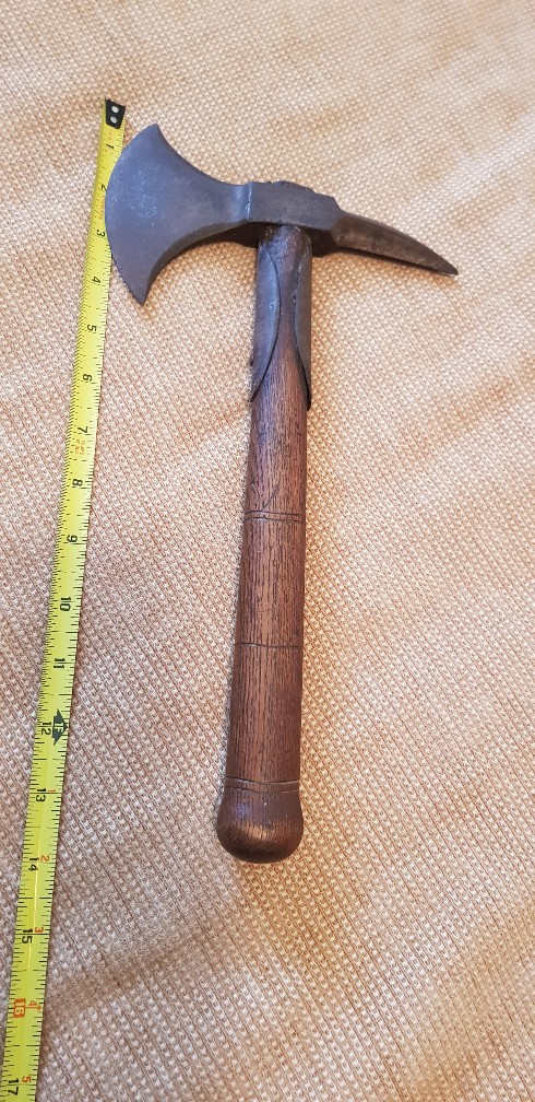

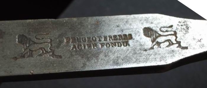

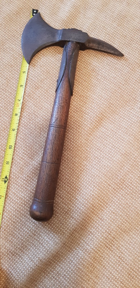

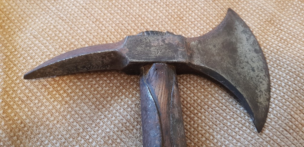

I just adquired this little axe, similar like boarding axes I have seen.

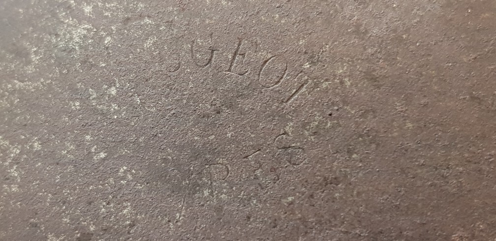

There are a mark in blade, maybe Peugeot freres, but I haven, t information.
Any Information about this piece ?
Thanks

Hi carlos,
Nice axe. I have seen several of these and I believe that it is a late 19th or early 20th century French fireman's hatchet but it is a direct descendant of the French boarding axe and closely copies it.
Its small size make it unlikely to be a boarding axe as it is maybe 300mm long with a blade to spike point of perhaps 185mm. Even the smaller models of French boarding axes were more like 530mm by 230mm.
Peugeot freres have a long history of tool manufacture and go back at least to 1850.
I have seen one of these marked with the Free French cross indicating it was still in use in WWII.
Regards,CC

CC, while not a collector nor having knowledge in this field, I just wanted to thank you for the detailed info and insight into this interesting axe. I wondered if it could be a firemans axe, and it is great to learn from the example shared and observations, so very much appreciated.

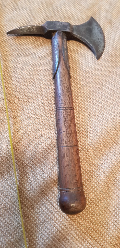

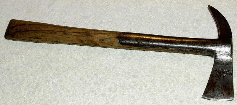

I have one of the fire axes too. As noted, the boarding axe had a longer haft, it also had a belt hook on the side of the head to keep it secure on your belt. The Boarding axe usually had a similarly grooved grip area, missing from yours as required by the French blueprints I've seen. Nice little axes. French ones had the languets fore/aft to protect against missing and breaking the handle. British axes had them on the sides, like the UK boarding axes which had them there to prevent the head being cut off That evolved into the fire version where that was not really necessary.
Mine is in pic below too), it's also slightly smaller/lighter than the French one.

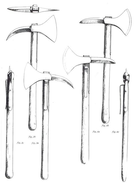

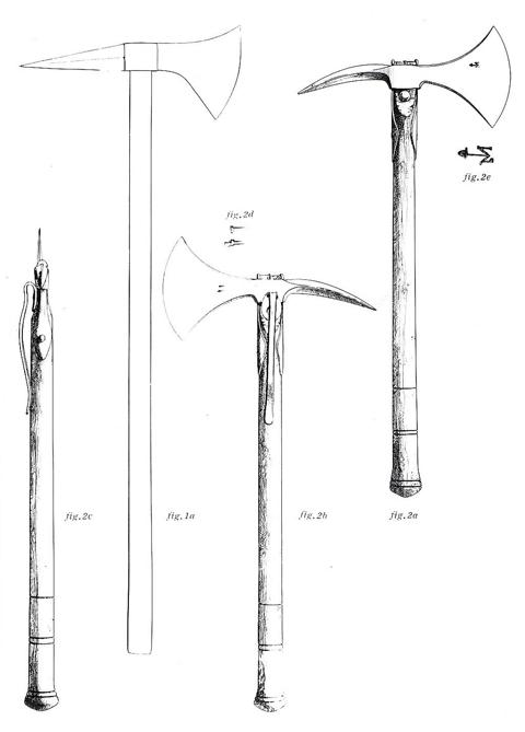

Fot those who are able to read and understand a second language here copies of the opus of Christian Aries concerning French bording axes
corrado26

apparently the pages od Aries are not of interest, so please excuse me having tried to help, I shall not do it once more again!
corrado26
corrado26
Please don't think that Corrado - all information and help is always appreciated. There are just not that many people interested in boarding axes!
Aries documents are not that easy to find and although dating from the late 1960's early 70's they are still mostly accurate - so it is a good post.
I also have an English translation if anyone is interested.
CC
Old 13th May 2019, 12:13 PM   #9
I appreciate the drawings too. French is not one of my languages, unless I can scan it in and paste it in Google translate , so I did not comment further. Again, Vielen Danke. Do not feel slighted.
CC, An English translation would be most helpful and also appreciated.

Posts: 672
Hello
only to say that the upper word ends in G E O T and the lower word in R E S (Freres?)
Affectionately
Old 14th May 2019, 11:28 AM   #18
Hello
Affectionately

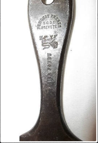

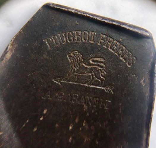

Yes, PEUGEOT FRERES, as seen by Carlos. Although, i guess, a peculiar situation in that, usually this mark has a deeper stamping and is shown next to a symbol (lion ...).

The lion is the firm logo of the PEUGEOT S.A. still today
corrado26
Old 14th May 2019, 05:49 PM   #20
I am aware of that, Udo
... The one and the other are THE SAME
