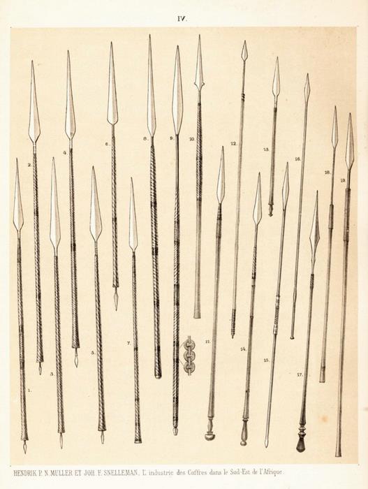

See image below; Pictured are many fine Shona spears being from an extract of the very rare 1890's publication by Muller, Hendrik P.N. & Joh. F. Snelleman, "Industrie des Cafres du sud-est de l' Afrique".
Gavin
