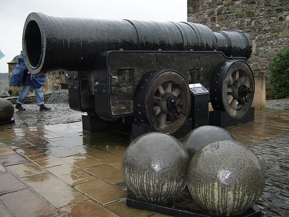

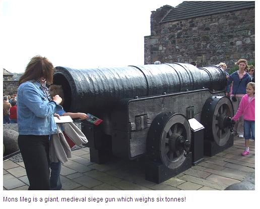

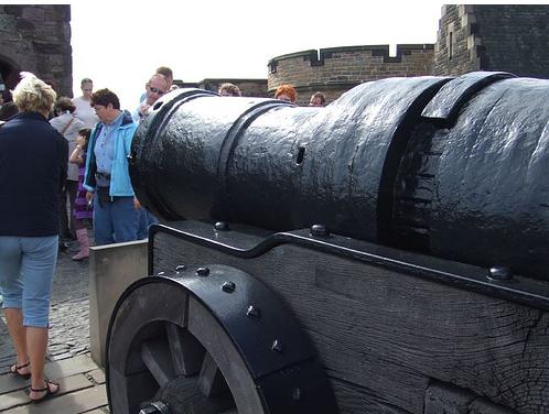

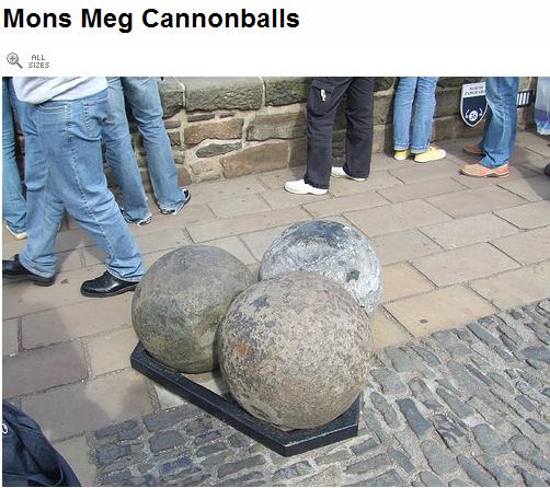

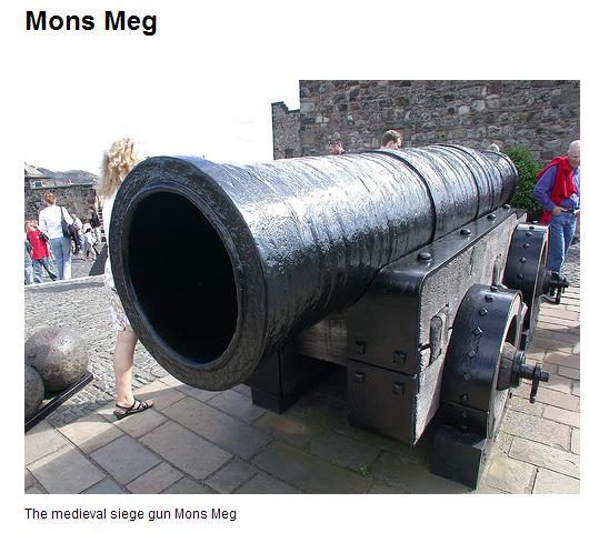

The only barrels I can imagine to have been exceptions to the rule were the early wrought iron Stabringgeschütze ('bar and ring guns') made from longitudinal iron bars and secured by rings, like the famous Mons Meg. I give a quotation from Wikipedia and attach a few images:
The bombard was manufactured from longitudinal bars of iron, hooped with rings fused into one mass.[1] The Duke's artillery maker Jehan Cambier constructed it, and it was successfully tested at Mons, Hainaut, Wallonia, in June 1449; however, the Duke did not take delivery of the Mons Meg until 1453. Desiring to "interfere in British affairs"[citation needed], the Duke decided to help the Scots against the English. Mons Meg weighs 15,366 pounds (6,970 kg), is 15 feet (4.6 m) in length, and has a calibre of 20 inches (510 mm). The final cost of the gun was £1,536. 2s.
A conflicting theory, based on limited evidence, suggests it was constructed in order to aid James II in the 1452 siege of Threave Castle in the Stewartry of Kirkcudbright, when the Clan MacLellan used it to batter the castle.
The 20-inch (510 mm) calibre cannon accepted balls that weighed about 400 pounds (180 kg), although it could only be fired 8-10 times a day due to the tremendous heat generated by the powder charge required. It has been suggested that Meg was one of the armaments on James IV's
carrack, the Great Michael, which would make it the ship with the largest calibre gun in history.[citation needed] From the 1540s Meg was retired from active service and was fired only on ceremonial occasions from Edinburgh Castle, from where shot could be found up to two miles distant.[citation needed]
The gun was last fired in 1680 to celebrate the arrival of James Duke of Albany and York, later King James II of England and VII of Scotland, when the barrel burst. An English cannoneer had loaded the charge and many Scots believed that the damage was done on purpose out of jealousy, because the English had no cannon as big as this. The incident was also seen as a bad omen for future King.[2]

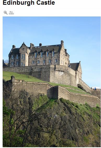

The cannon was left outside Foog's Gate at Edinburgh Castle. It was next taken, with other disused ordnance, to the Tower of London in 1754, but was returned to the Castle in 1829, after the intervention of Sir Walter Scott. Following a restoration, it now sits outside St. Margaret's Chapel.
"Mons Meg was a large old-fashioned piece of ordnance, a great favourite with the Scottish common people; she was fabricated at Mons, in Flanders, in the reign of James IV. or V. of Scotland. This gun figures frequently in the public accounts of the time, where we find charges for grease, to grease Meg’s mouth withal (to increase, as every schoolboy knows, the loudness of the report), ribands to deck her carriage, and pipes to play before her when she was brought from the Castle to accompany the Scottish army on any distant expedition. After the Union, there was much popular apprehension that the Regalia of Scotland, and the subordinate Palladium, Mons Meg, would be carried to England to complete the odious surrender of national independence. The Regalia, sequestered from the sight of the public, were generally supposed to have been abstracted in this manner. As for Mons Meg, she remained in the Castle of Edinburgh, till, by order of the Board of Ordnance, she was actually removed to Woolwich about 1757. The Regalia, by his Majesty’s special command, have been brought forth from their place of concealment in 1818, and exposed to the view of the people, by whom they must be looked upon with deep associations; and, in this very winter of 1828–9, Mons Meg has been restored to the country, where that, which in every other place or situation was a mere mass of rusty iron, becomes once more a curious monument of antiquity" Notes to Rob Roy, Sir Walter Scott.
The gun is never called "Mons Meg" in any contemporary references until the 17th century. The "Meg" may either be a reference to Margaret of Denmark, Queen of James III of Scotland, or simply an alliteration, while Mons was one of the locations where the cannon was originally tested.
Besides the Mons Meg, a number of 15th century European superguns are known to have been employed primarily in siege warfare, including the wrought-iron Pumhart von Steyr and Dulle Griet as well as the cast-bronze Faule Mette, Faule Grete and Grose Bochse.
I also think that drilling and other abrasive methods were essential with cast barrels, both iron and copper alloy ('bronze' or 'brass'). I know, however, of quite a few 15th century wrought iron barrels, both in museums and in my collection, which were obviously never drilled out and show a very irregular inner surface and muzzle. Of course, they could have never been used for caliber matching balls.

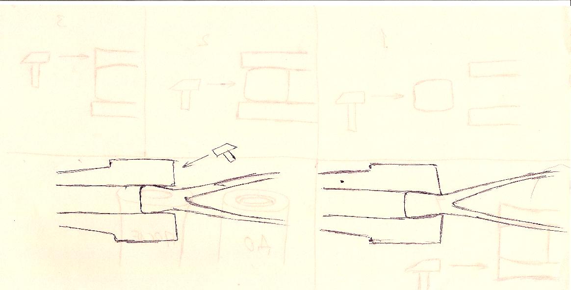

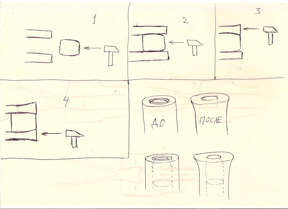

I assume that the plug could be fasten in such a way without welding. It is only the my assumption but not a fact
Spiridonov is offline   Reply With Quote
Old 6th July 2010, 08:11 PM   #10
Matchlock
Matchlock's Avatar
Join Date: Sep 2008
Posts: 4,310
Exactly, Alexander,
Of course the plug was driven into the barrel when red hot.
MIchael

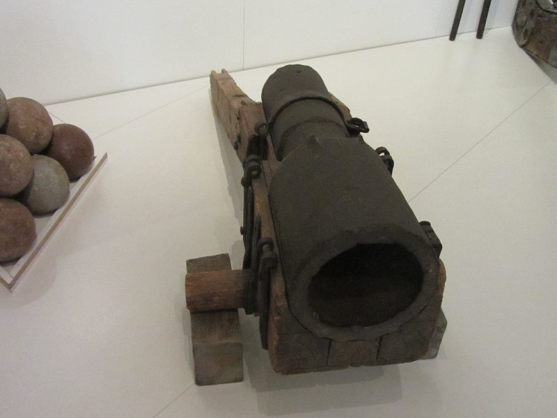

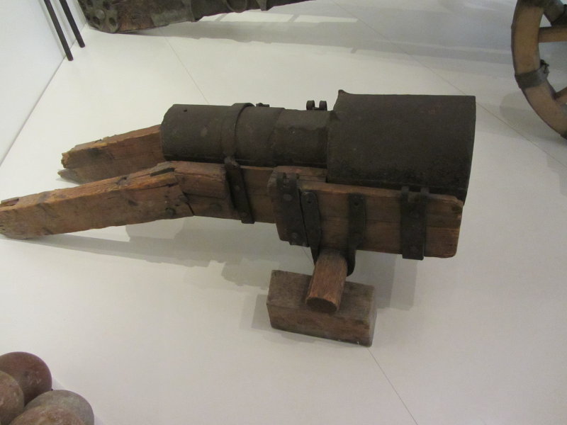

A good friend has made this photos at Veste Oberhaus Museum in Passau, in Bavaria South Germany. This little stone bombard or mortar (Steinbüchse / Mörser) was casted from iron. It is dated around 1400. The museum describes this piece as the oldes known example for a iron casted cannon.
In case the dating "ca 1400" is correct this piece would really be an unique object.

Exactly, Alexander,
MIchael
Barrel bright orange-white hot and plug cold so as to cause a shrink fit over the plug and allow for forging the barrel.
I would like to have seen them forging these massive iron bits....hard enough to stand next to 28 pounds of welding hot steel (my damascus billets now) let alone some hundreds of pounds.
I plan on making a small cannon next year....I am gearing up the shop with tooling to do so. Should anyone have a reading list for me I'd be happy to read more on the subject. X-rays especially helpful.
