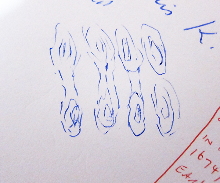

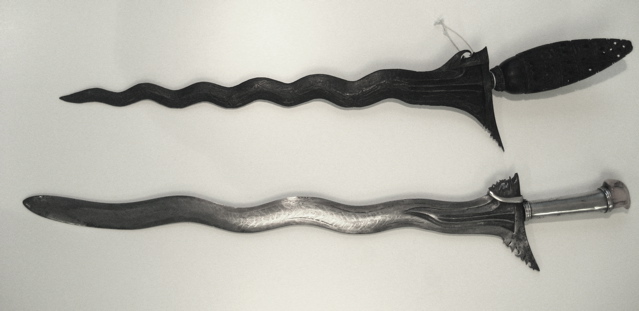

Alan, Kai, there are well known examples of Keris with Pamor Puntiran (twistcore), which are surely made before 1700. If this pamor wasn't popular in Central Java before 1800 (yet I think, the picture in Yogyakarta is another one then in Surakarta), it most probably has the reason, the technique of Pamor Puntiran is not coming from Central Java or Java at all.
So it would be wrong to conclude, Pamor Puntiran appeared on Krisses on Philippines only after they became popular in Central Java.
Old 20th June 2013, 10:51 AM   #25
Posts: 7,015
Gustav, as you know, last year I looked at and photographed a number of very early keris held in several European museums.
In some cases I was unable to read the pamor, either because of the poor condition of the surface, or because the surface was polished.
In some cases the pamor was surface manipulated.
In only one keris was the pamor a miring pamor. This was keris EDB.16 held in Copenhagen. This keris probably entered the collection in 1674. My note reads:- "pamor skilfully manipulated, no name"
I am not prepared to say that pamor miring did not exist in Jawa prior 1700, but it was most certainly was not widespread.
I do not now possess, and I have never possessed a genuinely old Javanese keris, that is a keris that I have good reason to believe may date from before 1700, with a complex pamor miring. I cannot recall ever having seen such a keris.
It is most probable that the skills to produce complex pattern welds were brought to Jawa by Muslim metal workers. These people settled on the North Coast and in parts of East Jawa, rather than in the hinterland. In my opinion the skills used by the people of the Southern Philippines to produce complex pattern welds were brought to the Southern Philippines by Muslim metal workers, just as they were brought to Jawa by Muslim metal workers.
However, the metal workers who took the skills to the Philippines were very probably descendants of the original craftsmen who came from outside Maritime SE Asia. The craftsmen who spread the skills through Maritime S.E. Asia very probably came from the North Coast of Jawa and Madura.
Whenever I have shown photos of the blade of my Brunei keris to knowledgeable Javanese keris authorities they have given the opinion that it is Madura work, and this is also my opinion. Not "Made in Madura", but made by a Madura craftsman, or a craftsman who was trained by a Madura craftsman.
I really do not think that Central Jawa plays a part in this spread of form and technique at all, in my opinion it all came from the North Coast, which followed on from the original trade routes of Majapahit --- which of course were a development of earlier trade routes.
Old 20th June 2013, 11:58 AM   #26
Gustav
Join Date: Jun 2009
Posts: 1,280
According to the dissertation of A. Weihrauch, this keris has twistcore Pamor, 1 rod on one side, 2 welded together on other.
The keris of Sendai with some greater possibility has twistcore Pamor, Miring in any case.

Posts: 7,015
Gustav, I'm not sure if you realise it, but you are saying pretty much exactly the same as I am saying, that is:
Of the examples you list, the Sendai keris has pamor sanak I believe. It was examined by a Javanese gentleman --- Martowikrodo or a similar name --- and he states this in his report. I've read this somewhere, but I forget where. It might be on the net.
The keris in the Rustkammer in Dresden does appear to have a blarak pamor, it may be a Javanese keris, but certainly not a Central Javanese keris, and it is a keris of exceptional quality. Didn't get to photograph this one, but I did spend a very long time looking at it through glass.
KKA Kopek is North Coast origin.
If complex pamor miring was made in Jawa prior to 1700, it was a very rare occurrence, and its manufacture would certainly have been limited to those areas that had substantial populations of Muslim immigrants and their direct descendants. This means the North Coast and parts of East Jawa.
As for EDB.16 in Copenhagen, the surface of this keris was polished and I was only able to pick up the bare outlines of the pamor, these were not sufficiently clear for me photograph the pamor pattern, nor were they sufficiently clear to permit an analysis of the way in which this pamor was constructed. I may have been able to guess at how it was constructed, but I definitely could not see it sufficiently clearly to carry out positive analysis. It would seem that Mr. Weihrauch has some abilities which I lack. It is unfortunate, but I have given undertakings that I will not publish photographs of any of the keris I examined, were I able to do so it would be very easy to see that the presentation of this blade makes it impossible to analyse the pamor construction.
Below is my notebook sketch of the outlines of this pamor.

To my eye, this miring pamor is the style of work I expect to see in later pieces. The techniques and technology required to weld this type of pamor and to achieve this degree of perfection did not develop until relatively recently in the areas of keris production with which I am familiar.
For me the pefection of twistcore Pamor in Moro pieces is almost inexplicable, even more, becouse this is almost the only one Miring pattern we see in Moro blades. Just like they weren't interested in something other.
And exactly this is the thing that lets me think about Turkish Yataghans, where we encounter the same thing. No other technicques, perhaps some exeptional Adeg (like in some rare Moro blades), only twistcore, yet quite perfect.
Actually I posted this article in the thread about Sendai Keris.
I can assure you, the pamor of it seems to be Miring, it could be even twistcore, yet it surely isn't Sanak. I am not allowed to show a picture of it.
