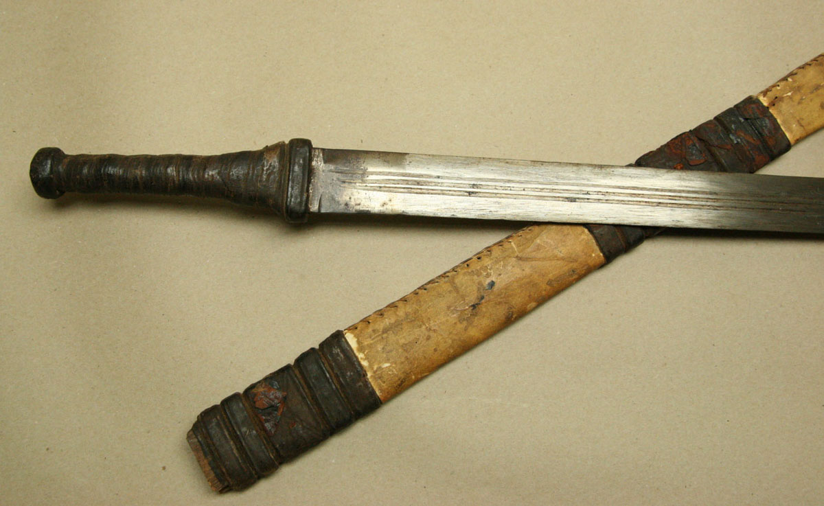

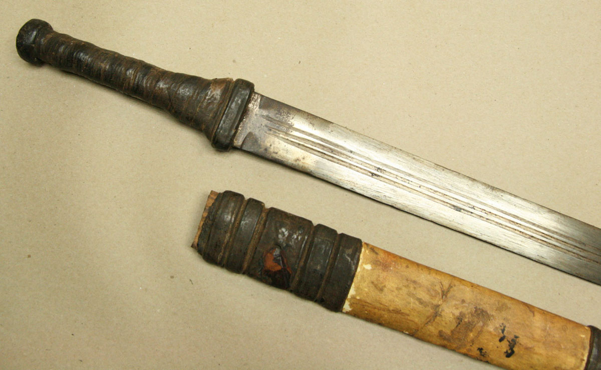

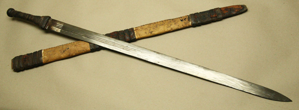

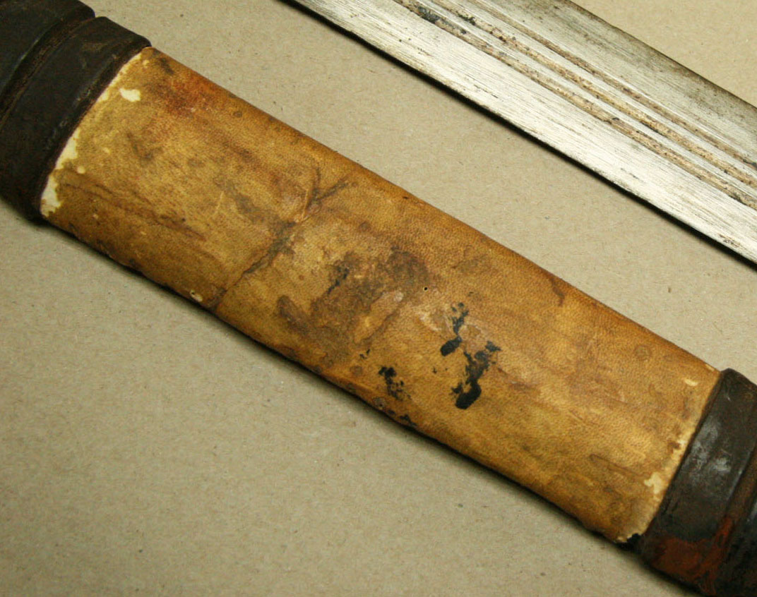

The blade is 84 cm long, 4.5 cm wide. Sword is 98 cm long overall. The scabbard is wood, covered with three sections of tooled leather, and two sections of very fine calf-skin, or similar finely-worked leather, something I haven't seen before. Hilt is completely wrapped in leather and oil-cloth. Blade is somewhat flexible, but not easily bent, and has a nice temper, with no markings of any kind. By the looks of it, I would say it dates to some time in the 1800s.
Looking forward to your opinions, Ibrahim and other Omani swords connoisseurs.

Hi Dmitry,
Not Omani IMHO but likely Manding.
Stu

I agree Leather work and style seems Manding..the blade is the masri style triple central fuller, though no dukari moons.

Wow, I was way off. Just checked, and it's definitely not what I thought it was. Proves you can't really know a little bit about everything.
