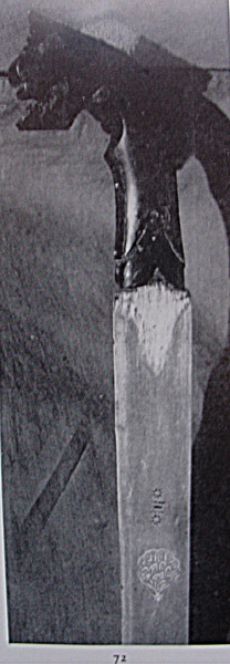

It has been on my mind for quite a while now, that a sword mentioned by Goetz as being a sword belonging to Emperor Akbar and having a Malaysian hilt may not be a Malaysian but an Early Saif prototype hilt.
If the age is correct it is a revelation.
If the cartouche is later than Akbar’s life and not one of ownership but reverence, further study could lead to this hilt being Indo Arabian.
The image of the hilt shown here in post number 11 isn't real clear in detail but is of the form typically seen on the Arabian Saif in the image below.
The blade too is mentioned by BI in post number 15 as being a Sossun Pata.
Picture the hilt with a cross guard of Arabian form in place.

Akbar hilt from the thread mentioned

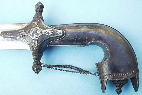

Saif hilt from Artzi's collection.

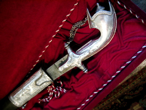

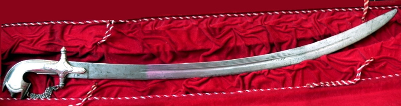

I acquired, there is more than 35 years ago, in the Yemeni souk of Jeddah
an hilt in sterling silver,
exactly same model than the one displayed from Artzi's collection.
on this time the manufacturing art-crafts was still yet in production, I mean, in KSA, at least
these artisans produced this type of article, even with blade and scabbard,
but my personal economy, at this time, didn't allowed me this purchase
since "Gulf war", I listened than most of the Yemeni have being banished from KSA
later, I provided at this hilt, an blade from Afghanistan, and much more later a scabbard
from Damascus, where are, a lot of qualified craftsmen
may be now ... were ...

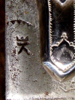

just in case of ... if someone knows, or has an indication about the blade's stamp,
I will be grateful, if he gives me the information, thanks by anticipation

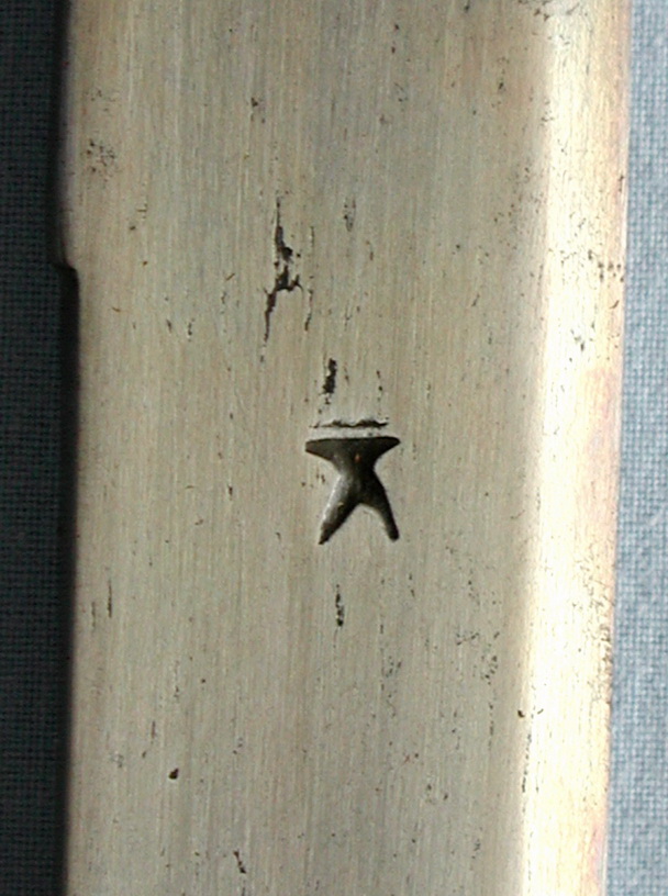

Hi Dom,
I hope I can be the one to help you a little this time .
On this link you can see a mark a bit like it http://www.vikingsword.com/vb/showth...ghlight=Tulwar
I too have a sword with part of the mark - see attached. I believe mine to be Deccani - no not Tipu, 18th century.
All the best
Jens
Ps. My blade is very heavy, not wootz and definately Indian made. I don't, yet, know what the mark means/symbolizes, but hope to 'meet' it in other connections.

Dom,
That is a beautiful sa'if! The blade appears to me to be a European trade blade, especially with block ricasso, and the radiused tip blade known as 'hatchet point' on mid to latter 18th century (into 19th somewhat) cavalry sabres.
The mark is one noted as used by Milanese swordsmiths c.1610 (Wallace Coll., Sir James Mann, A613, rapier). The plural term of course suggests it was likely a guild type mark rather than makers mark. The manner which it is stamped at this particular quadrant of the blade at the ricasso resembles similar area for marks apparantly applied to blades on Moroccan/Algerian sa'ifs (nimcha, as shown in Briggs,1965). It would seem these marks were used by merchants receiving blades in Red Sea entrepots, the use of this mark and an incomplete dentated arc ('sickle mark') is not only contrary to European manner, but incongruent with area of blade applied for such marks applied in European centers.
The interpretative copy of this mark seen on Jens' blade which is as noted distinctly Indian, reveals the spurious use of European marks by Indian makers presumably to characterize 'quality' as perceived on earlier trade blades, but perhaps interpreted into a now lost talismanic or symbolic parlance.
The sword blade design is not 'Indian' but a European trade blade design which influenced blades produced there in some degree, as well as even the Persian trade shamshir blades with the well known 'Assad Adullhah' lion in cartouche. These blades reached even Malaysia, and as seen here, Red Sea trade and Arabian entrepots. Yemeni ports received many forms of trade blades in commerce typically carried out by Omani vessels enroute to the East African coast as well as returning from Zanzibar and Somalia. It would seem that materials from the Indian trade were often of course included in the outbound voyages after entering the route via Oman.
All best regards,
