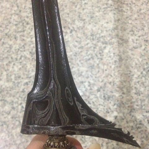

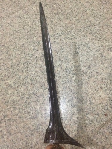

Need your ID about this blade. Can this blade be classified as Surakarta blade? Or probably Yogyakarta? The blade is quite thick but not wide enough as classified as SKA keris. Seems like Mageti style but pesi shape is not what people call as 'sirah gundolo' pesi as a main feature of Mageti blade. I look forward your opinion on this blade.. Thanks in advance.

Hello Karttikeya,
Just my 2 cents to get the ball rolling:
This blade looks more like it was made by a Madurese bladesmith, doesn't it?

The ganja is curved (sebit ron tal), the greneng is a bit odd and the wadidang is unusually flared, it does seem to be not a typical blade from Central Java, may be a recent piece?

Old 27th October 2012, 06:50 AM   #5
Posts: 7,264
OK, here's "anything".
It does not look like either of the two Mageti keris that I have seen.
It has some similarities to the work of Djeno Harumbrodjo, but is less refined.
Might be Djeno's work on a bad day. Might be an intended copy in the style of Djeno. Might be by one of Djeno's relatives.
Doesn't look like Madura or East Jawa work, but anything is possible from that direction.
Is not the work of any Solo maker I can recognise.
Cannot be classified as Surakarta because the rondha is totally, totally wrong, the pawakan is too slim and wimpy, the blumbangan does not appear to be boto adeg.
I agree with Alan's opinion, however the greneng style is different from Djeno's blades which I have seen (see pages 99 & 281 in the book Keris Mahakarya Nusantara for instance). May be from the Malang connection?

Posts: 7,264
Jean, it is obvious that the greneng is not attributable to Djeno, but it is not a greneng that is the "signature" of a maker, it is the ron dha. Throughout history makers have varied the greneng , but it is almost impossible for a maker to vary his ron dha, even if he wants to; he may try to cut it in a slightly different way, but if one is familiar with the work of that maker, it is possible to still have a very good idea who has cut the ron dha, even though it has been altered. It is the ron dha we need to focus on, not the greneng.
The pawakan of Jogja keris are really very different to Solo keris.
The Malang production owes its foundation to Sumenep in Madura. If you consider Malang work you're really considering Sumenep work, one pace removed. I can't see much in this keris that looks like East Jawa, but as I said, anything is possible from that direction.

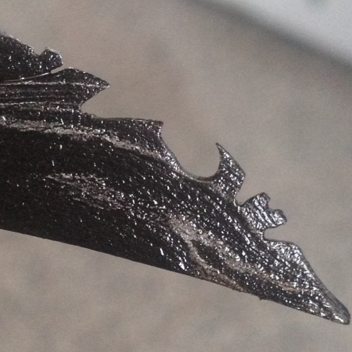

Thank you for your comments, gentlemen. To focus on greneng, I have attached another photo of greneng, hopefully it can help you to identify it furthermore. Greneng seems to form dha but so vague so it will mislead people to say greneng is not pakem. How about tangguh Paku Alam? Could this blade be classified as that tangguh? Any other opinions are welcome..Thank you.

Old 28th October 2012, 10:39 AM   #10
Posts: 7,264
A bit problematical Jean.
How can anybody know , or even guess, if a blade is old, new, recent, or anything else when it is not any type of standard pattern?
This ron dha is ridiculous. Its a slim blade with an elongated wadidang, like recent Jogja keris, but there is no class, and no distinctive tell.
I didn't want to comment on this blade, and only did so because of Rick's urging:- its best to say nothing if you cannot say something nice.
I think I'm finished here, I've already said all I'm prepared to say. When you see a keris like this it makes you realise just how much has been forgotten in the last 500 years.
I'm sorry I couldn't be more kind, Karttikeya. I've seen a lot of ron dha, in fact that is what I was taught to focus on as one of the primary tells, but I've never seen anything like this.
