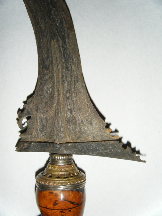

At least that's what the original collectors notes call it (in Dutch).
Blade looks to have been etched and restained many times.
Interesting 'lugs' like a harpoon.
Overall length in scabard 51cm. Blade a fraction under 43cm.
The largest Bugis Keris I've ever had I think.
Help and comments appreciated as always.

It looks like an older Lombok blade in a refurbished (or new) Sulawesi sheath. Buntut is most probably new.
Hilt is an old one.
The somewhat exotic term "Executioneers kris" is mostly applied to panjang type blades.

Hello Gustav,
Could you specify any characteristics which support an origin from Lombok (or Sumbawa), please?
I can see your point but am not fully convinced yet...
I have seen blades with a somewhat similar profile from the Riau archipelago; the greneng may better fit with the suggested eastern origin though.
Same-o with the selut which Detlef attributed to Sumbawa which IMVHO doesn't look close enough to the examples mentioned to ascertain this origin...

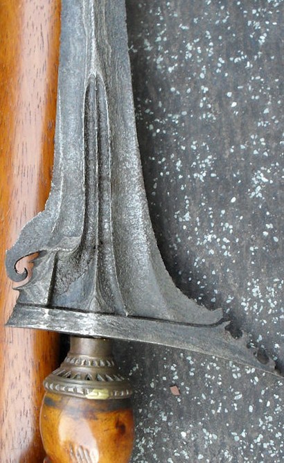

Hello Kai,
have a look to this selut/pendokok.

Yup, similar indeed.
Did you got your example from Hartadi, Detlef?
The innermost ring in Gene's example is indented while it is kinda raised/granulated (more similar to the outermost ring) in Detelef's example. I won't quibble though until we have more of these with sound provenance.

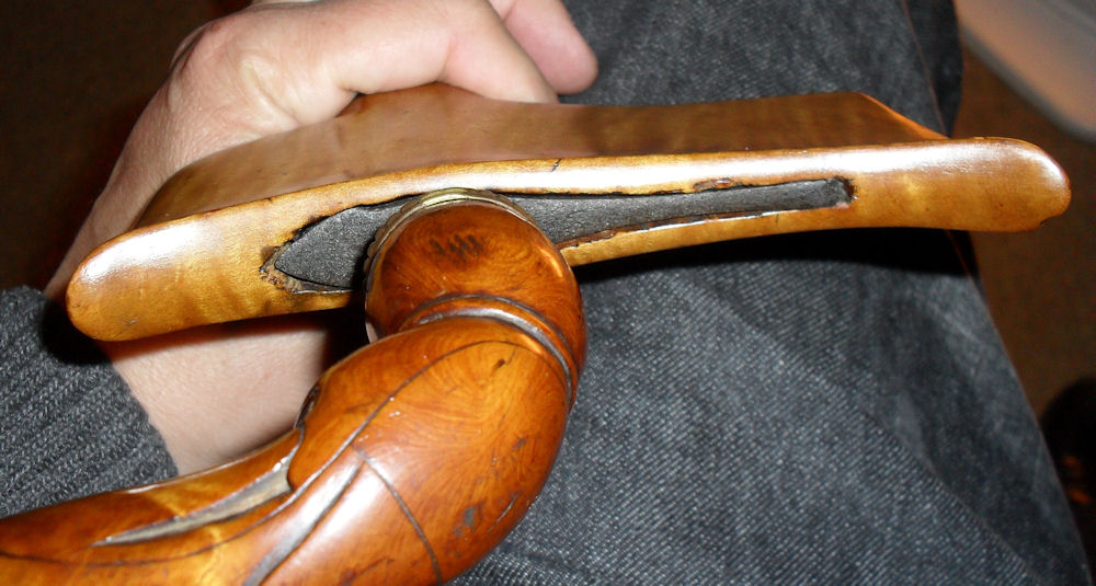

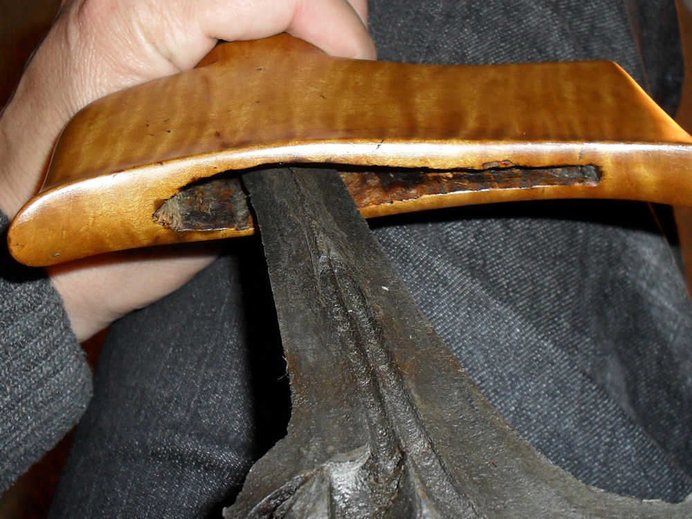

Hi Gene,
very interesting piece. Gustav is correct, the blade have a Lombok touch. Can you provide a picture how the blade fits inside the sheath? Pendokok look like a Sumbawa one. See here: http://www.vikingsword.com/vb/showthread.php?t=11474, look posts 2, 5 & 6. Never have seen a blade like this with harpoon like hooks.
