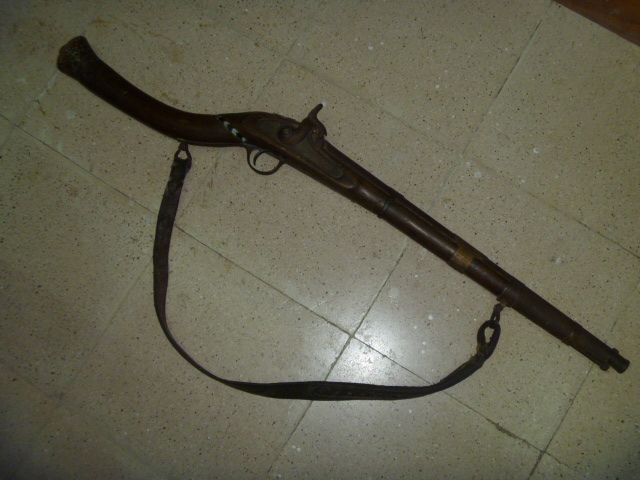

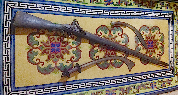

Mindful that weapons from Afghanistan are often less than they are represented to be, I consulted earlier forum posts related to jezails before acquiring this one. I hope I learned enough to choose wisely, but would be grateful for all observations and discussion. In any event, this piece can't be more recently made than the Italian Colt replica revolver I traded for it.

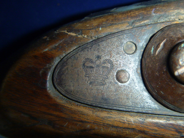

It looks old to me, however, how old is another question!

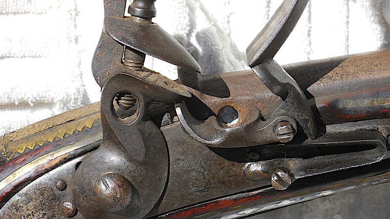

Specifically, this looks to be a real E.I.C. Baker pattern lock, in commission from 1819 to 1839.
Richard

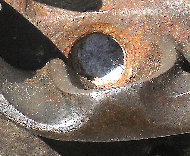

Hi Berkley. I would say that you got the better of the trade. Your Jazail looks to be a good representative example. Looks like the all the decoration is there. The sling is a plus. The Baker pattern lock, original ramrod - it all looks real good. Interesting that the barrel is tapered octagon for it's entire length. Most of the barrels on Jazails I've seen (actually quite a few) have either tapered round barrels, or tapered octagon-to-round. Yours is the first one O recall being full octagon. One thing I noticed: The vent hole in the barrel seems very large and appears to have threads. Is this true? Or is it just the photo? Would be interested to know.
Anyway, great looking piece. Much better than the one I just purchased. Thanks for Posting. Rick.

Lookin' good. Decent barrel and a good lock, brass decoration rather than MOP.

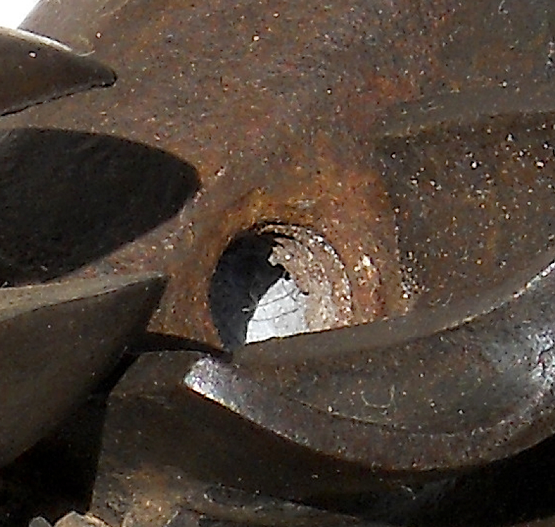

Interesting that the barrel is tapered octagon for it's entire length. Most of the barrels on Jazails I've seen (actually quite a few) have either tapered round barrels, or tapered octagon-to-round. Yours is the first one I recall being full octagon. One thing I noticed: The vent hole in the barrel seems very large and appears to have threads. Is this true?
It is true. One internet source suggests that the use of vent liners in European firearms dates back as far as the seventeenth century. Is it possible that, contrary to usual practice, the barrel is not of local make, but rather another western trophy like the lock?

Hi again. The size of the hole in the barrel looks too large for a vent liner. But it does look to be about the correct size for a percussion drum.
The barrel could have been European made for the local market? Although from the photos it seems more likely it was locally made. The rear sight is the most common style I see on Jezails. Turkish and Persian barrels commonly use this rear sight arrangement.
Maybe you could post a close up photo of that barrel vent area? Is there a smaller hole inside the larger one?
At the momment I'm going to go out on a limb and take a guess: It looks like the barrel at one time was perussion - or converted to percussion - and then re-converted back to flintlock. If true, makes the gun that more interesting. Hope you can get a close up pic of the vent area. Again, thanks for Posting. Rick.
