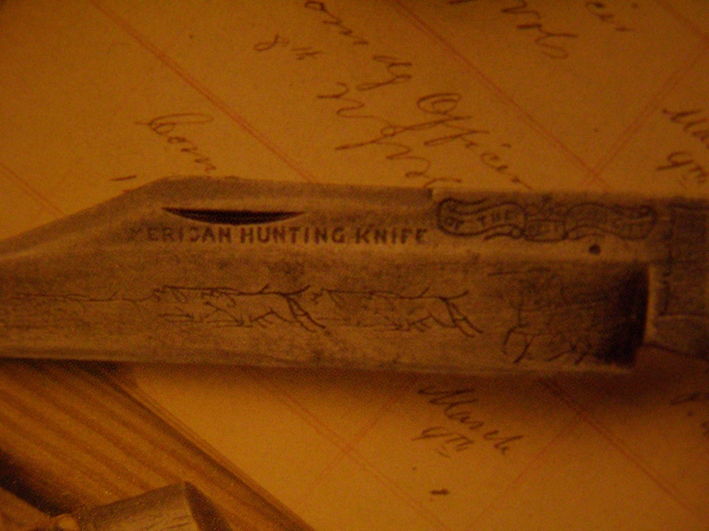

This knife, a 19th-century folder, is significant and relevant to this discussion for two reasons: First, the use of a sans serif font on the reverse of the blade. Second, the knife is made by George Woodhead.
George Woodhead was a Sheffield cutler who opened his shop in partnership with Hartley in 1841. And while he - and later his son - continued to produce knives for the American market through 1884, by 1849 he had bought out his partner and stamped all his knives "G. Woodhead," and from 1876 to 1884, "G. Woodhead & Son."
Fortunately, this progression of ownership and the marks employed during each stage allows us to define the window of time during which a marked example was made.
The ricasso on this knife is stamped, "Woodhead and Hartley," which definitively - and conclusively - dates this early folder to between 1841 and 1849.
Thus, it is self-evident that Sheffield cutlers were using a sans serif font well before the "accepted" time.

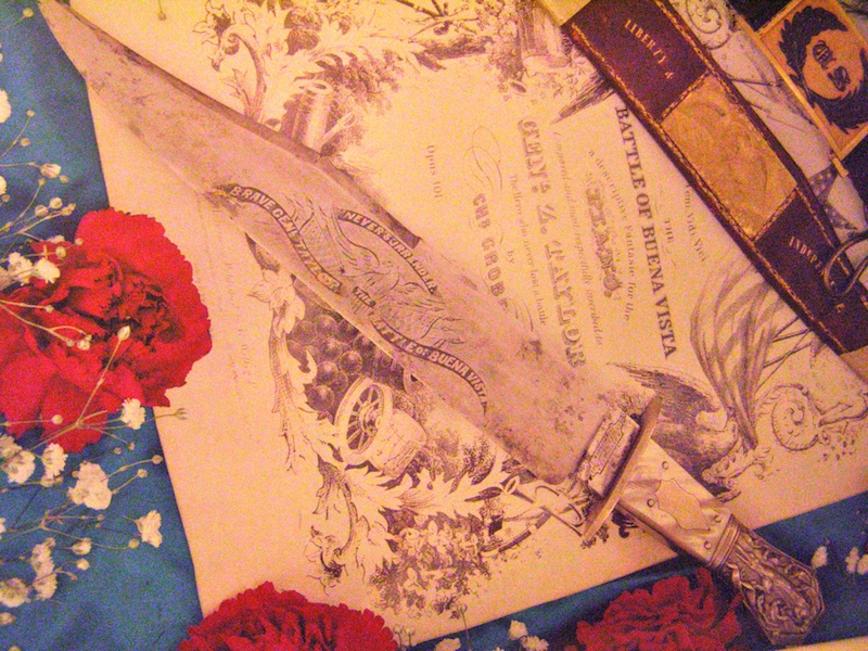

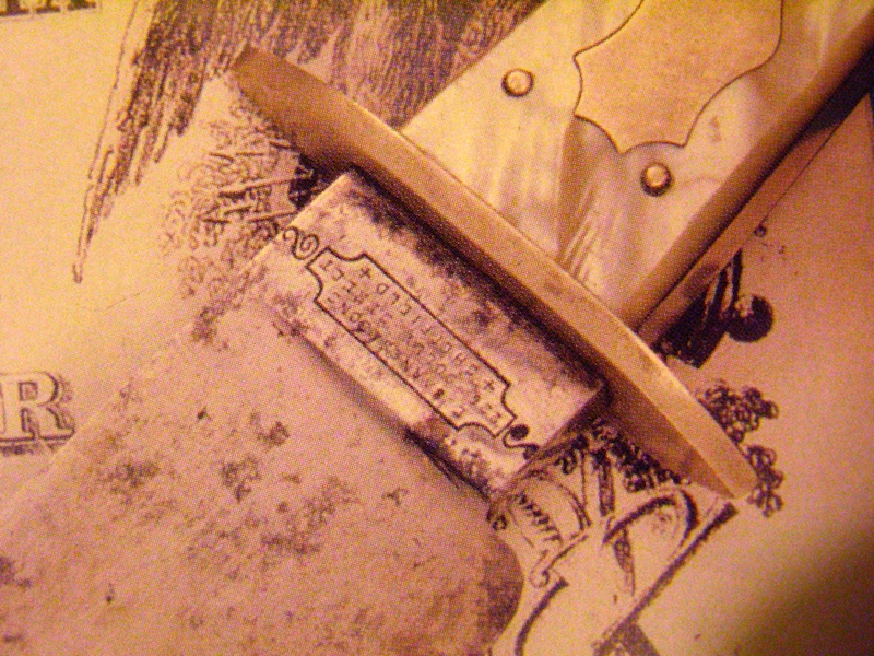

This next example is a knife of fine quality that comes from the same collection as the first, and like the first, was published in the book The Bowie Knife, by Norm Flayderman.
He dates this particular knife to having been made between 1847 and 1849, presumably due to the etching on the reverse, which has an inscription commemorating the (U.S.) victory at the Battle of Buena Vista (by the early 1850s, Mexican-American War-themed inscriptions had been replaced by Gold Rush, abolitionist, and secessionist themes). Made by and marked to Sheffield cutler C. Barnes (relation to Edward Barnes unknown). Not only does the inscription appear in a sans serif font, but the ricasso is stamped with the maker's mark in which the last line "SHEFFIELD" is clearly stamped in a sans serif font as well:
