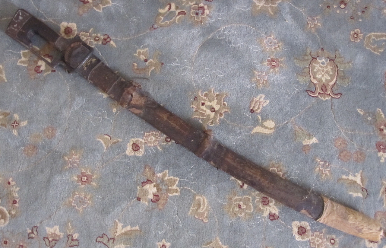

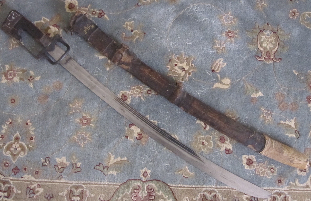

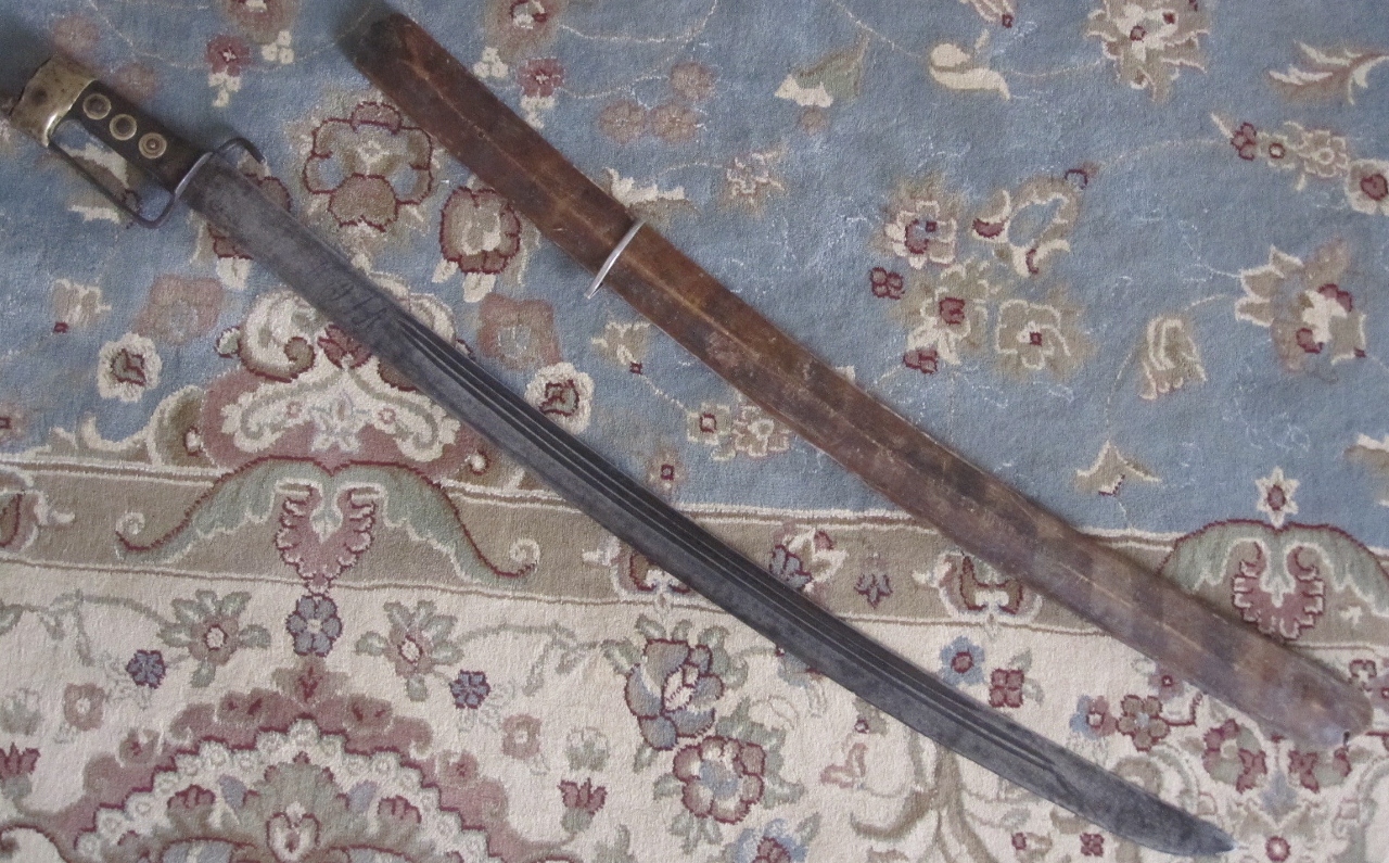

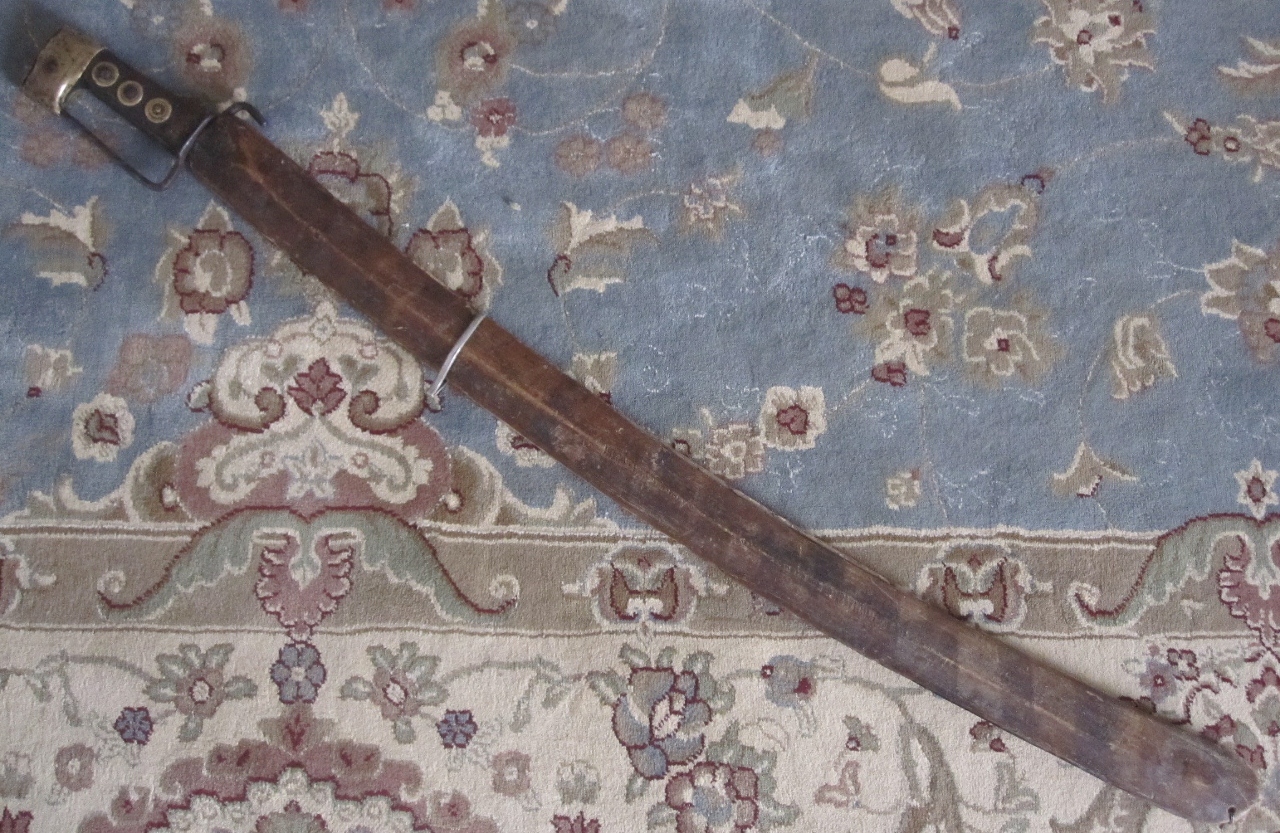

Hello all,
I got this one today, was in a poor condition but cleaned it up. It could benefit from a polish I think.

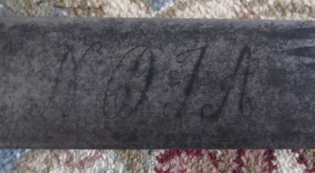

The blade seems to be a European trade blade? There are some latin inscriptions on it. Some other inscriptions exist also but barely show..
The scabbard is beat up but the wood is solid. There are prints of what used to cover it, any idea how it used to look like??

Hi Lofty,
Interesting example which appears to be a sabre of the form which seems commonly held to be used by Bedouin tribes from the Negev into the Sinai Peninsula. As often discussed through the years the 'nimcha' term has been widely misapplied, and typically used by collectors for the Moroccan sabre with distinct guard configuration. From a semantics point of view of course, and as you know, it is easier to use the term in this parlance, I just mentioned it for the benefit of our wide range of non-participating readers, who scan our pages to learn more. As always I look forward to their joining us eventually. I am inclined to favor the descriptive term Bedouin sa'if.
The blade is as you note European and very well could be latter 18th, but probably 19th century, as these heavy sabre blades which entered these spheres via Red Sea trade in the 19th century were reused for often countless generations. The mounts are of course much more recent as evidenced by the screws etc.
The cursive script ligature, or more likely acrostic, is European and used often in acrostic sense to abbreviate a phrase or slogan, even perhaps an acronym for a particular group. I cannot see the letters properly but there seem to be four, so would not be initials.
These swords have a certain rugged charm to them as they reflect the fascinating character of the Bedouin tribes, who often anachronistically used these weapons well into the 20th century. This blade could very well have seen service in the WWI campaigns in these regions, as well as the long history of internecine warfare .
While many collectors might scoff at these rugged old warriors, you are astutely aware the colorful history they hold. Nicely done !

Hi Lotfy,
Lovely sword!
Could the script read 'NOJA' or possibly even 'NOIA' and refer to the places Noja/Noia in Spain?
Just guessing of course.
Best
Gene
P.S. I suggest this because presumably there was much trade between Spain and North Africa?

Gene, There are other letters but they are faded and some barely even show. So cant be sure :-(

Hi my Brot.
I'm backing completely what said Jim,
it's not a "nimcha" even if the general shape for the handle remind a bit ...
it's manifestly, a "Saïf"
about the letters, the form of it, it's called "English form"
the 4 letters could be read as well as : " N D I A" ...
I can not imagine, that what do you suppose being erased,
could might be, ... be an "I"
anyway, I love his rough aspect, a "Saïf for a warrior" not for a court representation ...
and it has his scabbard, that for me I consider as important
MABROUK, and all the best

Shukran shaikh Dom
Is there a way to bring out the faded letters?

Lofty, Im not too sure of the scabbards on these and as far as I know, few survive. I am hoping that Sa'ar will come in on this as his knowledge on these is superb.
All the best,

yes, several ways
- with numeric camera, focus function, then with small computer program , inverse black and white
- with graphic pencil, after have put a paper sheet, pass over, and over ...
the light pressure you will give, will empathize the surface anomalies,
and should reveled what is in hollow
- more ... worst pass over the blade some printing ink, and then with a roll (smooth surface) and a paper sheet, made a ... print
even if it's a solution, I don't advise it, or in extreme solution

Ariel, Thanks. I think the scabbard also has similarity to the scabbards on zanzibari nimchas but thats not conclusive.

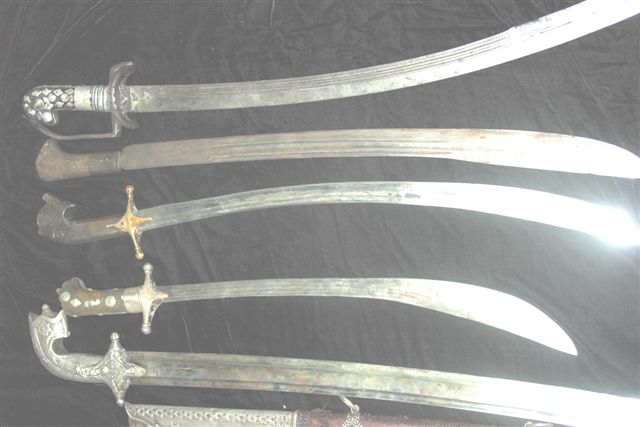

Thanks Richard, I think so.. maybe the Zanzibari saif reached Sinai?

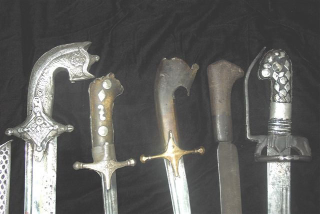

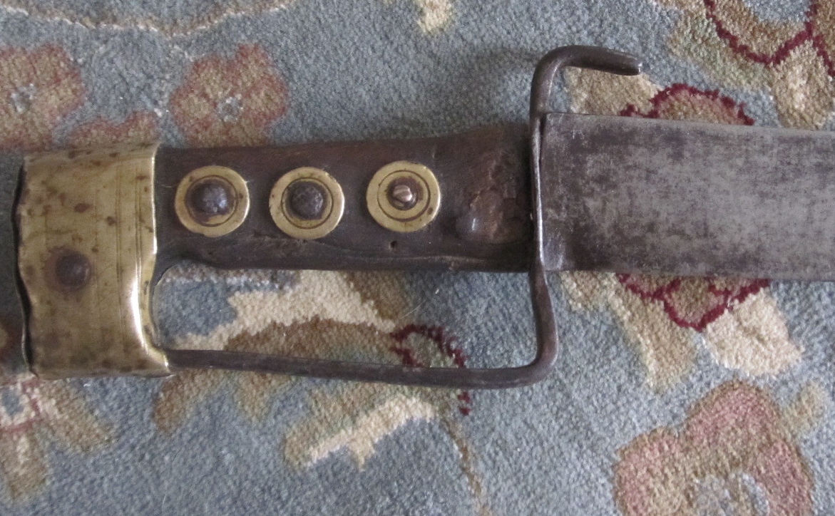

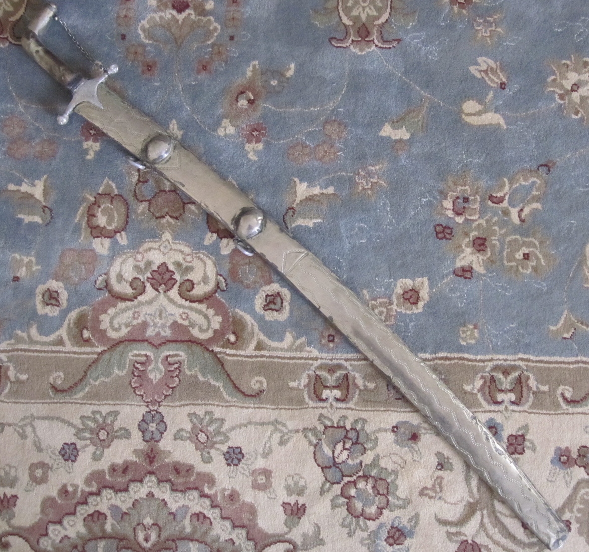

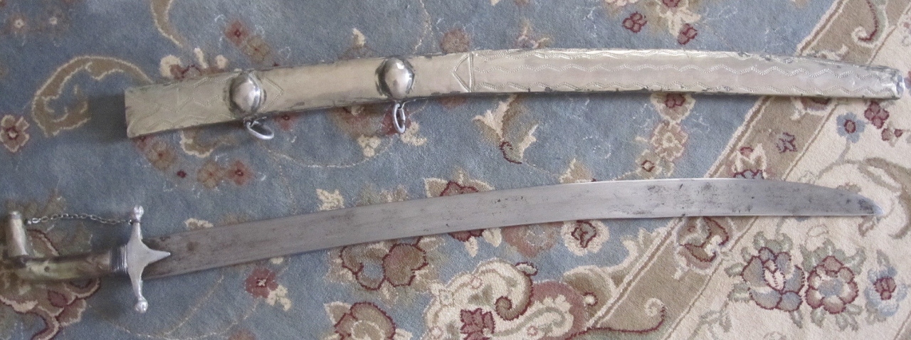

Pictures of one of my Zanzibari saif:
(Also added pictures of my Palastinian Saif.. Or atleast the scabbard decoration is very similar to common Palastinian design)

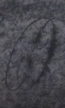

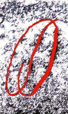

Hi Gene
I know that we have a different reading, it's well to compare several hypotheses
as far as a presentation of arguments come to support an allegation
here the same picture, processed to reveal what is not clear
I think, to read a "D"
friendly yours, all the best
à +
Dom

Ibrahim, reason why I think the badawi saif is Palastinian is the scabbard. But the hilt style is Saudi with minor variations in the silver strap and pommel cap.

I think the sa'if in #12 at top with chainguard is most likely Hadhramauti in accord with Elgood's notes in "Arabian Arms and Armour", which has sa'if with varying hilt forms and silverwork with chainguards. The sharply canted pommel cap seems to concur with other Arabian swords seen in that reference also.
The 'Zanzibari' reference to the second sword (#12) with raised ring crossguard characteristic of these 'nimchas' in popular classification and per Buttin does seem to fall in line with the sword Lofty has posted in comparing the hilt furnishings. I would be inclined to agree that typically the Bedouin or 'Palestinian' sabres do not have knuckleguards, and the hangers and sabres of Yemen do usually have the triple roundels in the grip. But here is the rub in properly identifying these blades which come from the Red Sea trade and have been refurbished through generations.
Zanzibari swords were apparantly highly imported in Yemen from there, the diffusion between Yemeni entrepots and Sinai trade centers would be quite understandable.

Posts: 1,340
The Palastinian saif is shared for comparison with Ariel's kilij (which I hope he shares) and not to suggest that its a nimcha. As for the origin of the blade, I cannot be sure but its probably locally made.

Ibrahim; Yep, Ariel didnt show the kilij but I wanted to show him the saif to see if it have similar decoration to his kilij.

Originally Posted by Martin Lubojacky
Just small entry: - sabers (hilts) from Yemen
Salaams Martin Lubojacky] Excellent pictures of what I have already described as The Yemeni Nimcha. #64 at the thread Oman, Morocco or Zanzibar? on this forum. http://www.vikingsword.com/vb/showth...zanzibar+yemen
Other less well made hilts appear which may well only be "the poor mans copy" of better made hilts you show here...The transition from Zanzibari style pommel and the variation towards cross guard Saudia style and the way in which the hilt transcends toward Karabela form are apparent in your great exhibits.
The difficult part is trying to work in which blades/hilts were imported and which were made e.g. in Hadramaut and what if any input was made by Jewish craftsmen and since much of their work is shrouded in mystery and public denial we may never get to the root of it. Hyderabad more than likely has a hand in a lot of the associated Hadramauti work but once again the outlook is foggy.
Only by comparing and weighing up all the facts and by such excellent information such as your photographs can we hope to guage the clearer picture. This helps bring to life Buttins work (and others) and further expands it...moreover it focusses the discussion on our ongoing, live, forum effort. ~Thank you.
