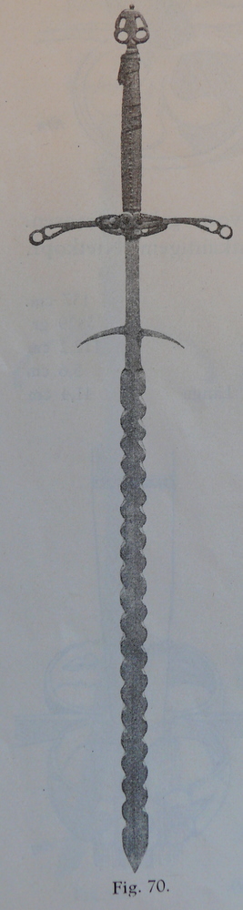

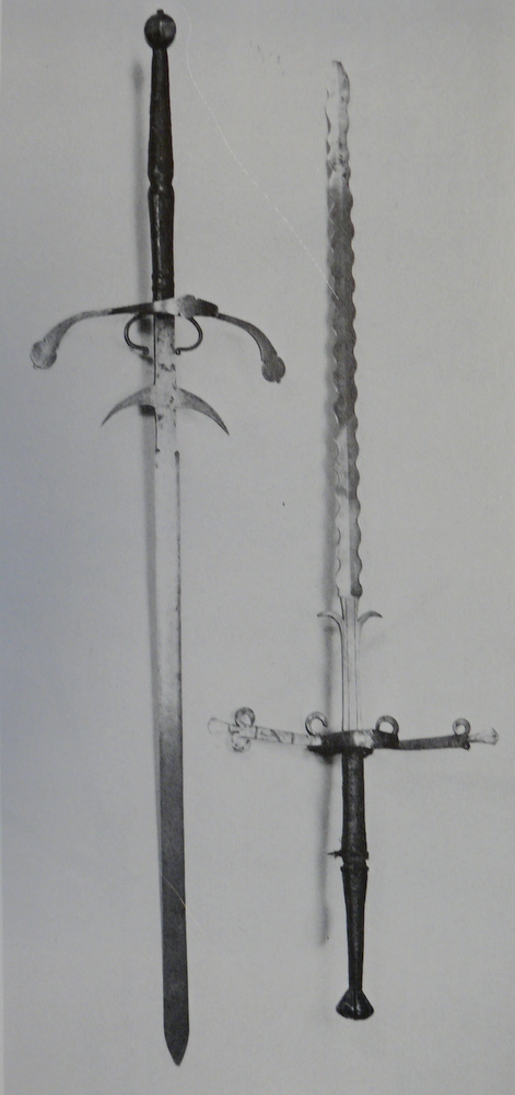

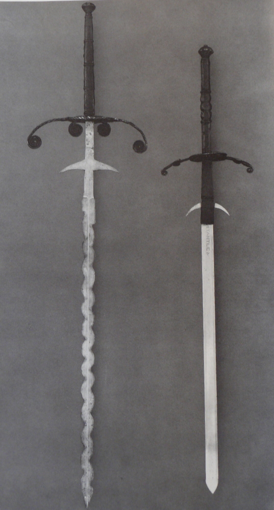

maybe we can get this fascinated weapon structured.
(in my house the twohanders are still a chaos, see pic.)
Landsknecht two hander? 16thC fighting twohanders ? Stantler twohander ?
when did the two hander became processional ? did they also fight with processional two handers? different flamberge blade types ?
the beautiful Braunschweiger twohander? fishtailpommels? difference in swordstyles between countries
looking forward to the reactions?

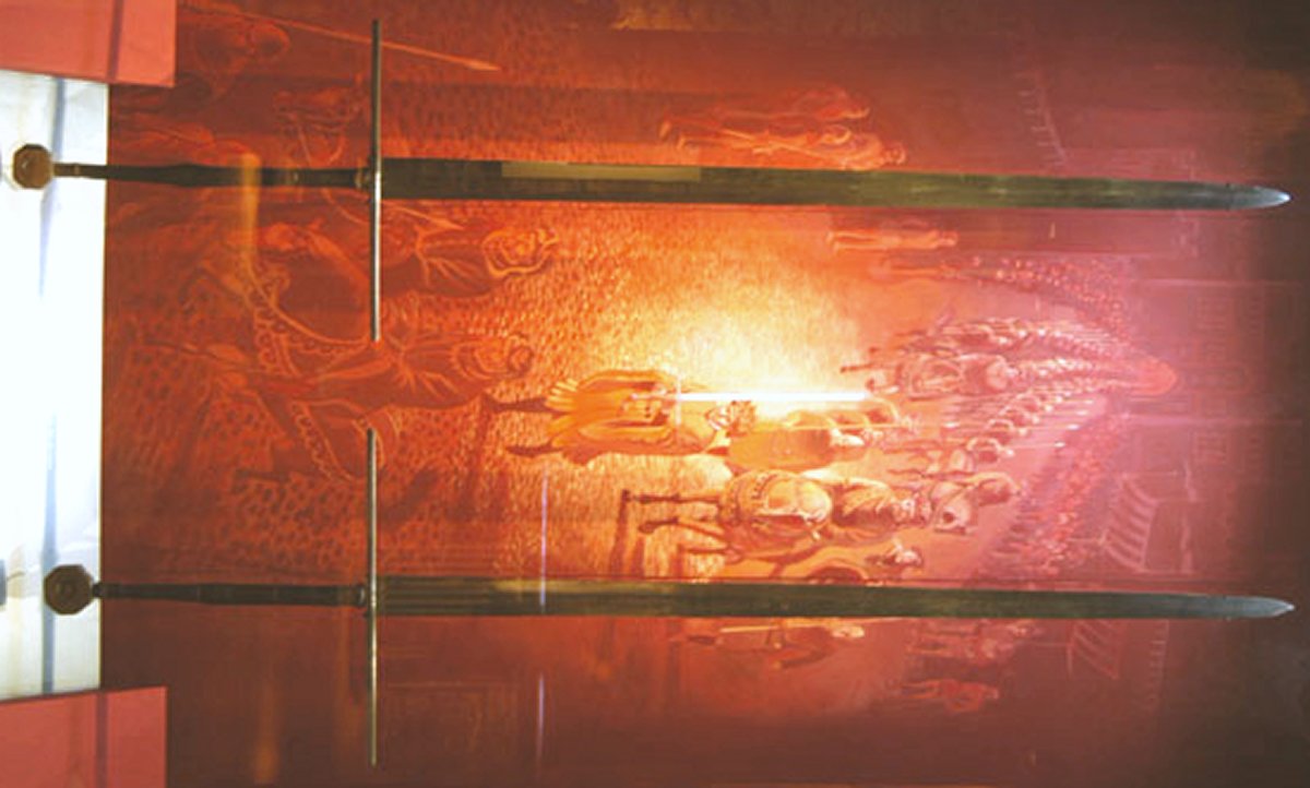

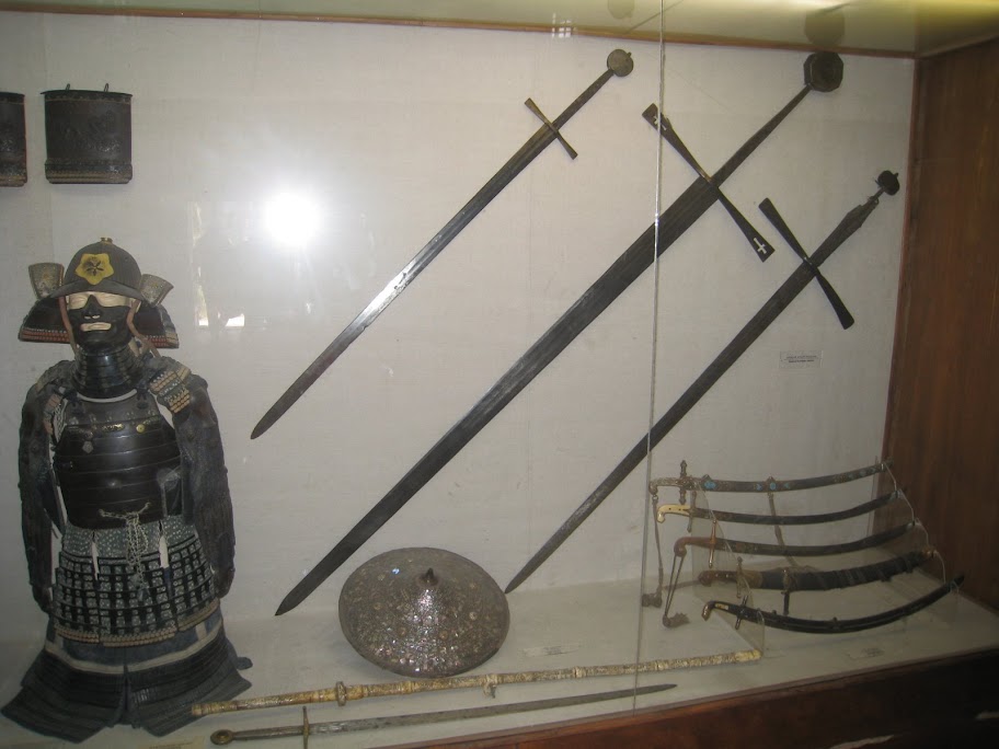

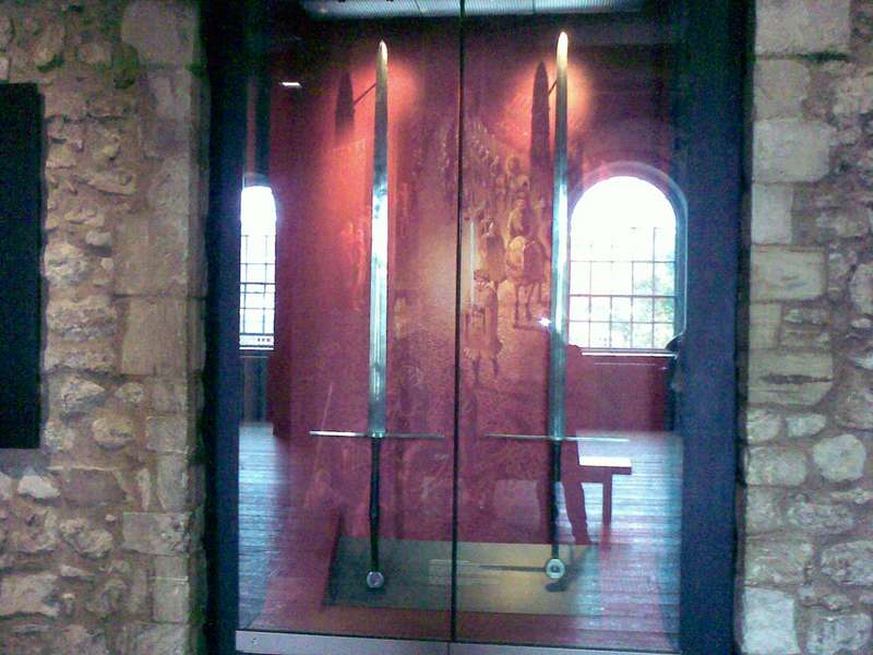

The two handed sword presently on display at the Royal Museum of Scotland at Chambers Street, Edinburgh, is a fitting example of this (centre of image below).
This is a sword crafted in traditional form, but excessive dimensions.
Note the Highland two hander and Lowland two hander on each side. The Highland sword has a blade length of approx. 40", which by scale give the ceremonial sword an overall length well in excess of 80"!
This is one huge piece, with the blade as broad as your hand.
The sword is well made, with a nice blade in fact, but far too large for any practical use.

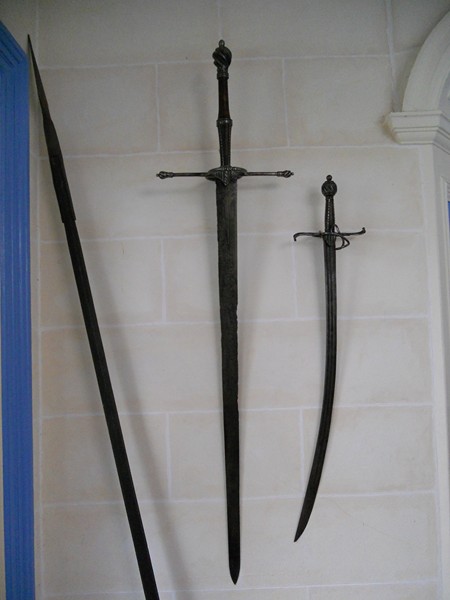

In the Great Hall of Edinburgh Castle there are many swords. A great many original basket hilts and early sabres, one questionable Highland two hander, and two large pieces that at first glance appear to be nicely made German zweihanders.
The swords are of traditional form and dimensions, but closer inspection reveals their true nature.
The blades are excessively thick at the forte and down the length of the blade, indicating a blade weight outwith practical considerations. The grip and pommel are also carved from the same piece of wood. Aye, you heard it right, wooden pommels!
This confirms that these swords are created firstly to look the part, most likely for ceremonial use.
Another possibility exists, that these swords may have been created simply to look the part for a castle or stately home great hall in the C19th, given the gothic revival at this time. Only a closer study to period of manufacture could suggest further or otherwise.

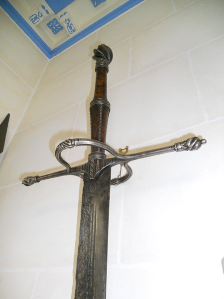

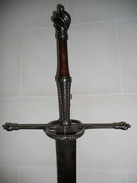

Old 26th June 2012, 02:05 PM   #7
thinreadline
thinreadline's Avatar
Join Date: Nov 2010
Location: Wirral
Posts: 1,204

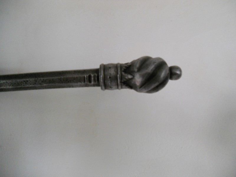

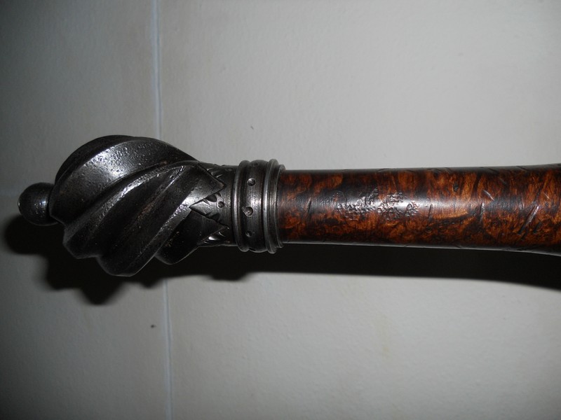

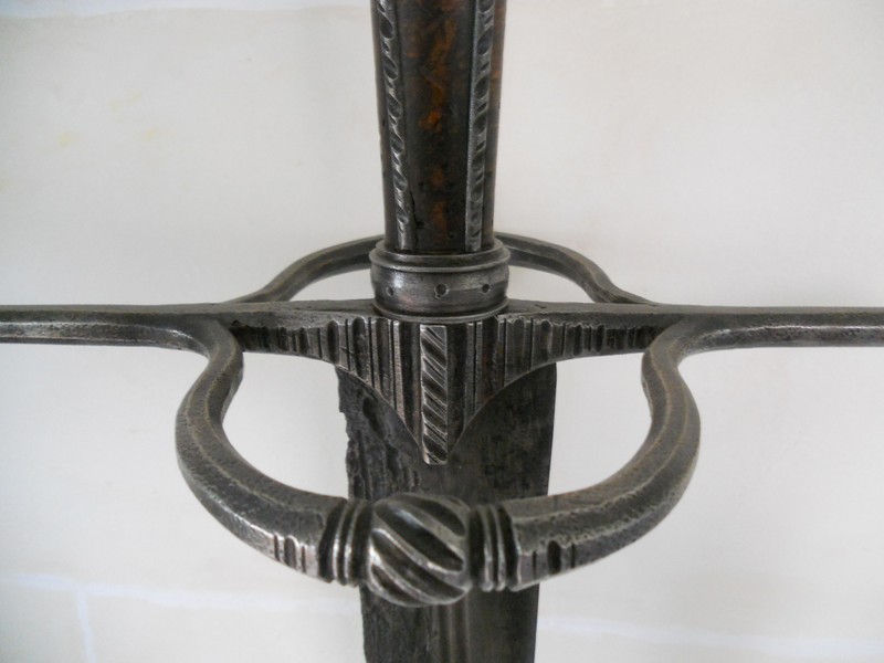

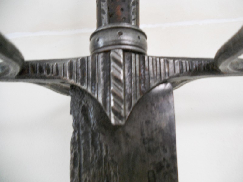

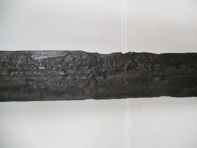

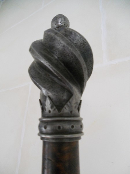

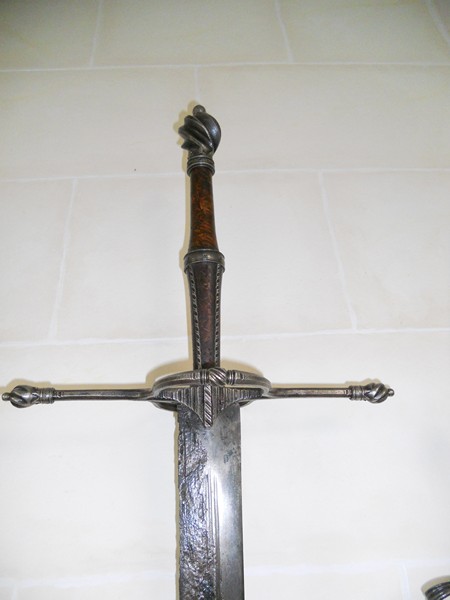

This is my two hander for what its worth. It's approx 150 cm long , the blade is in very poor condition so as the hilt is very good I assume that the two got togther at a later date . The blade is remarkably flexible and exhibits none of the stiffness that I associate with these large swords .
Old 26th June 2012, 02:24 PM   #8

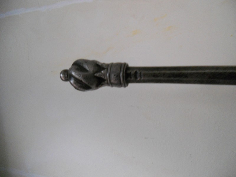

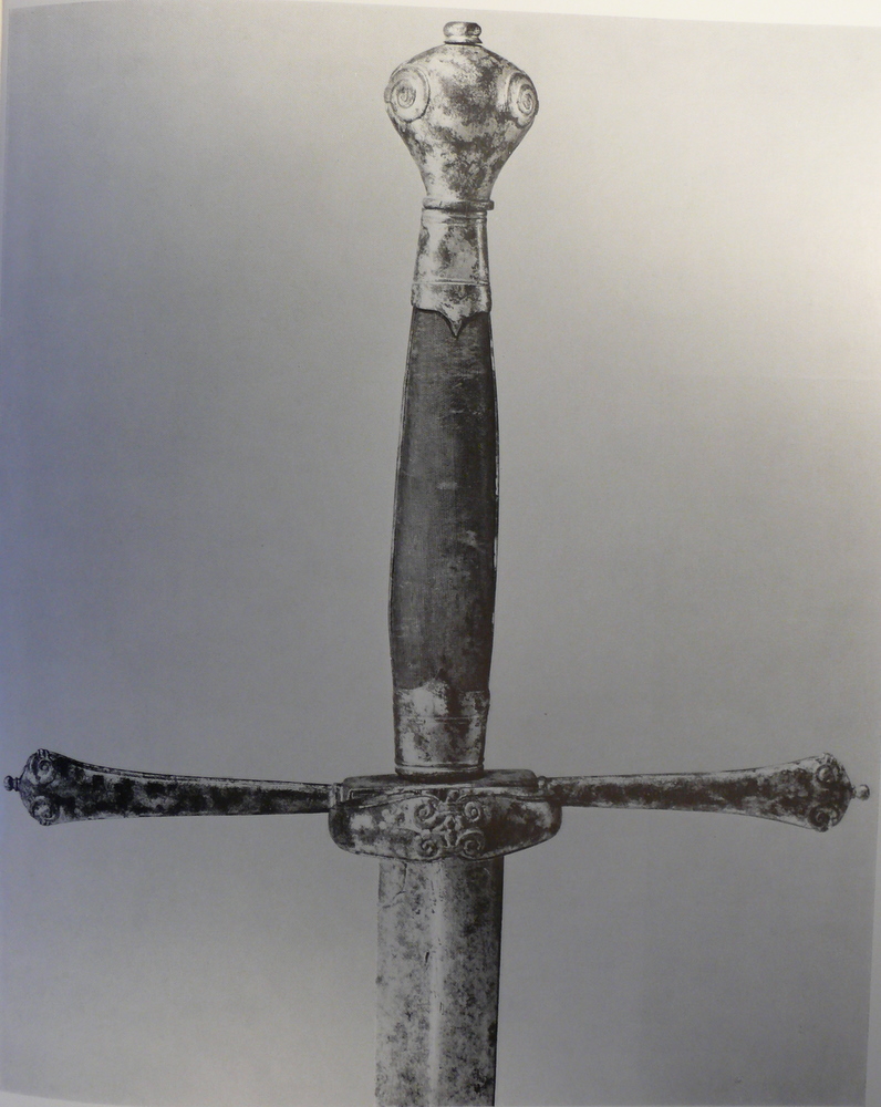

Hi Richmond,
Can we have a close(r) picture of the hilt.
... If you don't mind, of course

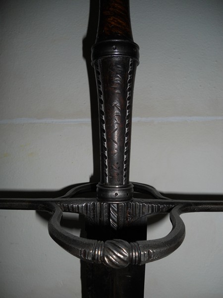

Old 26th June 2012, 02:48 PM   #9
thinreadline
Join Date: Nov 2010
Location: Wirral
Posts: 1,204
Originally Posted by fernando
Hi Richmond,
Not at all , you are welcome ...
Old 26th June 2012, 04:33 PM   #10
Matchlock
Matchlock's Avatar
Join Date: Sep 2008
Posts: 4,310
Hi Richmond,
The ornamental style of the carvings on the hilt seems to point towars ca. 1560, based on the acanthus leaves, although the profuse piercings would suggest somewhat earlier stylistic aesthetics of ca. 1530.
The irregular corrosion of the blade reminds me of swords salvaged from tombs, showing heavy rust only in places that were in close contact with the body.
As to the flexibility of the blade I can tell by experience that blades of two-handed swords are far from being stiff; they are highly flexible instead.
m

Old 26th June 2012, 04:38 PM   #12
cornelistromp
cornelistromp's Avatar
Join Date: Mar 2009
Posts: 1,071
the flexible blade seems very good, I see this more often on two handers. The hilt is beautiful but it seems to me 19thC, although Italians also have created this kind of artwork in the 16th century.
best,
Old 26th June 2012, 04:50 PM   #13
Originally Posted by cornelistromp
... The hilt is beautiful but it seems to me 19thC ...
I am not even a novice but, that was my fear, when i asked Richmond for close ups.
... But again, my opinion is worthless .
best,
Thank you .... that is a possibility of course ... there seems a concensus about the flexibility of these blades which is comforting !
Old 26th June 2012, 09:45 PM   #15
Matchlock
Matchlock's Avatar
Join Date: Sep 2008
Posts: 4,310
best,
Oh yeah, Jasper,
A 19th c. guess concerning the hilt was my first thought as the decorative edges of the quillons seem so crisp - but I did not feel sure as I did not handle it and neither intended to arise negative feelings ...
Thus I confined to pointing out the stylistic criteria.
m
