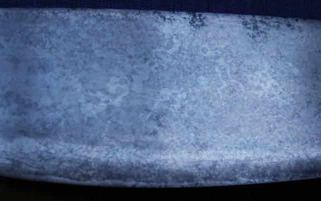

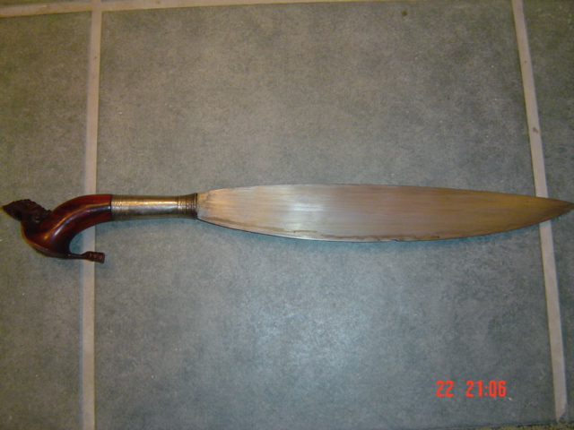

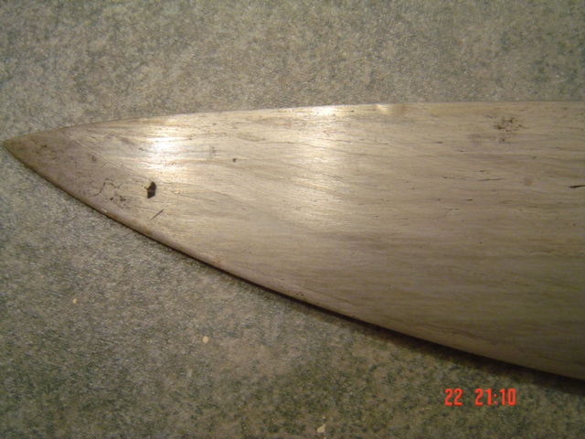

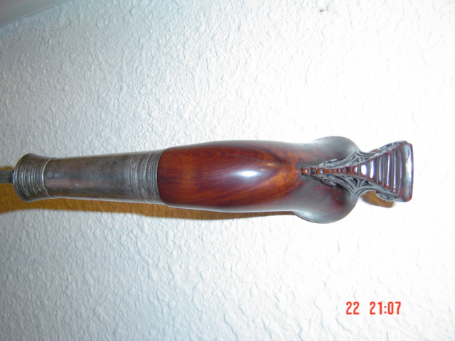

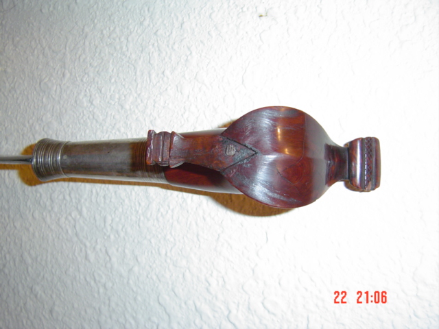

Provenance and age on this Barong please!
Over all length: 23"
Blade alone: 15"
Thick: 1/4"
Wide: 2 1/2"
Thanks,
Punal
punal is offline   Reply With Quote
Old 23rd November 2005, 04:54 AM   #2
Posts: 7,415

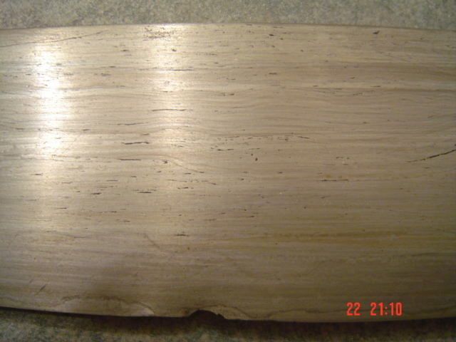

For this puppy, Punal, I would say that it might be Tausug from a mid-prominant owner (but not a datu) with a very nice many layered sandwich construction lamination. I noticed the beak repair. Age? - certainly not any later than 1900.

Good looking Barung. Excellent carving on the kakatua, with a killer blade to boot. Any ideas on the triangular cut out on the pommel.
Battara... why do you think this might not have belonged to a Datu. I would say that this is just as nice or ever nicer than the 2 Datu Barungs pictured on pg. 37 of Cato's book. I would place this Barung in the same category,IMHO.

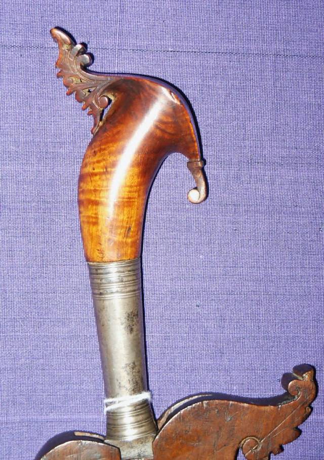

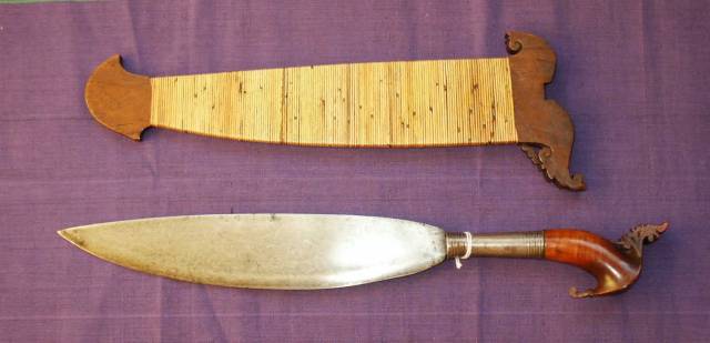

Good catch Punal............ Here are photos of my ceremonial Ninja sword .
It's a bit smaller, it has a swollen edge. Could this be considered a Shandigan blade.
Blade 11-3/4"
Width 2-14"
Thickness shy of 1/4"
Hilt 6-1/2"

Hello Kino,
From your pics, this seems like a Shandigan blade to me. Nice one, too.

Battara seems to think this beak is an (old) replacement - seems to be a plausible hypothesis...

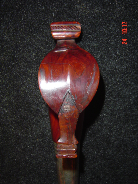

BTW, is that a plain iron nail holding the beak in place, Punal?

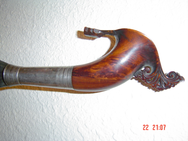

Hi there Kai,
Here's a close up photo of the beak!
The spike is made of wood w/ checked head.
punal
