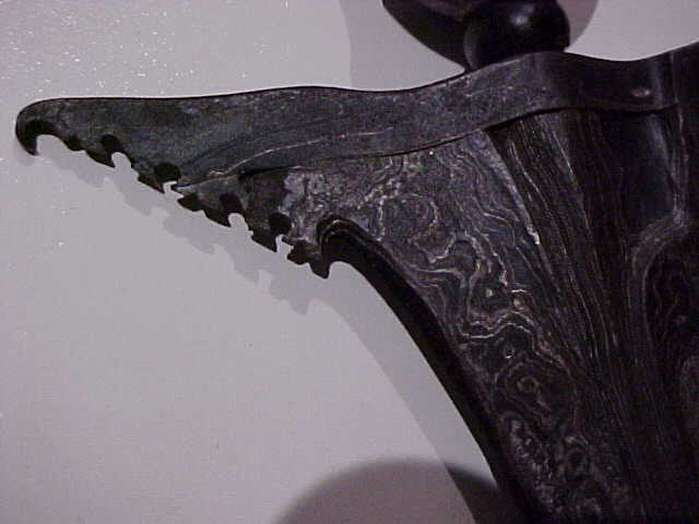

Speaking about newly made kerises, in my opinion its not the pamor but the mainly the dapur / greneng which can tell tell the difference.
some better photo's more from the salesman closely would be nice.
I include some pictures of a recently made blade, to show you what i mean.
