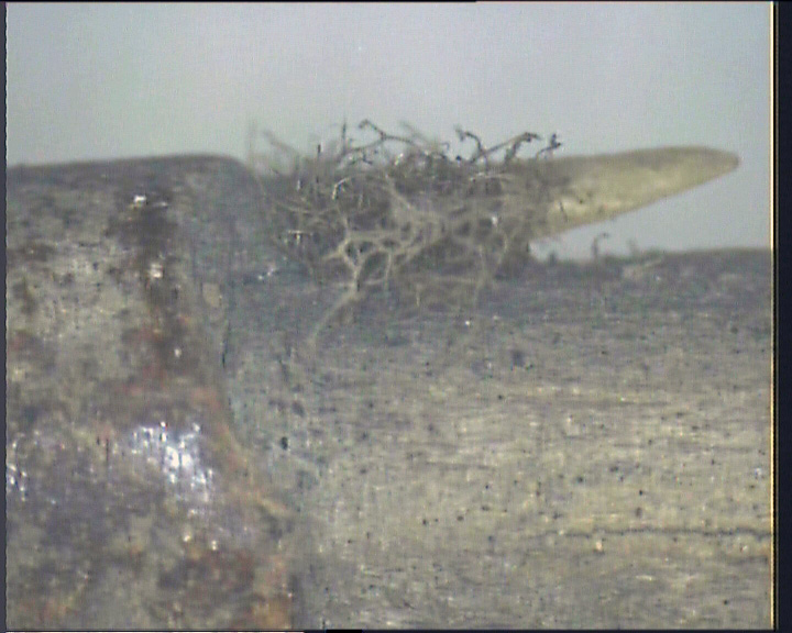

So far, my research suggests that long, barbed arrows like this have been used for warfare, rather than hunting. However, a lot of the literature states that war arrows were often decorated, and mine is quite plain. If it is a war arrow, is it likely to have been poisoned? The pigment at the "business end" of the foreshaft appears gradually worn off (rather than just scratched, as is the case with the rest of the foreshaft), so perhaps poison has eaten into it. Curiously, there are also little tufts of branched moss or fungus-like material lodged behind the barbs. Is this something that would've been used to clean the arrowhead? I have also found tiny, spherical, transluscent insect egg casings behind the barbs and in the joints of the reed, which appear to be from the province of origin.

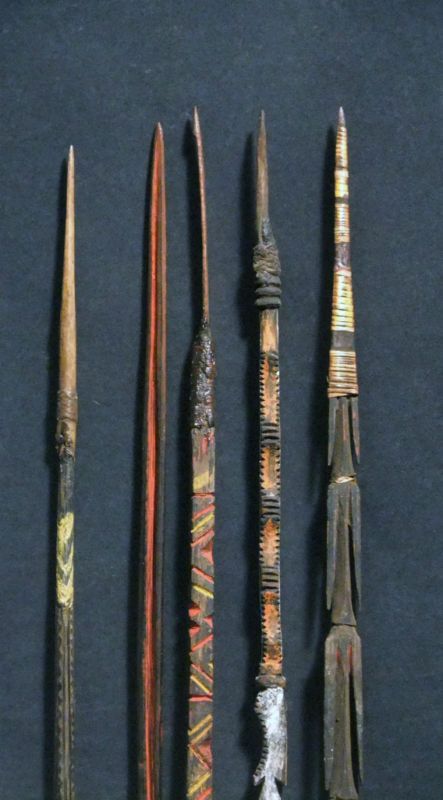

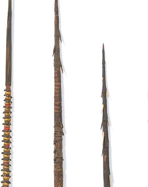

Maria,

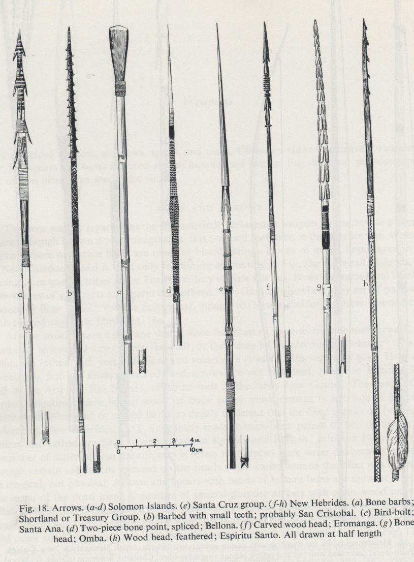

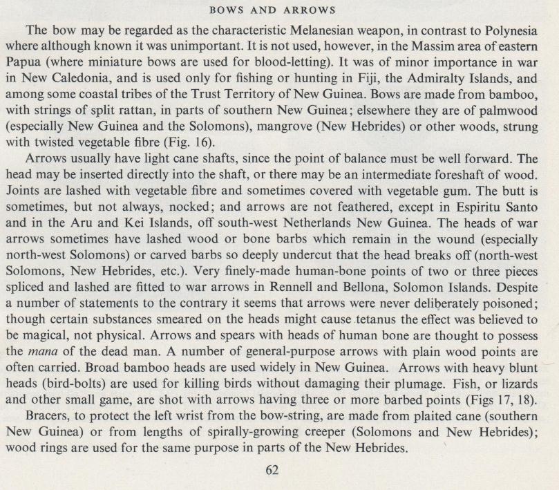

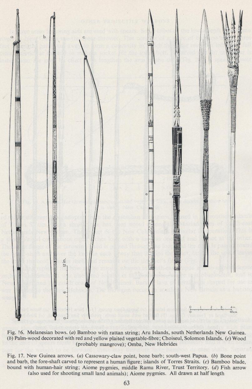

Your arrow does appear to be from Santa Cruz Islands. I think you will have great difficulty finding good enough pictures to work from in most available publications on the Solomon Islands. I have often asked at this forum about working with and finding organic materials for restoration projects like this, I fear most contributors here are METAL HEADS. These picture and the text from "Melanesia A Short Ethnolgraphy, British Museum" will help slightly, arrow "e". I think the only way to work on an object like this is to see a near as perfect example and better still get the chance to have it in your hands. The problems I see are getting the rattan like materials and in small quantities. Then is the material worked after soaking? you can experiment. You might have to get heavier materials and work them down. I needed to do some rescue work on an Amazon club. After reshearch I found all the correct materials were availabe in a local garden centre, the sisal needed soaking to take out the coils. If you are in the UK you coulld go to the Pit Rivers Museum Oxford where there will probably be arrows on display. The British Museum will have what you need but not on display. It is possible to arrange a visit to the store where samples will be layed out for your inspection. I do not know if this service is free or not. Lastly perhaps your arrow may have always been plain?

Ed and Tim, thank you very much for your contributions! I haven't been able to get in touch with the PNG Museum, but wrote to heritage organisations in Fiji and Vanuatu, so hopefully they may take an interest in this and put me in touch with the right person. I've also appealed for help at the BM and Pitt Rivers. Tim, thanks for posting this article, it has been most useful. The bit about Solomon Islands arrows with undercut barbs designed to snap off in the wound seems to fit, as the wood directly behind the barbs on my arrow has been carefully undercut, and they would snap off easily under the slightest pressure. Elsewhere on this forum I have seen some discussion about the practce of wrapping plant material around arrowheads to cause infection in the wound. Could this be the purpose of the moss-like fibres stuffed behind the barbs on mine?
