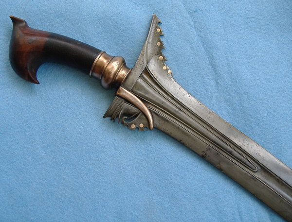

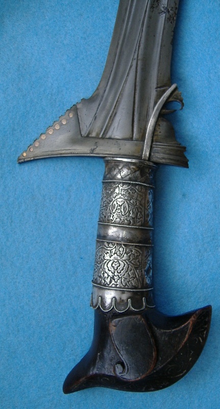

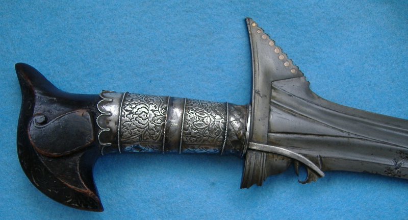

I picked up this example in Baltimore last year and just had a scabbard made for it by a forumite. Note the unique elongated "stirrup", the good blade chieselling and the slightly down curved blade. The point is also more gradually tapered. Note also the worn carving on the pommel that is a unique shape in its own right.
Any symbolic significance to the brass inlays that anyone can think of??
Origin? The peninsula?....Borneo??

Looks like a Malay sundang to me (i. e. peninsular). AFAIK, the blade is not from Mindanao nor Sulu. The pommel as well as the silverwork have a Malay feel to them, too.

Yup I'm with Kai - definitely Malay all the way.
As far as the brass dot inlay are concerned, this came up in another thread stating that the brass may be used to word off evil spirits and influences for the Philippines and I would extend this as a possibility for the rest of the Malay/Indonesian/Philippine world as well.
This blade doesn't look antique to me - maybe more like before WW2? While the dots may still have had some meaning in Malay culture, I wouldn't discount the possibility that they were just added because they are seen in some Moro kris, too...

I am just curious; what about this blade does not look "antique"? Were it a Moro blade I think it would be much easier to "date", but I am not as familiar with Malay blades.
Could you please post some comparative examples for contrast and study?

The engravings on hilt look like a chinese work, compare it to pendok on second keris here: http://www.vikingsword.com/vb/showth...=chinese+keris
Is there a possibility, such (triangular) configuration of fullers on base of blade is more sumatran then malay? Have seen such on two sumatran dreesed keris blades.
If this were a Moro blade, the strongly angular separation line would most likely place it in the 1920-1930 period. Thus, it seems unlikely to me that (despite their obvious creativity) any Malay bladesmith made this earlier.
Your blade looks nice (with workmanship of better quality than most Moro kris of that period) but lacks the crispness and flow I'd expect from a 19th century kris (of good quality); some details like the greneng and the jalen as well as the pretty homogenous metal and the stained wood pommel seem to support a 1920-1940 period for its origin. Wait a decade or two and I won't quibble with it being antique anymore...
