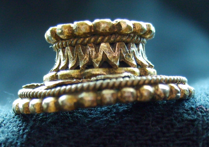

G, Day .

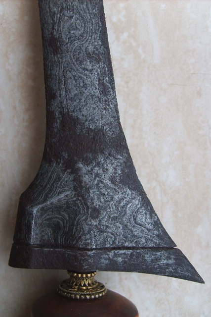

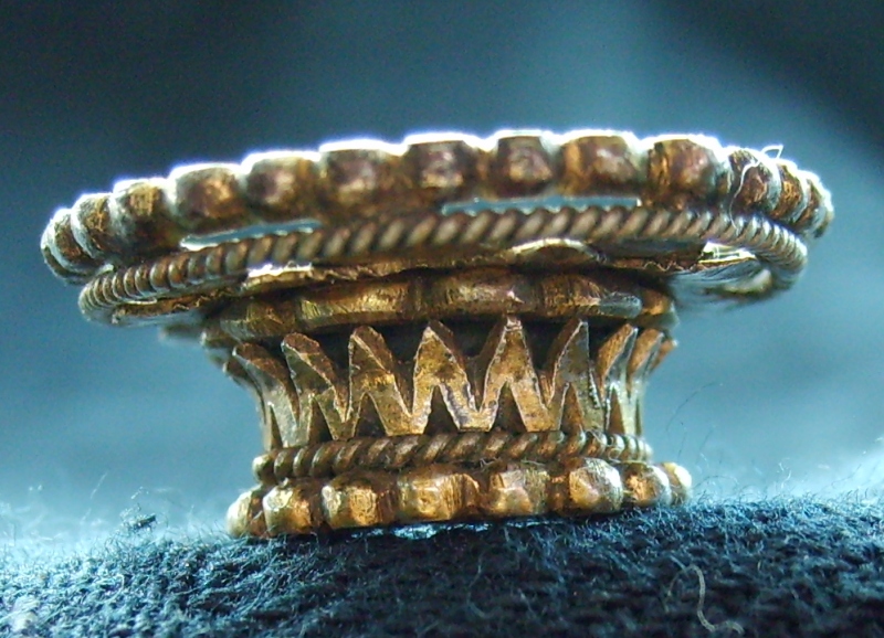

This week I bought some keris from a local auction site , the most is rubbish but there was one East Javanese keris with this mendak .
The keris is relative simple but imo old and ''original'' (so far this can be )
I want know now if this type of mendak is a older type and from East Java ?
Greetings,
Danny

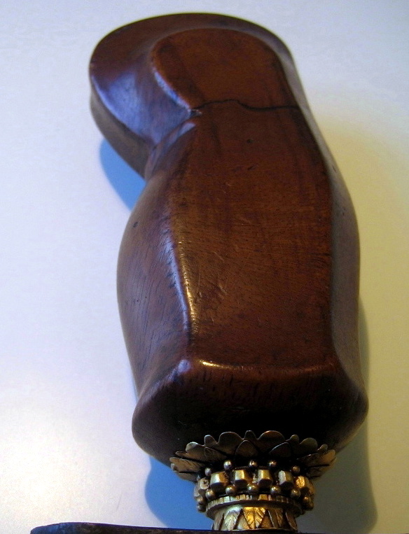

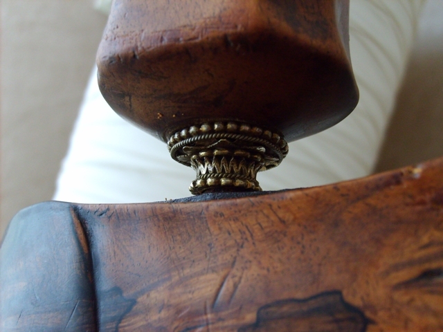

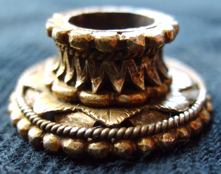

No one a idea
I did make a new photo , not so in close up.
Just want to know if this mendak style is ok for a east java keris.

Hi Danny,
I don't know if this mendak is from East Java but it is a very nice one, I think that I never have seen a similar one. The material look like gold, do you have tested it?

Danny, when we move away from the mainstream, particularly with keris that have a bit of age, it is not at all unusual to find mendak that don't fit the usual patterns. This one looks as if it has been done by a village jeweler somewhere. However, you don't show the entire keris, I don't know if I'm looking at Bali, Madura or East Jawa. Would a full length photo in and out of scabbard be possible?

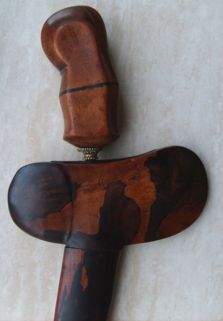

@ Detlef,
Yes i think also it's gold , i did not test it because i have the keris just a couple of day's but I'm 90 % sure it will be gold.

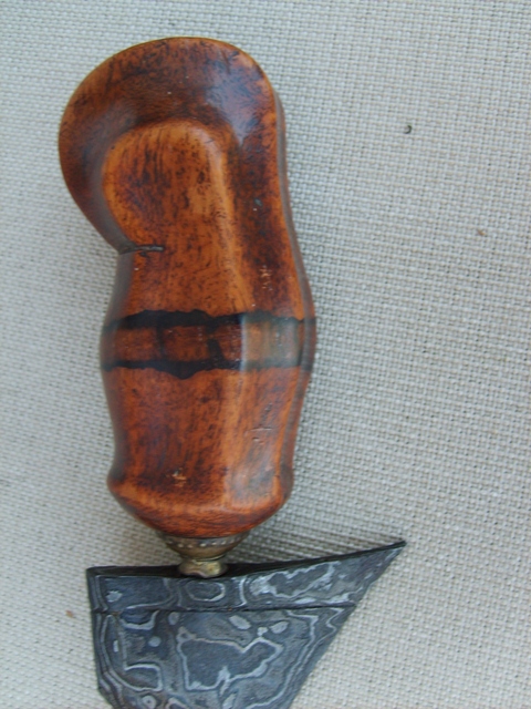

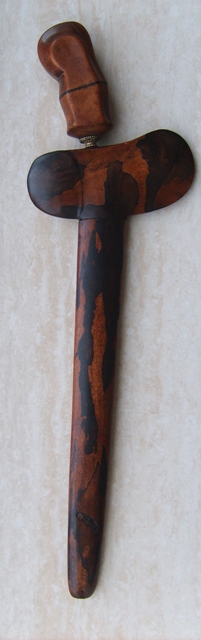

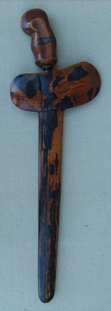

@ Mr Maisey.
Yes it's ok for me to show this keris , here some photo's maybe that will give the answer where this keris is from? To me it looks really big for a keris from East Java especially the hilt( . But the blade is Javanese to me , It's not cleaned yet so I hope it's ''clean'' enough to determinate .

imho, your keris originated in Tuban (east Jawa)

Thank's for your opinion , but what do you think of the mendak is it the good style for the keris ? That,s why i started this thread

Posts: 7,297
Frankly Danny i am not sure that thus style of mendak looks correct with this hilt form.
Old 26th September 2011, 11:49 AM   #9
GIO
GIO's Avatar
Join Date: Dec 2009
Posts: 335
The mendak seems suitable for the blade, but not for the hilt, which is balinese type.

As I understand, there is lack of any serious documentation about East-Javanese keris. Despite this, it seems to me the whole ensemble could be original. Old keris is mostly nothing for purists. Regarding this hilt form, I am almost absolutely sure it can be found on East Java.

I agree with Gustav that a variation on the Balinese bondolan hilt is known in East Java. If i am not mistaken it is generally a bit shorter and squatter than it's Balinese cousin as this one seems to appear.
I would still say that this mendak doesn't look quite right with it though...

I would say that unlike Danny's mendak, which looks to have been made to fit the flat bottom surface of a typical planar style Javanese hilt, your mendak seems to have been made to fit the curved contour of this bondalan form.

Posts: 7,228
Danny, I know this style of mendak, and class of workmanship, as Madura, village work.
The dress I think I would probably give as Sumenep, Bali --- good story goes with this, but I'm pressed for time, and I think I might have already told the yarn anyway.
The distinction between Sumenep - Bali and Bali - Bali is very fine as it is a matter of proportion, I cannot rely on photos to tell me accurately what the proportions are of this dress.
From what I can see of the blade, it does have some Tuban characteristics, but from the pics the material does not look like Tuban, again anybody with any knowledge would really have to handle it before giving a definite opinion. I cannot give one based on photos.
Re "East Jawa". Madura is in East Jawa. It is a part of East Jawa. Used to be a ferry ride to get there, these days you drive over a bridge.
There is definite Bali influence in the dress of keris from Blambangan, but I do not know this particular dress of yours as Blambangan.
Based upon what I have been told by people living in Sumenep, and what I can see in these photos, on balance I would opt for Sumenep - Bali.
The mendak might be gold --- anything is possible --- but in all honesty the quality of workmanship simply does not sit well with even a village gold smith, it looks like a village jeweller's work, and I feel that I would be more inclined to guess at an alloy something like pinchbeck. If it is in fact Sumenep - Bali, I'd be inclined to leave it exactly as is.

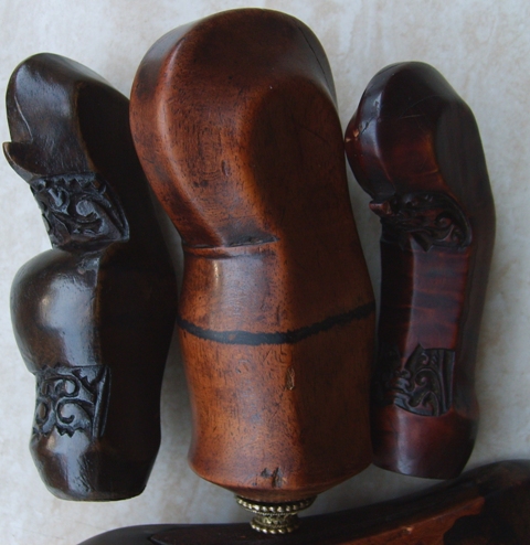

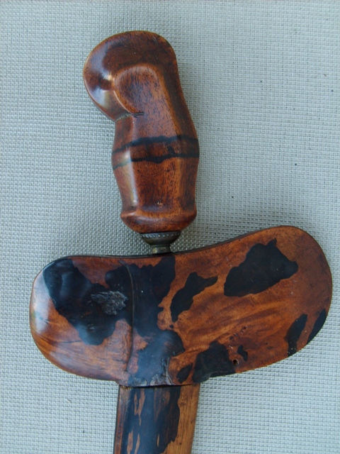

See the 2 photo,s a attached from the bigger brother I found together with 'my' keris we are discussing above. Or do I make a mistake and is the "eyebrow" not a typical Balinese feature ?

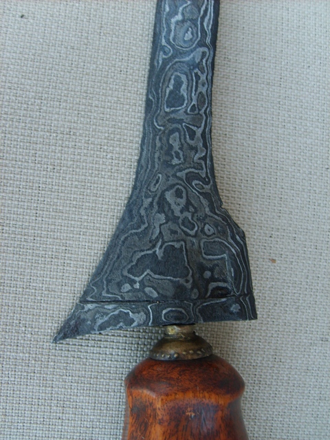

Hello Danny,
Please post more pics of the 2nd keris!
I feel that it rather strengthens the POV that this pair did came from Madura (with obviously heavy cultural influence from Bali). I'd keep both as found - IMVHO it would be a shame to alter a genuine combo as both appear to be. I'd only consider to patch the drilled holes with wax (or a traditional woodfiller if you're sure to achieve the same color).
I'd love to hear Alan's opinion wether such a selut as seen with the 2nd keris is also not unusual for the Madura-Bali setting!

I agree. From what i can see of this second keris i thing it may well not be a Bali keris either. The shape of the sheath seems off and the mendak here certainly doesn't look Balinese. Please show us the whole thing...

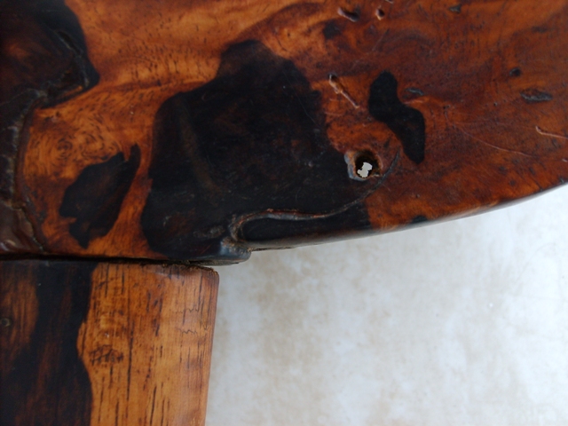

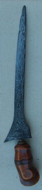

Hi David and Kai.
Oke here the photo,s of the second keris . It was not my intention to show this one because I was thinking to sale this keris and not keeping it for my collection but for learning and discussing it is of course useful to put the photo's here .
The Patin on the Waranka and hilt of this one is great , the ''mendak'' i have seen this style before on a Madura keris .

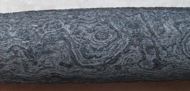

The Blade is nice and I already did some cleaning on this one .

VERY NICE JOB ON THE BLADE !

Hi Danny,
agree with Willem, very good etching job and nice blade which look like a East Java or Madura blade to my eyes. Sheath and handle look balinese. But agree with Kai and David, keep it like found. How is the fit from the blade inside the sheath?

The fit of the blade in the sheath is not ''original'' the sheath is to wide for the blade , but I think it's already a long time like this .
I'm still not sure it's Balinese , it could be but the sheath is a little more ''fat'' then what you see common for a Balinese Waranka .

I think this one might be all Madura from the looks of it...

I have no hesitation in providing my opinion that this second keris is 100% Bali-Madura.
