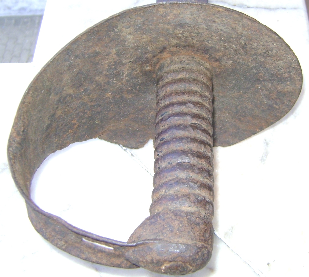

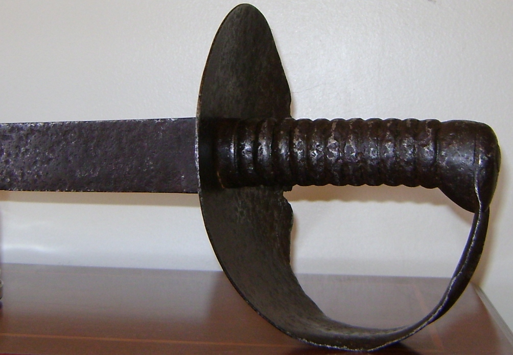

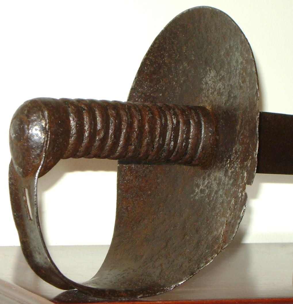

The provenance is a collection from a local family house. But it doesn't have to be Portuguese; having most probably seen service in Portugal, but certainly imported, i would say.

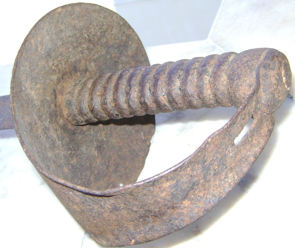

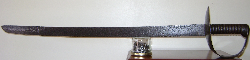

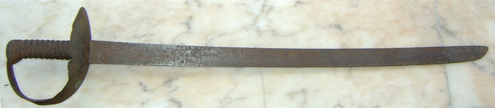

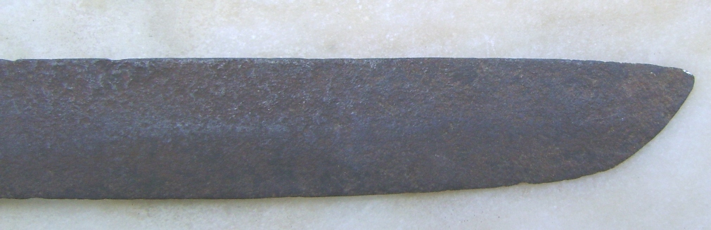

I don't find tis model in the couple publications i have; the grip and hilt are iron, the guard edges rolled only in the narrow section, half way to the pommel. The slightly curved blade measures 70 cms ( 27 1/2"); the tip might have been clipped, probably broken by accident?.
A rather slight ridge can be noticed in the last section, ending in the tip.
Quite wide (38 mm) and thick (8 mm), both measured at the short (but existant) ricasso.

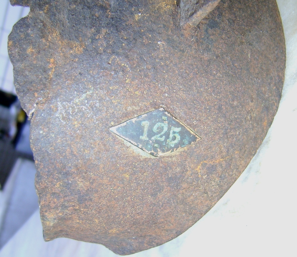

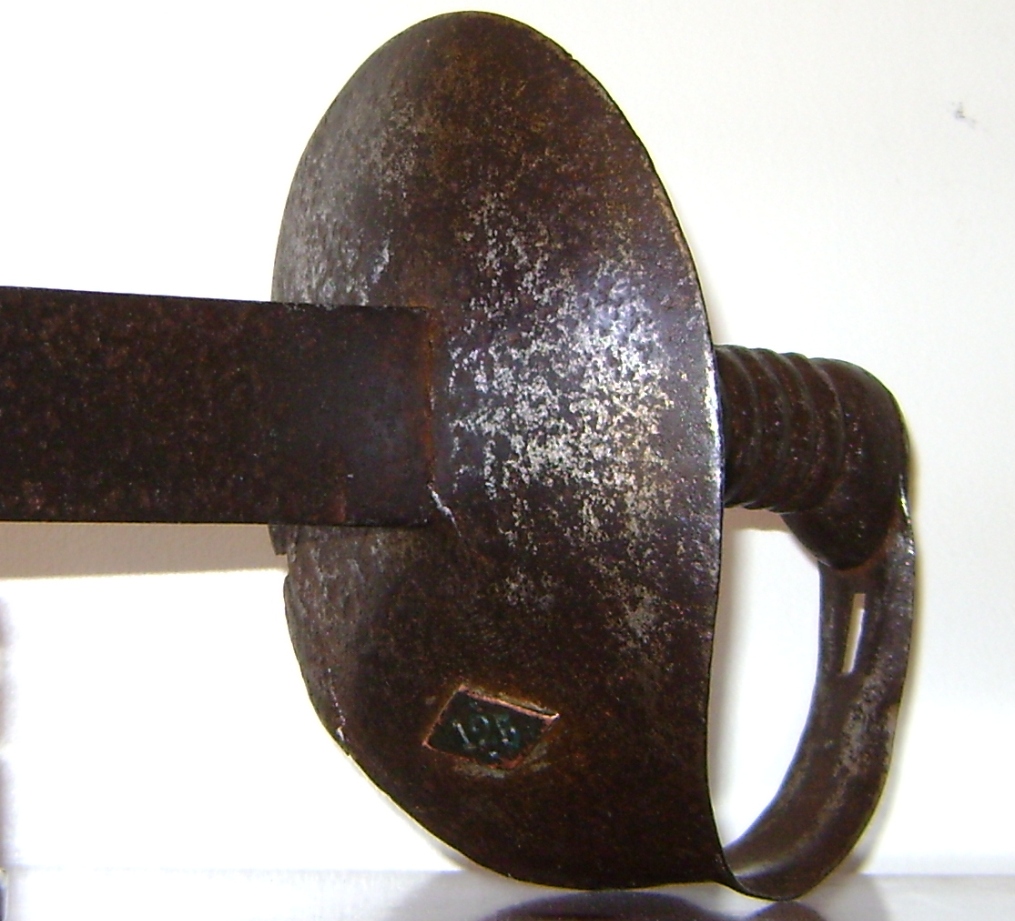

The lozenge label is in copper; could the number #125 be a regimental mark?
The slot for the sword knot defines this sword as non civilian, right?
Any help to ID this piece would be much appreciated.

You hit it right on the head, Fernando! It is in fact the m1845 british boarding cutlass with the diamond-shaped copper plate displaying the rack number (this would have been assigned to a specific part of the ship and cataloged as such). These are very popular among naval collectors, although this one has seen better days. That being said, I like it! The rusting shows true character and probable use at sea (salt air just loved these swords, thus the reason many were primed/painted/japanned and tarred to reduce rusting). Many examples are pristine because they never saw any action, just sat there on some lonesome rail rack- ). These were used after the Age of Fighting Sail (post 1820), so hand to hand fighting on deck as well as naval combat had decreased, but one must remember that this was the time of the Malay pirates, Sepoy Mutiny and merchant shipping passing through other pirate hot-spots. These served as deterrents for both native attacks, pirate boardings and potential mutinies.
As far as I know, this pattern was only used by the British. I say this without absolute certainty because an earlier type of British cutlass, the figure-of-eight m1804, was so popular, that it was copied in multiple countries (I'm not at home to access my books, but I believe Norway, Germany/Austria, Sweden, the U.S., etc) but lacked the GR (George Rex) marking. Some had the crown mark, but a different crown than that found on the British types. The German makers Schnitzler and Kirschbaum even made a version with a spurious GR marking into the 1850's. This is obviously a whole different thread, though.
This model was replaced in the 1870's with another naval pattern, so this sword's 'life' would be in the 1845-1870 range. I noice that the tip on yours is slightly different than the standard pattern (reshaped during it's working life?), which isn't unheard of for these hands-on swords. Like the boarding axes and other naval implements before it, these items were often sharpened to death. Likewise, if it was de-commissioned after naval use to a merchant ship, it could easily have been shortened to the user's liking. I also mention the decommissioning to answer your question as to whether it was a naval sword or a private purchase. Probably both, but it definitely started life as naval. For some reason, with naval pieces (many of which were carried on ships LONG after they were obsolete), they seemed to be handed down from government usage to private purchase. Thus, we see U.S. naval boarding axes from the 1800-1812 era with re-issuance stamps, shortened hafts, cut-down or flattened spikes, etc, that were not the original axes, but altered during their working life (and not in ways the U.S. naval inspector Mr.Tarbell would have approved of- ). In any case, a nice find, my friend. And you were right about getting my attention!

I confirmed that the typical length on these is 28 3/4". The tip isn't typical, so it could as we both surmised, be shortened, but there is also the chance that this is a varient (i.e. Spanish or Portuguese) pattern. As I mentioned in the PM to you, the British m1803/4 was a popular naval model that was both exported to Spain/Portugal after the wars as surplus, but also directly (these are the pieces that either lack the GR gov't stamp or have the Spanish crown imprint on them). If this pattern (the figure of 8 m1803) was so popular that it was made for other countries, there's no reason to immediately dismiss that the m1845 might not have been as well. Here are some points to consider-

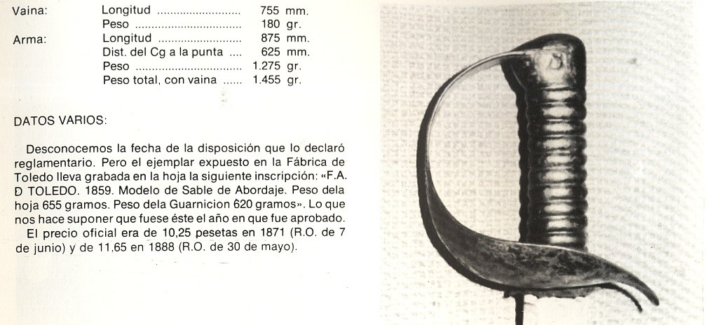

In his work ARMAMENTO PORTATIL ESPAÑOL 1764-1990, Marceló Rubi illustrates and describes a SABLE DE ABORDAJE (boarding cutlass), with overall characteristics similar to the British P1845, except for the shallow blade fullers and the turning of the guard top (i miss the correct term ).
There is no certainty as to the date of this model but, as the example exhibited at the Toledo Factory reads 1859, it is thought such is the date of this pattern.

Thank you, 'Nando, for posting this information! I'm always looking for more knowledge on the evolution of the cutlass throughout its history. I was unfamiliar with this particular volume and that cutlass pic is awesome. It supports my earlier point that the pattern was copied. Good point, also, that it was more than likely copied from the Brit m1845. The example in Brinkerhoff's book marked "1819" remains a mystery and could have been so-marked to represent a special date, event, or ?
As you astutely point out, this information both adds to the knowledge we have, but also further opens the mystery ( if these were produced on a large scale, why don't they turn up more often? Were they produced for the navy or a private-purchase merchant fleet? Did these Spanish swords make their way to former republics such as Argentina, Brazil, etc? Remember our Brazilian cutlass we've discussed in the past?). In any case, thanks again for the reference. I'll file it away in my records...

I gave it some cleaning, based on (first dry and after wet) sand paper; the result is modest, a bit better at naked eye than in the pictures.
Say Mark, the black paint; the grip was surely painted black, as some traces remain in it, but the pommel ? was it also painted ? i don't think the guard was painted, as no traces there. What would you say about that ? ... and, such black paint finish would be mat or glossy?

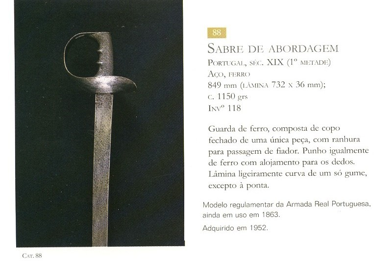

I was searching my couple books and found out what is supposed to be a true Portuguese boarding cutlass; in the catalogue of the fine collection of the Palace of Vila Viçosa.
This is considered the regular model of the Portuguese Royal Navy in the first half XIX century and still in use in 1863.
The hilt and grip are in iron and there is a slot for the lanyard. Blade slightly curved, with a false edge near the tip.

Mat vs glossy finish- In truth, I've seen and handled both. It also depended on the type of material used during the japanning process. In the earlier cutlass, say pre-1800, they tend to have a flat finish, but whether this was from weathering over time or the advances in types of primer in the later century, I'm not sure. Likewise, one must be careful to look for honest aging, as modern spray paint has a glossy finish.
Your sword- Hmmm. Perhaps the guard has had the paint worn off faster then the pommel/grip? The pics don't tell a full story, as at first, I thought the guard had been primed. Judging from the extensive pitting, I'd say the guard seems to have taken the brunt as far as weathering. That being said, I do have that one cutlass that I posted awhile back with the sheet metal guard, late GR marking and ribbed iron cast grip. It's sheet guard had only a very light brown primer compared to the grip and blade. Not sure why this is.
That pic of the Portugeuse sword is the best. A m1803 on the 'Bay not that long ago had a grip just like this one (with the grip shaped literally for the hand), but I had never seen one and suspected it was a 'put-together". In retrospect, it was probably one of that particular model that had been produced in your country. Very interesting! BTW, judging from your new pics, this probably is the Brit pattern with a shortened blade (you can see where the ridge on the side of the blade originally would have come to the tip. I think it has wonderful character and I'm glad you gave it a good polish. Too bad we may never know for sure how it ended up in your neck of the woods, but the most likely case, I think, is as an import. The wear & tear came in it's long working life serving on a local merchant ship.
