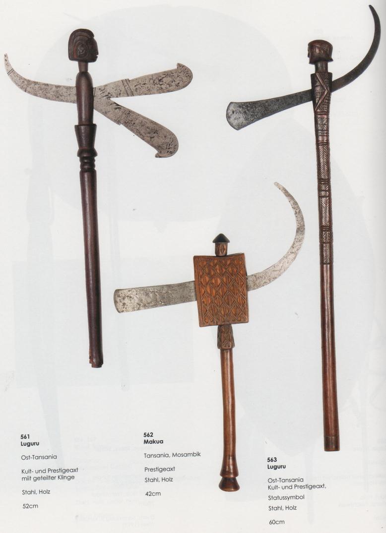

An interesting African axe and good discussions on its potential origins etc. I would just like to add a few further points for conjecture :-
The axe is a recognised type from Tanzania and down into Mozambique, made by Africans. They were often "badges of office" used by headmen or important personages and carried on the shoulder. The trade brass and copper wire, and brass upholstery nails, were common African adornment used on weapons.
As noted, this area of Eastern Africa was extensively penetrated in the 19th century by Arabs of Omani origin (also Swahili and Baluchi) slavers and ivory traders. They established an extensive network of transportation, settlements etc. Also alliances with African tribal leaders. The brass medallion with the Arabic inscriptions could well have been given to an African ally in their slaving/ivory trade, either as a gift for adornment or a "membership card" in their joint enterprise. Probably the trader kept a stock of these medallions for distribution as felt appropriate. I think it unlikely the axe was the property of an Arab in Zanzibar.
A couple of useful references on this topic are :-
"Armies of the Nineteenth Century : East Africa" by Chris Peers 2003
"African Axes" by Carl Gosta Widstrand

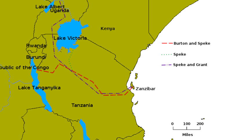

to the "Gang"
I am surprised that nobody mentions that for a long Zanzibar attracted the greed of merchants Persian, Arabic, Portuguese and British, for its spices;
- clove (whose smuggle collection was convict by death penalty)
- nutmeg
- cinnamon
- ginger
- cardamom
be side to the slaves trade, the Omanis were great traders of spices, and the production of Zanzibar was in addition and in complement of their supplies coming from India
in 18th 19th century, spices was having value as well as it was ... gold,
that explained the Omanis's interest for the 25–50 kilometres (16–31 mi) off the coast of the mainland, and consists of numerous small islands and two large ones: Unguja (the main island, informally referred to as Zanzibar), and Pemba
few references to dates
Zanzibar became a part of the Sultanate of Oman, though as a trade center, it began as an Omani trade station, or outpost, controlled by Omanis in the 18th and 19th centuries.
Britain established a protectorate (1890)

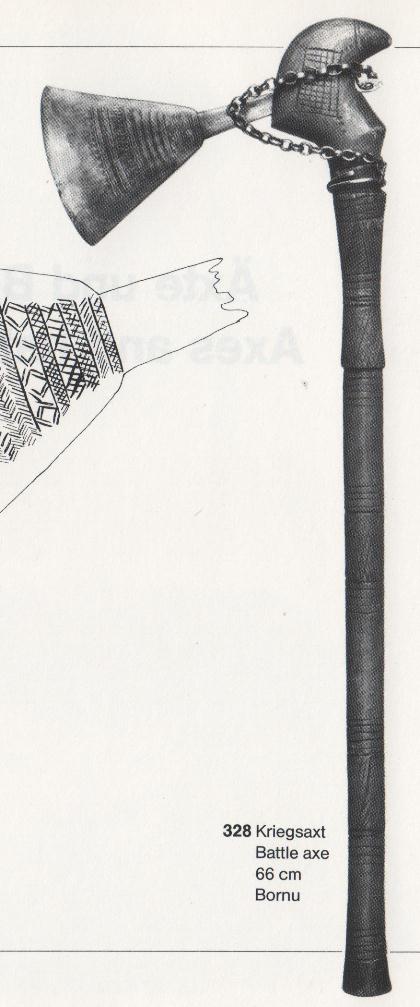

Can anyone think of other instances of decorative chain on these types of axes in Africa? As I mentioned, this is an affectation well known on many sa'if from the Hadhramaut regions and Yemen, which compellingly suggests that it would have been known with trade headed to Zanzibar. From there, again as previously noted, the Omani trade routes into the interior may haved carried the feature into tribal contact in these interactions.

Posts: 5,999
Much further west. Islamic influence city. From "Waffen aus Zentral-Afrika"

Hi Jim and thanks so much for your forward thinking comments.
There is another axe of similar shape on a certain auction site, (still live, so I can't post a pic). This axe also has a chain attaching ring on the pole, but no chain. Otherwise it is plain apart from what looks like a wrap of silver? on the haft. So it would appear that my axe is not alone in having (at least) an anchor for a chain.
