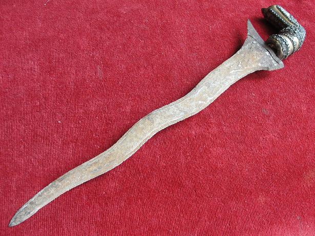

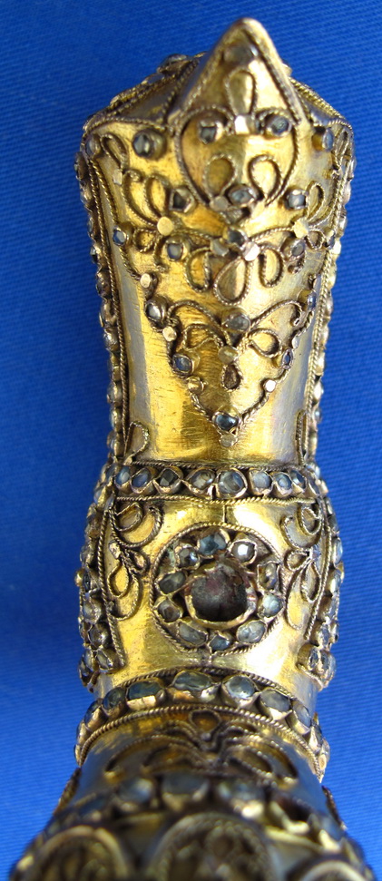

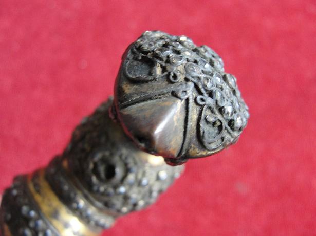

Unfortunately I was not able to purchase this one.
But after a few weeks I sort of grew over the dissapointment and now want to share the pictures to enjoy ,for reference and discussion
It was offered as a restoration project.
Funny enough a lot of buyers suggested to the seller that the pendok could not be the original as it should have been more decorated/embellished
Note the wrangka's decoration on floral motif on both sides.

Hi Willem,
thank's for sharing. very nice sampir. I think from "white buffalo" horn. Can we see the blade as well?

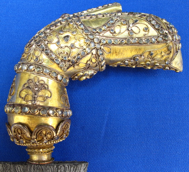

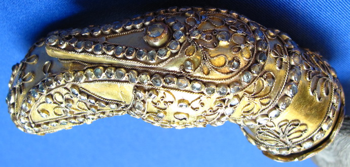

I think the wrangka is Buffalohorn.
Not as special as rhino, but still quite a large peice of buffalohorn.
It must have accounted for certain status.

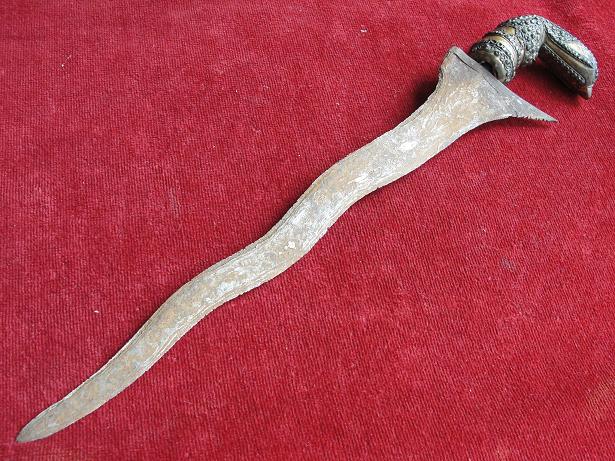

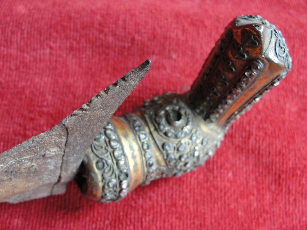

Here some more pictures.
The blade is not cleaned and not photographed in a good way.
But it gives an impression.

Hello Willem,
The sheath crosspiece made from carved horn is very nice indeed but besides the hilt, what makes it a Banjarmasin kris?

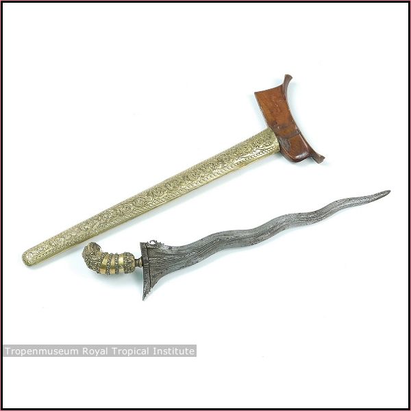

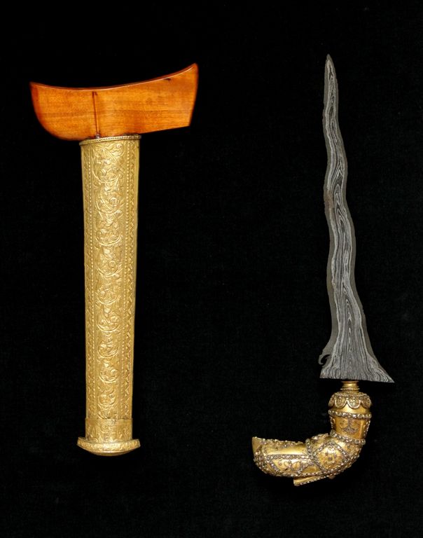

Hello Jean,
There is not very much information around, but as far as I know the blades are always import blades. So there is not a "Banjarmasin" style of blades.
So I call it Banjarmasin when the hilt is banjarmasin.
From pictures in other threads I found that often the wrangka is quite simple and sometimes almost symetric in design.
Further, the examples I found with pendok's all have very simple brass plain pendoks.
This wrangka has a floral decoration something which is found more often in the Banjarmasin area due to muslim influence. It is also known from Negara weapons. such as parang nabur;s and the scarce negara mandau's.
If someone has more and/or different info on this I would surely like to hear it.
Willem
