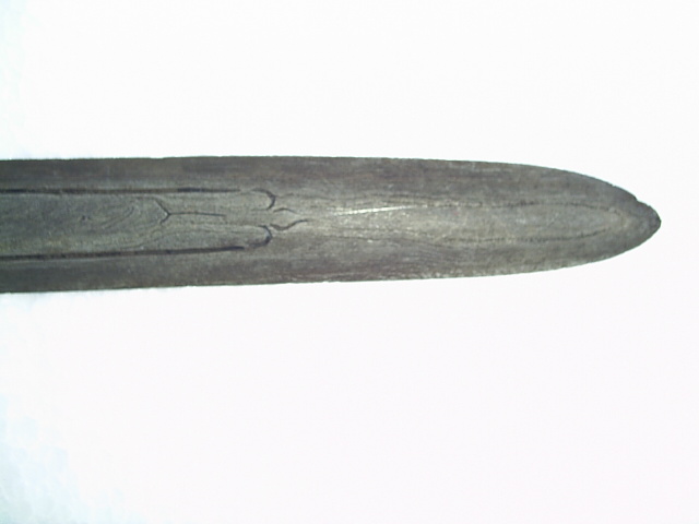

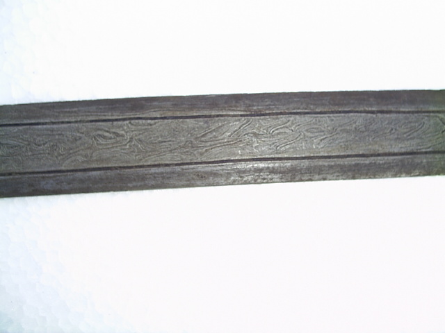

Hi guys,
Can u please comment on the age and origin of this kris? I'm thinking of sulu. Blade is laminated and the edges with twisted rod at centre. I dont know how many twisted does it consists. Anybody can help on this? Harsrinuksmo's encyclopedia describes the tunggakkan feature at the ganja is post 1820's but this one looks older (?). Could it be an 18th century piece? Heres the pictures before and after cleaning. (the pictures with blue background are post cleaning)
Btw, im not sure if the tip is really 3 cm wide. I havent recieve the item.
Thanks,
Rasdan

Rasdan

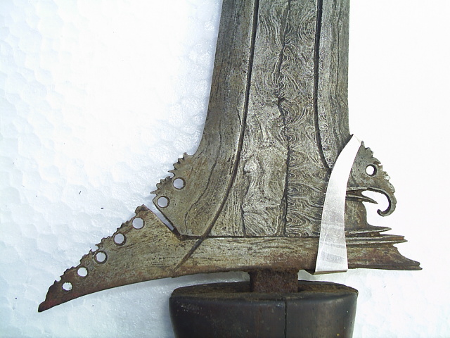

You have a true double twisted rod center piece blade versus the etched fake models of this work. Two indicators of the real work exist on your blade. One is the area of the cold shut between the two rods. The other is the fact that the twist area extends beyond the central area and into the edge area a bit. The etched pieces have a clear line of demarcation betweeen these two areas which is somtimes contained by an inlayed strip along this edge.

Posts: 940
Interesting blade Rasdan. I don't think it is as old as 18thC, but i'm no expert. I don't recall ever seeing what have been called 18thC kris with those piercings at the gangya. BTW, nice job so far on you restoration efforts, especially at the gangya where you seem to have been able to sucessfully straighten it and close the big gap on the diagonal.

Posts: 327
Great sword. I would guess that this is an example of a keris smith making a kris. Being that the blade is approx. 23", it has a rectangular tang, the holes & file work, & the 45 degree gangya; I would guess 1st half of 19thC. I have found nothing to suggest that the "Moro" of the PI ever made keris. I have found that the kris was in wide use in 18thC Celebes. With the Bugis scattering from Celebes under Dutch control, it would be hard to place its origin. I would feel confident that where ever this sword came from, that it has Bugis influence. As it seems the Bugis had a thing for 18-20" swords and the Moro perfered, for the most part, 22-24" blades; the Philippines seems to be logical. Great example, likely a cross-over between groups. It may have once had a deep etch and then polished between the fuller lines & edge. I'd toss the stirup.

Hi guys,
Thanks for your reply. However i am highly unfamiliar with this type of lamination. still re-studying articles of vikingswords etc.
Hi Mick,
What do u mean by the cold shut between the two rods? Is it the crack at the centre of the kris at the base?
Hi Nechesh,
Yes, i also thinks the the piercing style at the ganja is rather new, perhaps in the 19th C. What strikes me that this one is kindda old is that the metal that is used in this blade it seems that it is a bit "grainy". Btw, the restoration works is not done by me. It is done in Indonesia. If its by me.. i think the ganya would already be lost by now.
Hi Bill,
I think origin is the hardest part of determining the provenance of a keris especially without its propper fittings. Yes, there's a hunch in me that this a bugis origin keris, but i had no proof. What makes me think that is the style of the pamor welding and the ruggedness look of the blade and steel being used. The stirrup is new and will surely be removed when i get the piece.

Rasdan

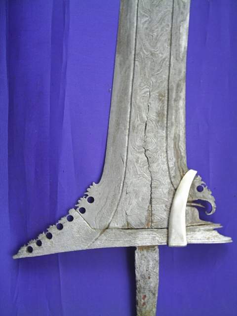

Yes that's it. This occurs when the smith had finished (he thinks) welding up the blade and then finds this fault in the weld when he begins the cutting and finishing of the blade. He removes the part of the weld that covered this fault and is faced with the choice of gong back to the forge (possibly screwing up the piece) or accepting what he has in hand. When the fault is not bad, that is structuraly unsound it is only a blemish on the final product. This will probably cause a reduction in the final price of the piece, but it is not a catastrophe such as when this fault goes all the way through the blade.
The faults on your piece do not seem to go all the way through (based on one view of the pesi) but the are pretty deep and if they were longer in llength (say twice what they are) would probably effect the use (and survival) of the piece in actual warfare.

The Moro did in fact do twist core damascus like this, but it seems to have been at an earlier period. I have noticed that as time moves toward the 20c the ability gets lost or not of intererst anymore. Also, I would tend to go with Cato in that the earlier the period, the smaller the kris becomes.

Hi Mick,
The cold shut area really makes me think again and again and again (for about one month) before purchasing this keris. But then, i thought it is not really bad (not pierced through) and perhaps it turns out to be something worth keeping (i have very little experience with this type of keris). Mainly, what intrigues me is the weld pattern and reading more literature on this type of blade welding really excites me. Thanks for your explaination.

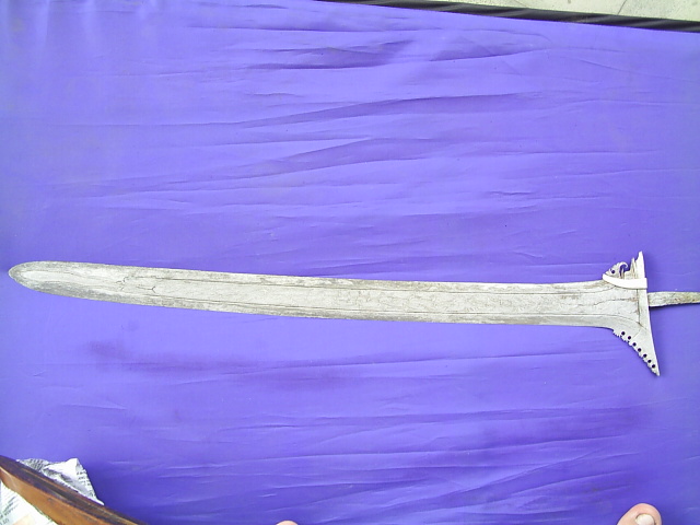

Congrats, Rasdan - that's definitely a keeper!
Just adding my 0.2 cents:
This blade looks 100% Maranao to me. I don't see anything which would indicate Tausug (much less Buginese) influence. What did I miss?
Safe of the twisted core forging, are there any hints for it being older than, say, 2nd half of 19th century?

I'm with Kai....looks Maranao to me.

I'd vote for Maranao too .
Rasdan , have you contacted Adni about having a new handle made for this piece ; surely he must know some craftsmen who are capable of doing this work .

btw I'd call it a recent copy of a Maranao type for the strange feeling that the cutting edge does not appear hardened as a real Moro kris sword and the form seems off, I could be wrong? Rasdan, can you verify that the edge holds a sharp hardened edge?

Thank you very much for the advice and offer. I really appreciate it I thought i'll first try finding an old hilt for this keris. If that did'nt work out, i'll make a new one for it.
Hi Mabagani,

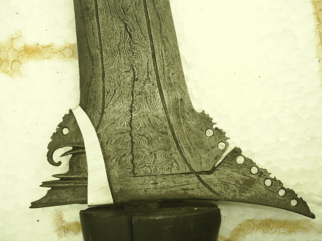

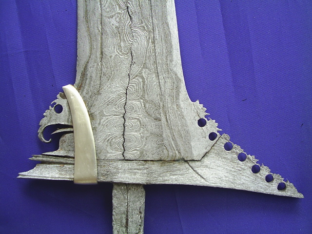

I just received the keris this morning. Its kinda different from the pics. To my relief the crack is not as huge and deep as in the pictures. Phew.. In the pictures it seems that it is made of some sort of "dry" and light metal but actually it is dense and the edges are really sharp (Its kinda heavy for its size too). Anyway, im not sure how to really tell if its hardened or not, but judging from the steel edge color, i think it is.
For the age, well.. i sure think its an old piece, not because it is mine but because of the condition of the tang. I guess if a person would wanna age a blade they'll age the entire blade and tang (or in some cases, only the blade) but, in this case, the blade is quite well preserved but the tang is really corroded by rust. Of course theres always a possibility of the forger also thinks this way and purposely age the tang, but i think it is not likely in the case due to the uneveness of the corrosion pattern.

If the sword were secure to a hilt, you could try a test cuts, it should slice cleanly like a cutting sword if its sharp and holds an edge.

I'm not sure how it is treated, but i guess with the ordinary sour coconut water. I'm afraid the pctures are the only info i have at the moment. I'll try searching in aome other literature. As for the origin etc, i metioned earlier that i lack knowledge of this weapon and my statement above is more a question than a theory. I have no idea if the theory has been discussed previously..hmm.. I probably had missed it. Btw, I think i'll give a test after this to determine if it is tempered or not. Thanks for the opinion and advice guys..
