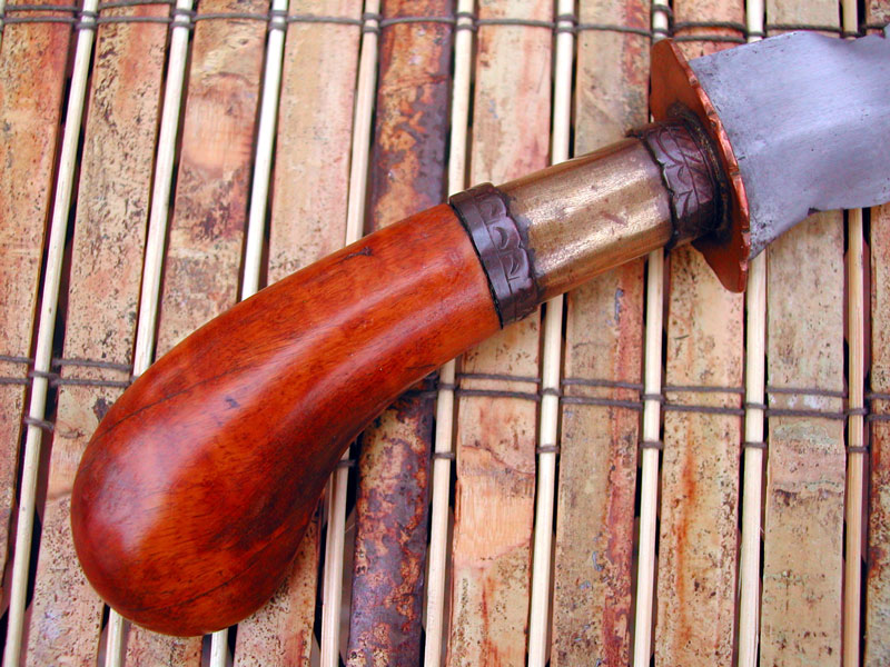

Well, the antique ethnographic bug has finally bit me and I pulled the trigger (Oh, great. ANOTHER one to bid against ) on what I think is an earlier Gunong.
http://cgi.ebay.com/ws/eBayISAPI.dll...OR%3AUS%3A1123
I'm posting this for more knowledge on these items. I'm assuming this is an earlier blade, according to how I recognize Moro Kris, but honestly the Gunong is something that I have absolutely no knowledge about (other than a casual looking over at a few older threads). Perhaps Battara, Kai, and 'Uncle Gunong' among other people can clarify some things?
The blade is a diminutive 4 7/8 inches long according to the description of the item.
What would the sheath have looked like had it been included? How old exactly is this piece? Did it originally have a guard like some of the larger and broader-bladed gunong had, or is this basically in the condition that most of these of its era was produced?
Does anyone have any more examples of gunong from around the time that this one was made?
As always, any and all comments welcome!

Hello, have watched this one also. It seems to be an older one what shows the more elongate handle. The guard seems to be missing. Look here for similar examples from Steve Ferguson: http://www.vikingsword.com/vb/showth...2&page=1&pp=30
Other more knowledgeable members will be able to tell you more.

Looks like an older one to me too. I also agree that it is missing it's guard and, of course, it's sheath, but the price was right.
Here is a link to mine which has a similarly shaped hilt. Not that my guard has been fashioned from an old Mexican silver coin. Might have been original as the coin dates from the time or a later replacement for a missing one. Might give you an idea if you choose to replace your missing one.
http://www.vikingsword.com/vb/showth...ghlight=gunong

And so it begins. As others have said, it's older and missing the guard, but it's nice.
The guard could have been oval or patterned. The scabbard would have been a simple taperd wooden one made in two halves held togeter with bands of metal or rattan. Enjoy!

I agree with the others. I would guess at 1900 or slightly earlier for the blade, the hilt may be a little a little later. Yes missing the guard but etch the blade and I'll bet there is a lamination pattern in it.
One option is a coin. Another is to have someone make a guard with okir out of silver, copper, or brass with a scabbard to match.
