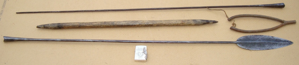

A recent local buy. In fact I got 2 of them almost identical to each other.
As you can see they resemble Masai in construction but are much more slender. The shaft of the one in the photos is, I think, a replacement. The other one is original.

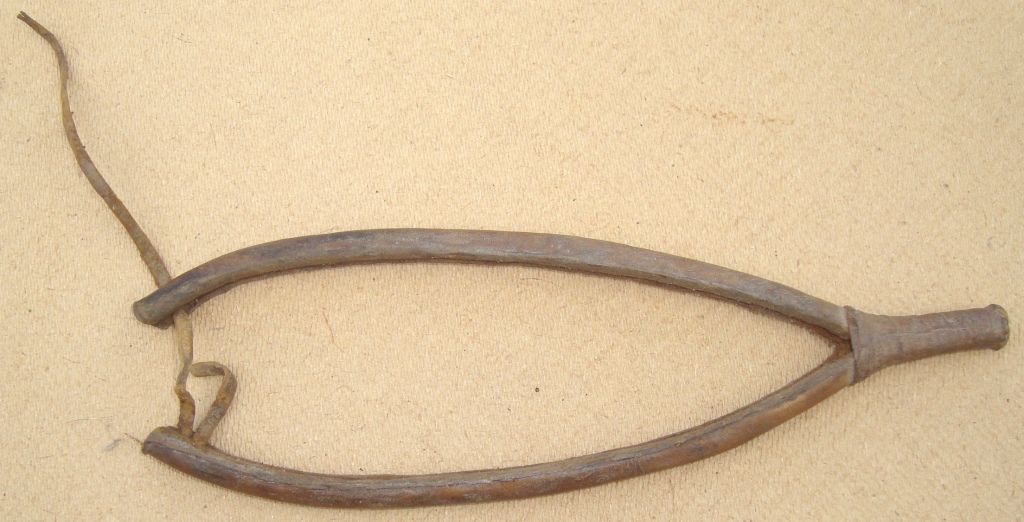

The blade guard is raw hide and very stiff. ( The only reason I photographed this one is that I cannot get the guard off the other, it is currently soaking in leather oil )
They are approximately 8 1/2 feet long when assembled !!
So, can anyone identify them for me please ?
Thanks

Uneducated guess... samburu?

I've seen these referred to as Maasai elders' spears. I don't have a good reference, but if I recall correctly they are apparently intended for cattle guarding duty, rather than the lion spears, which are reserved for the hunt.
Hopefully someone else can chime in.
Your example looks to have some age, although the forging quality is a bit rougher than what I would expect in a 19th century example. I seem to recall that in Maasai pieces a decline in quality is often attributed to the British ban on blades in the 1930s (although to be 100% honest I'm not sure if the ban was on semes or spears as well).

Per Spring (1993), this is a spear of the type carried by Maasai elders. An example measuring 200 cm in overall length is pictured on p. 112. (Your example is much nicer than my own.)

I think they may be Turkana.....

What a fascinating scabbard (?).
Not uncommon on this type of spears.

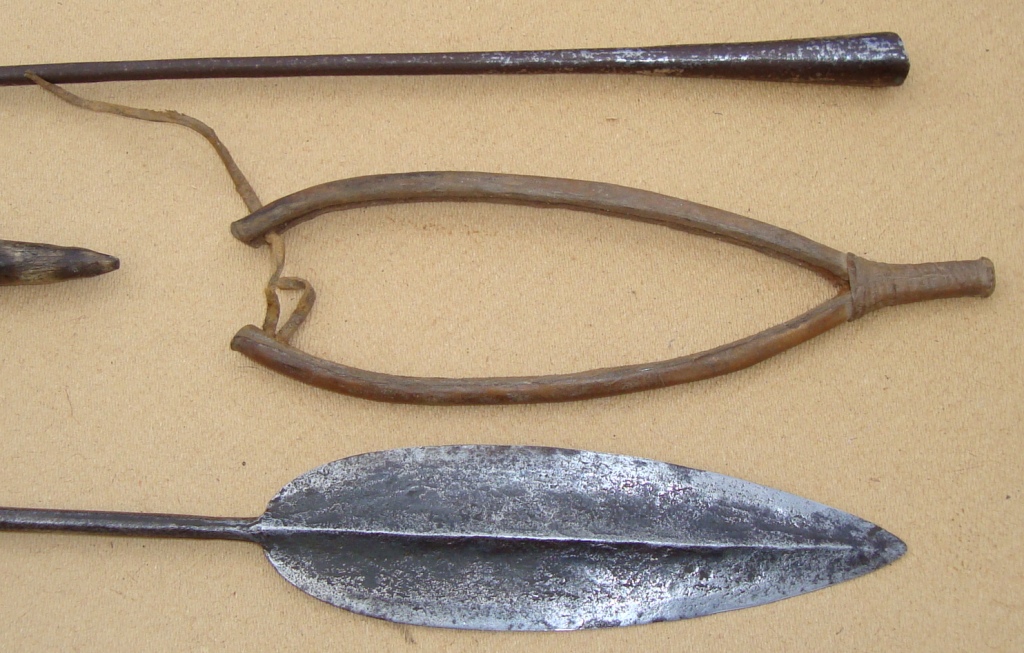

Although these spears could be Samburu, I still believe Turkana is more likely (the similarity is due to the fact these are neighbouring tribes, as they are also with the Masai) It is the blade cover that convinces me of that
Below are two links.....hover your cursor over the picture to magnify......notice the blade cover
http://anthro.amnh.org/anthropology/...F%208245%20ABC
http://anthro.amnh.org/anthropology/...F%208248%20ABC
The Samburu version tends to have a narrower blade....

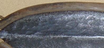

Just a simple thing really, but I like these hammer marks. Clearly intentional and how they like subtle decoration that fits the form so well.

THIS IS THE SPEAR I SAW MOST COMMONLY CARRIED BY THE MASAI IN TANZANIA. THE LION SPEAR IS NOT COMMONLY CARRIED AND IS MORE EXPENSIVE SO THIS IS THE ONE MOST COMMONLY FOUND AMONG THE MASAI. THE LEATHER COVER IS ALSO TYPICAL OF THE ONES CARRIED BY THE MASAI THERE , MY EXAMPLES ARE THE SAME BUT HAVE A LITTLE BEAD DECORATION. THE BEADS MAY HAVE BEEN PUT THERE TO MAKE THEM MORE ATTRACTIVE TO TOURISTS OR JUST LOCAL DECORATION EITHER WAY THE ONES SOLD TO TOURISTS WERE THE SAME QUALITY AS THOSE ACTUALLY IN USE. THERE ARE LIKELY MANY TRIBES WHO CARRY SIMULAR SPEARS SO MOST LIKELY ALL IDENTIFICATIONS SO FAR HAVE BEEN ACCURATE. THE ONLY WAY TO BE SURE WHICH TRIBE WOULD BE ,BUYING IT ON SITE YOURSELF OR HAVING GOOD ACCURATE PROVENANCE. LOOKS TO BE A NICE OLDER EXAMPLE CONGRADULATIONS.

My knowledge on this area is also hardly comprehensive, but I think Turkano may be right. The 'scabbard' is exactly like those found on Turkano wrist knives. It is made of cowhide, is it? Having said that, I used to see this spear and the 'lionkiller' spear frequently in Johannesburg flea markets, identified as 'masai'. However, I never once saw them with the thong scabbard.

Just to add to this thread. I recently acquired a similar spear that originated from Kenya. The seller, had lived in Kenya for some years (during the '60's) and had actually been hunting (spears) with some of the local tribes. It seems that many tribes in the area obtain weapons from several 'blacksmiths' scattered in the region, so ID'ing spears to a specific tribe is impossible.
This probably helps to explain why these and the 'lion' spears are common to the area.....rather than a specific tribe. The 'slight' differences between 'identical' spears being the blacksmith's manufacturing rather than tribal variation.
