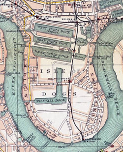

It seems clear of course that this cutlass belonged to the WIDC, the West India Docks Company at the port of London. These docks were installed to receive all produce and goods from the West Indies trade, and were begun in 1799, completed around 1808. It is known that the company employed an armed force of around 100 men equipped with muskets, pistols and swords to protect the docks and the commerce there. The West India Docks were located on the area of the port known as the Isle of Dogs.

attached map of West India Docks c.1799, and painting c.1808 of the docks
