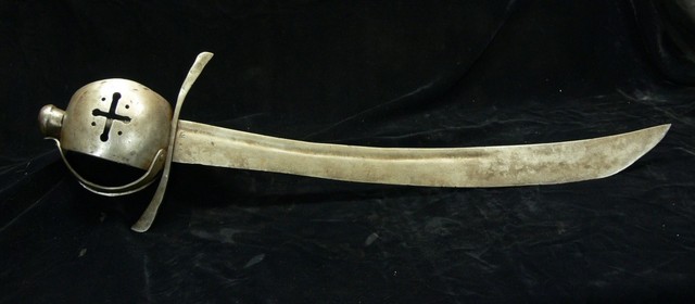

I would like to observe the sword that has been found, and consider the possibilities of whether this would be contemporary with the wreck itself or possibly if it might be collateral to the wreck site and of later date. I do not know the details of exactly the circumstances of the discovery or its location in the site grids, but wanted to extend some observations for discussion.
We can be reasonably certain this is not 'Blackbeards sword' specifically, as it was found at a location where he and his men were abandoning the ship and dispersing. It was not a battle site, nor was the departure a hastily occuring event. It would seem the many cannon left behind were of much heavier bore (24 pounders) and likely the only ones taken were smaller to the smaller ship Adventure. There were however it seems a number of firearms components found, and that seems unusual, though perhaps these may have been some unservicable weapons, it is hard to say.
With regard to the type of sword Blackbeard would have used: It would have had to be a very stout bladed weapon, indeed of 'cutlass' type, but these were often heavy bladed hangers of the 17th century. During the battle in which Blackbeard was killed, it is noted that in a blow he broke the blade of Lt. Maynards sword, again suggesting the heavier nature of the type swords favored by pirates.
The sword we are seeing from the shipwreck is indeed a 'hunting sword' or cuttoe (couteau du chasse), and the alternating quillons are of a form seen on many sword forms from earlier times as well as these. However, in my opinion, the shape of the hilt with what appears to be spirally grooved horn seems more consistant with post 1718 swords of this type. On the lower angled quillon, there is an aperture which would have been for a decorative chain connected to the pommel cap. This also is an affectation which I would associate with slightly later hunting swords, and suggestive of a weapon far too delicate for use by pirates.
The sword itself was apparantly found in pieces and reassembled for the photos, which appeared in various news releases, and I have added for benefit of discussion. Whatever the case may be, it is exciting to see a sword of any kind brought up from the deep, and it is compelling to see it found in this context.

Thank you so much for posting the article and pics of this amazing find. Istumbled upon the find a week ago and was happy to see the the wreck is still turning up more and more evidence that this is in fact the Queen Anne's Revenge.
I personally think this sword does fit nicely into the time period, but very close to the first decase of the 18th century, as many of the stag-hilted examples of hangers can be placed. Hangers of this type seem to exist from the 1660's-1740's time period, with very similar types expanding out to the early 19th century, but lacking the form of earlier models. The hilt is exactly what I expected to see based on naval accounts and records of what constituted a 'naval sword' of the time period. I doubt this was Blackbeard's side-arm, but for one of his crew, it could have. What we do know is that one of the most popular models of sea swords of the time was this form of hanger, typical hunting type piece carried by both foot soldiers and naval men of the era. Stag-hilts were the popular fashion prior to the solid brass-hilted affairs (the grotesque dragon-hilted English "Houndslow"- types were also popping up in this time period, ca 1680-1710). Short, plain hangers were perfect for the tight quarters and boarding on constricted decks. It's interesting to note that the crossguard was found several years ago and just now the hilt (experts agree they are to the same sword, however).

I agree it is really a sort of fine line in establishing the development line of these hunting swords, and the alternating quillons were a fashion that has existed on many swords forms in various cultures for years prior. I think most of my attention was on the apparant presence of decorative chain from quillon to pommel cap in lieu of knuckleguard. Obviously this suggests a much lighter type sword than the stout bladed hangers of the Hounslow and later Shotley Bridge type of the latter 17th century. Also favored were the short heavy sabres of northern Europe, often colloquially termed 'Sinclair sabres'.
It does of course seem that this type of sword would certainly have been taken up as a prize, and would serve in some degree in close quarters action on board. With that, I must admit that this weapon being found (at last! in the grid or contiguous area of this fantastic wreck site does seem to suggest that it is indeed contemporary with it.
Naturally then, this begs the question, why would this sword have been left behind? When the QAR was being careened, accounts claim she was severely damaged in both timbers and cracking the mainmast. There does seem to have been some stress among Blackbeards contingent of pirates as there were offers of pardon on the table with provisions. This has led to the suggestions that the unfortunate disabling of the QAR may have been deliberate, and that it was set to prompt the dismantling of the pirate group.
Clearly if surrender was to be the case, this might have set the tone for a kind of 'laying down arms' to enhance the reception of the governor to more lenient terms. If the demeanor of the governor proved to be deceptive, then Blackbeard would have been better set for escape in the smaller and much faster ship.
Again, considerable materials were abandoned on the QAR, which primarily were the much larger cannon (many 24 pounders) which were completely too large and too many for the smaller ship. Many of these found were actually loaded I understand. There were among many sundry personal items which would seem to parallel the kinds of debris found in settlements occupied over time, perhaps simply lost or misplaced or just scattered about. If during the unfolding of this event abandoning the larger ship, there was dissent among the crew and participants, there may have been more attention involved in the activities and possible altercations between them.
If that kind of atmosphere was the case, perhaps the crew being left were either taken away from the site, or left in anger or any manner of those kinds of upset that might deter from organized collecting of belongings. It does seem that there are a significant number of firearm components found, and that servicable firearms would not have ordinarily been left.
Again, no edged weapons of any kind have been found until now. It has been suggested also that this item might have been 'inaccessible', perhaps either stashed away and forgotten, or perhaps even fallen into the recesses of the ship deep in a hold.
What type of motif is that seen here, thankfully preserved in brass and gilt, and what is needed is comparable example on other known swords. It this an English or French sword, as both favored this type cuttoe, in a style that was well known through the 18th century, but here establishing an even provenance than I had suspected.
