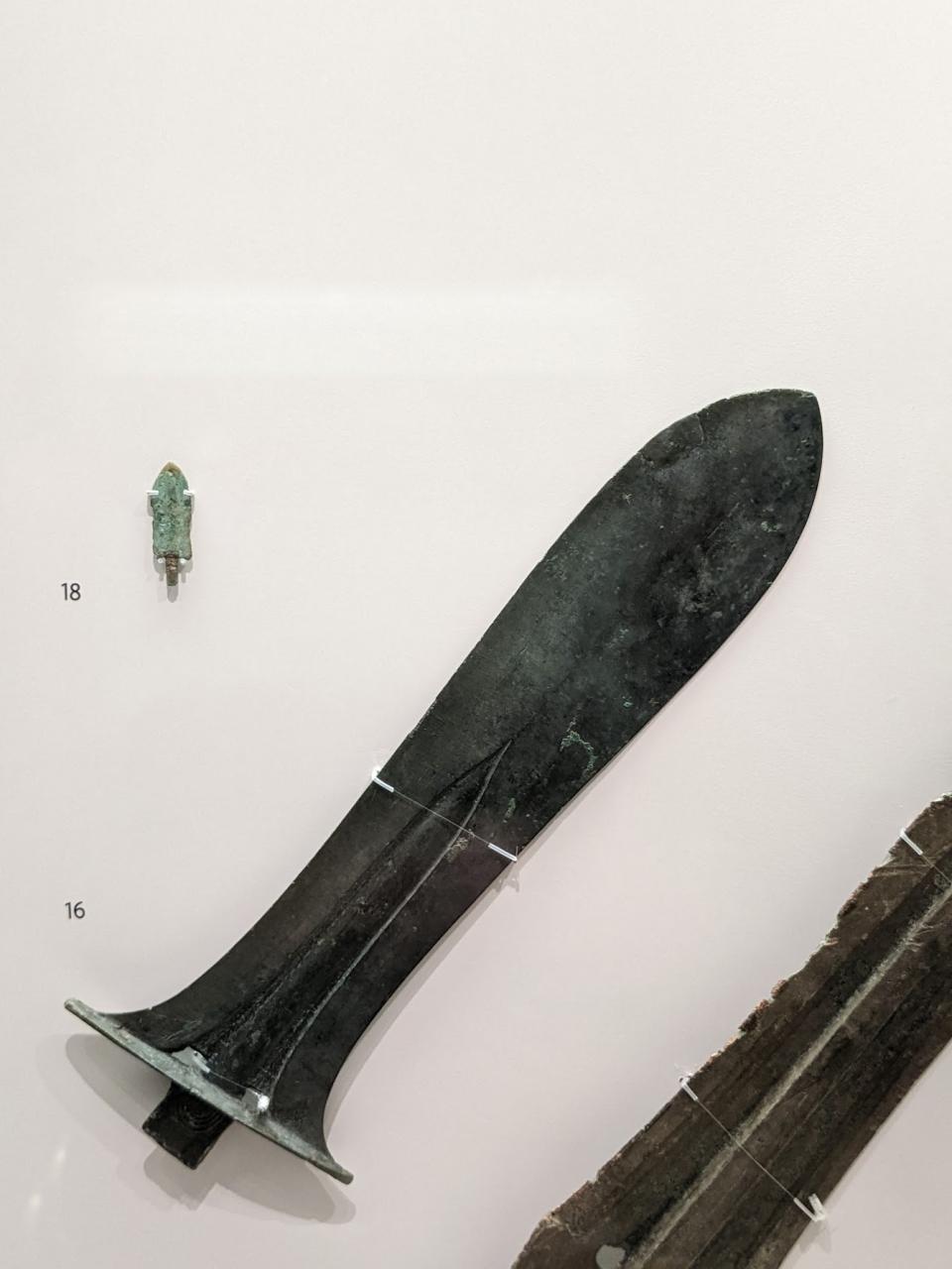

The thing that made me think of the sogokan as a fuller (function preceding form) is seeing this leaf shaped dagger at the National Museum of Korea, 2nd Century BC if my memory serves me correctly. Of course I am not suggesting that there is a connection between Korea and Java that would explain this, only that this made me wonder if the sogokan might have a functional precedent in a similar feature. This is an observation rather than an opinion, and in any case I would defer to your knowledge.

Yep, that sure looks sogokanish, this sort of thing could perhaps be the forerunner, before it became something else, maybe through Chinese influence.
Is there a date on this thing?
There was but I didn't take a photo or make a note of it, nor do they have a catalogue online that I can find it in.
In my previous post I mentioned 2nd century BCE off memory, but I'm questioning that now as it might have been from the part of the exhibition that was about the Samhan period, prior to the Three Kingdoms reaching maturity. So that would make it 1st century BCE to 4th Century CE.

Yeah, that blade looks pretty old, hundreds of years distant from the sogokan we know is perhaps stretching things a bit, but anything is possible.
