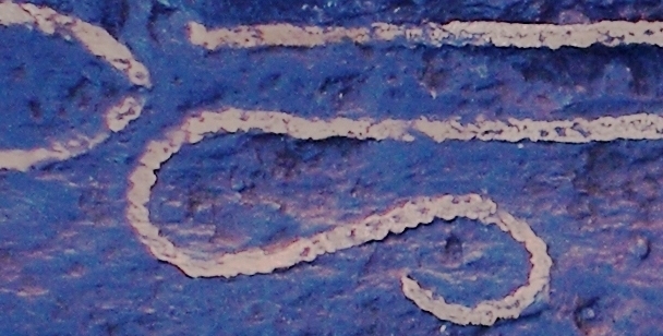

In the detail I see the gold inlay is twisted gold wire.
I note this as a point of interest only, as there have been discussions about these methods and certain aspects pointing to certain time frames.
It may or may not offer directions and there are various methods of inlay, some twisted, something that I have seen on many SEA weapons, I guess more so because that is my main area of interest, some appear only to be finely chiseled with copper, silver or gold leaf is hammered in to the cut outs to fill them, others are done over deep cross hatched Koftgari type applications.
Just a point of interest.

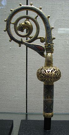

This is an excellent observation Gav, and sets me to wondering more on the way these kinds of decorative motif were emplaced. Since it is again, something I know little about, I'll hit the references and see what I can discover.
It seems that inlay of this kind is known from periods much earlier than these gold inlaid swords, and using different kinds of soft metal including copper and silver.
It is interesting to note that similar inlay is done on North African swords, I think only kaskara blades but whether the Saharan blades may have some examples is unclear.
As always, I would like to know more on these markings, and whether applied as simply motif or whether symbolism is imbued. In this case, the ellipse at the foot of the larger arrangement with parallel loops does seem to resemble the fish, of course a Christian symbol along with the cross at the tail.
On the larger grouping the looped figure may represent the bishops crozier (staff) which does occur on many medieval period blades.
These kinds of ecclesiastical symbols seem to occur frequently on medieval blades as often churches were central locations key to them. The practice of using religious symbolism and devotional inscriptions of course carried well through the ages with talismanic applications.
I also think the smaller symbol could resemble an
IChThYS, maybe combined with a Peters-cross and
as such a reference to the Pope as Peter's successor.
But on the other hand the ichthys symbols was (if at all)
not wideley in use at that time (Rome could be different).
The larger symbol could resemble a highly stylized Omega - IMHO a good symbol to put on a sword
Regarding the inlay technology: Most common
technique at that time in europe was the hammering
of thin metal wires into encarvings that had a dovetail-cross-section.
The twisted structure that you can see has IMHO nothing to do with the inlay techniqe but with the technique to produce the thin wire. The metal is hammered as thin as possible and then twisted until it has the desired thickness.
Nowadays thin wire is produced by drawing thicker wires through a die of the correct diameter.
Best Regards,
Thilo

Hello Gav
Here is a macro photo of the inlay. Seems to be made with twisted wire
I'll check as soon as possible with a digital microscope
Cesare
