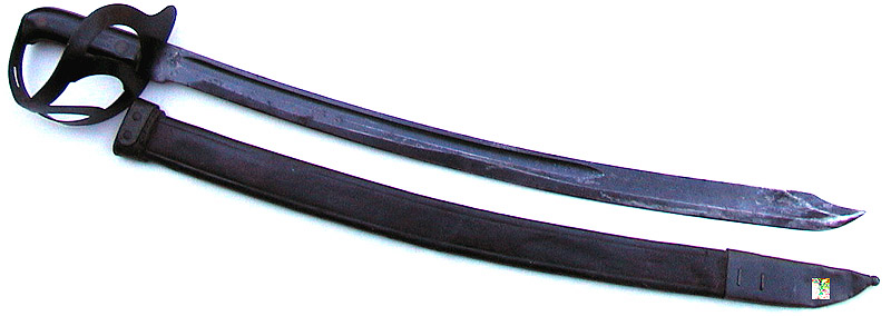

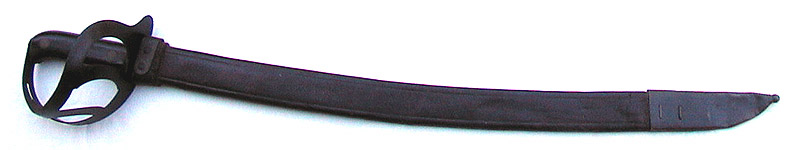

That is a US model 1917 cutlass remounted with a decorated bone handle. These swords were still standard equipment on older ships during WWII.
You can see pictures of original examples here:
http://arms2armor.com/Swords/1917var1.htm
n2s

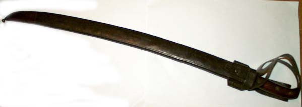

Ariel:
I had intended to post pictures of this one side-by-side with an example of the original sword from which it was derived.
The blade comes from a Dutch Colonial military saber issued in the Dutch East Indies (Indonesia) during the first half of the 20th C. I have one of these complete with scabbard and will try to post pictures over the weekend (time permitting). Edit: Actually, Rick has already posted links to pics of a Dutch "klewang" saber, and mine is identical to the pictures he linked to.
The handle appears to be a Japanese refit, perhaps WWII vintage, as suggested. I thought it was likely a souvenir collected in Indonesia by a Japanese military person during WWII.
Ian.
