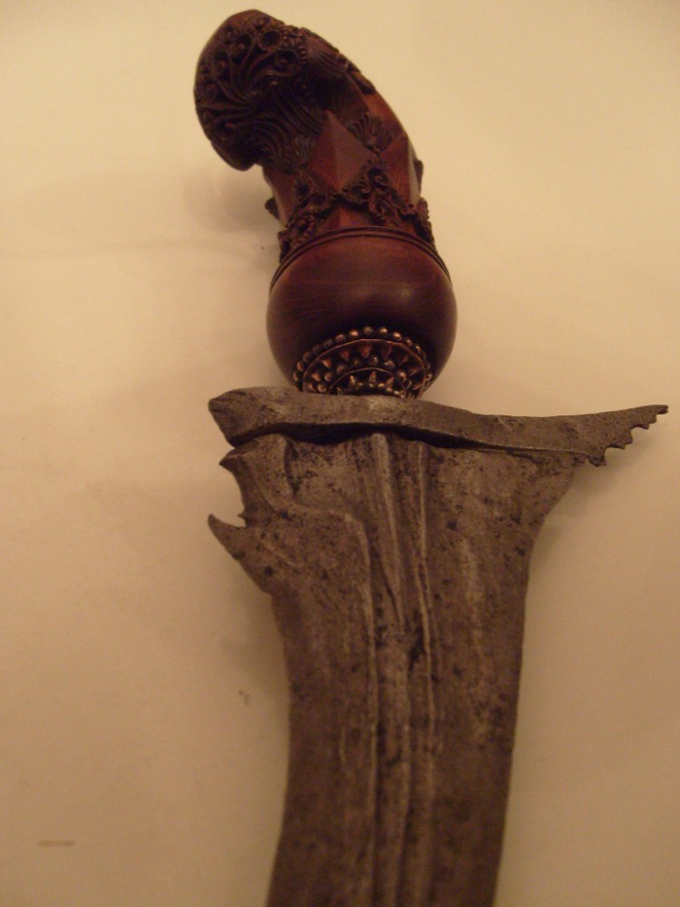

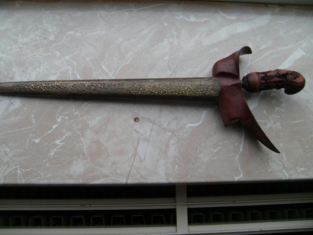

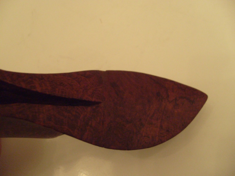

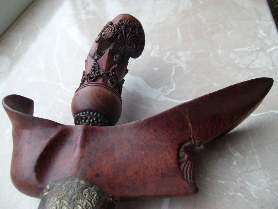

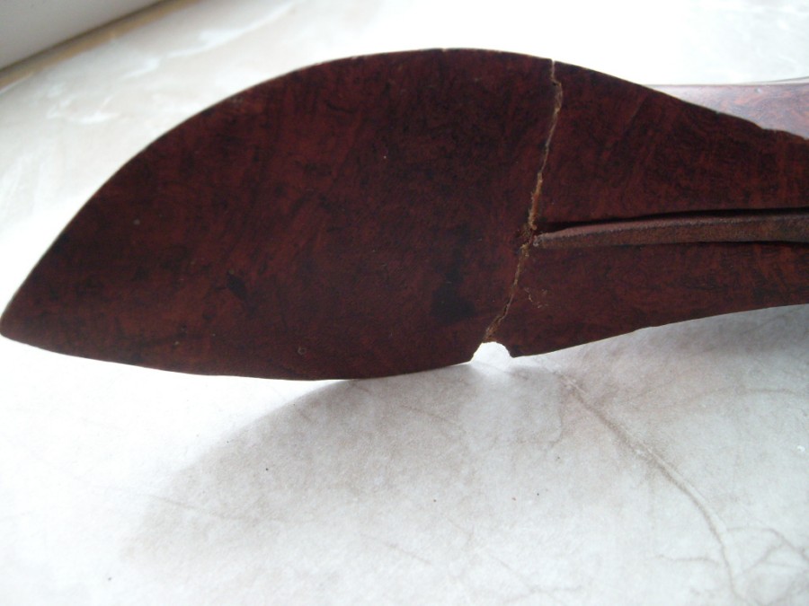

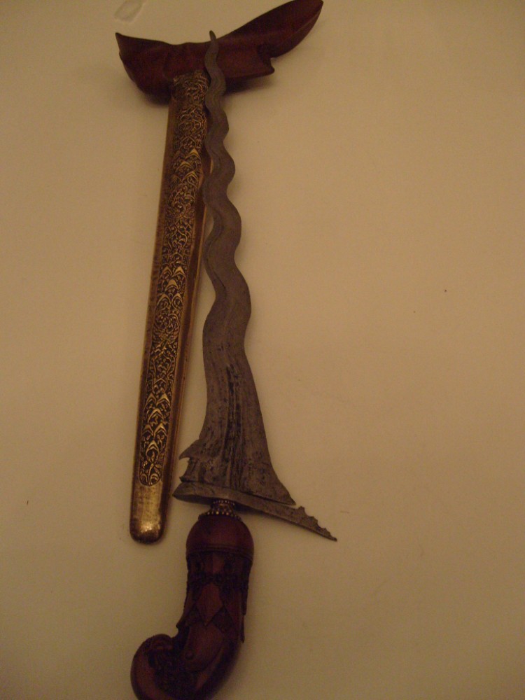

My Son has a favorite keris but the wranka is brokken , i would like to repair it . Maybe some one has a good tip to make the crack less visseble.
Can someone help me also with the wood , what is the name ?
is this a old mendhak?
The hilt is realy stuck, i did try to loose it with heating but it won,t gett loose?
Danny

Hi Danny,
This looks do-able .
You wouldn't have the missing piece would you ?
If you don't perhaps you can mix some sort of filler paste to the right colors .
Make sure you use a glue that is as dark as the wood .
The rest is care and patience .

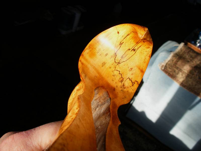

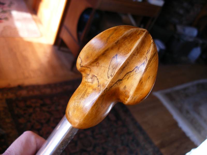

Here's a repair I made after a stupid mistake .
Fortunately I had most of the pieces .
My glue was a bit dark ..

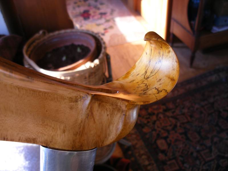

I have done exactly this repair, and others that have been of a similar nature.I used 5 minute Araldite mixed with burnt umber powder where I had to hold the pieces in place. Where I did not have to hold the pieces in place I used Super Strength Araldite with burnt umber powder.
This wrongko has already been glued together, to get it apart I suggest wrapping the glued section in damp cloths until the existing glue joint will separate, then meticulously clean out all the old glue from the joint and wait until the wood is completely dry before remating the break and glueing it. Overfill the joint with glue and clean off and repolish when everything has been repaired.
The gap in the edge can be filled with plastic putty or body filler tinted with burnt umber. You might consider reshaping the wrongko leaf a bit to reduce the size of the gap you need to fill.
The wood appears to be jati gembol (burl teak).
I have never yet found a hilt of a keris or pedang that will not let go with the application of heat. The safest heat source for somebody who has not done this before is a candle, or a small kerosene lamp. You simply heat the blade on both sides alternatively, in the area of the sorsoran, and as it gets hot you work the handle back and forth, while you grip the blade with a cloth. If it has not let go after say, thirty minutes of heating, put it aside, leave it a day or so, and repeat the process until it does let go. Even a really badly rusted in hilt will let go after three or four heat treatments. The danger is if the tang is completely rusted through, it will break when it finally lets go of the hilt. This is no big deal and any broken tang can be repaired.
Yes, the mendhak is old.

Because english is not my native languege a question abouth the damp cloth , is what u mean with it, a cloth that is heated in a steamer untill its hot ? Sorry for this strange question
This kind of wood , is it used on the older style wranka,s or the more youner one,s ?
If it is a ""tourist"" wranka i wont repair it.
About the mendak , i did try to clean it and there is a little shine maybe it will turn up as a silver one but first i have to work on the hilt to get it loose.
Danny

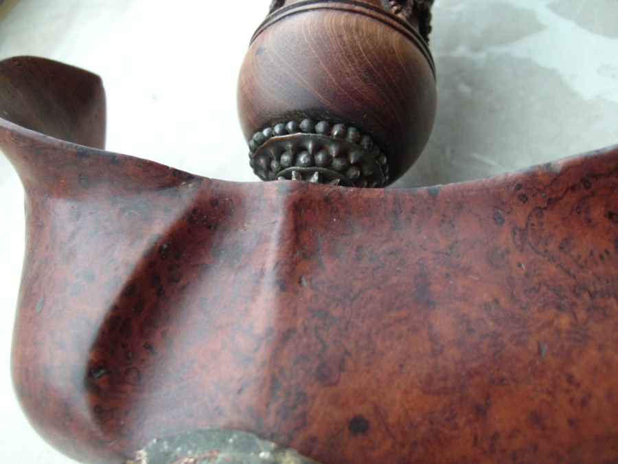

What I mean by "damp cloth" is a piece of old sheet, or pillow case, made thoroughly wet and then wrung out. During the time it is wrapped around the wrongko it will probably dry out a bit, so you need to keep it damp.It can take several days sometimes before the old glue lets go.
Jati gembol is one of the traditional wrongko woods. This wrongko is not recent nor made as a souvenir.It is a correct Madura form.However, the pendok is incorrect, the one fitted is a Jogja pendok.

Thanks for explaining the damp cloth , i was already heating up the kukusan but i can turn it off
About the pendok , yes i know its djokja but it was on the keris when i bought it i will replace it when i find a proper old madura pendok.
I also have to clean the blade but i will work on the wranka first .
But i just want to find out first if this keris was old and worthy to restorate it , i think i will give it a try.

I think you will find that you are not wasting your time with this one, Danny. It has an old Pamekesan hilt fitted, I believe you will find the blade to be C1870-1930. The Jogja pendok looks OK, and old Madura pendok are very difficult to locate, and not as standardised as Jawa pendok.

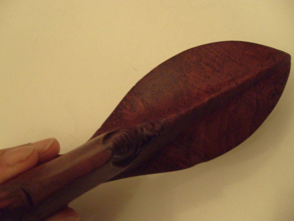

After al the tips i did get and by searching the forum is the the result.
It,s not a prof restore , but for a first try i.m not unsatisfied.
and i realy did enjoy to work on this keris

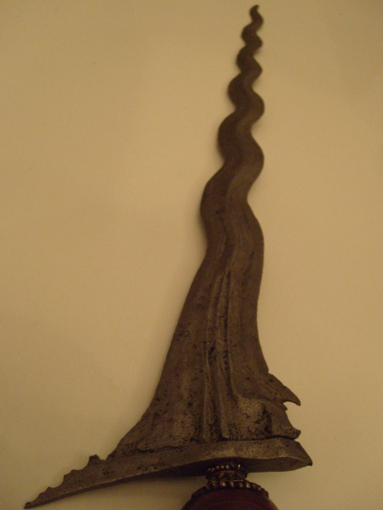

I also cleaned the blade a little .
its a 13 luk. but i need some help with the dapur and the age.and is it a mudura blade or javanese?
danny1976 is offline   Reply With Quote

That's a pretty good result Danny. Nice work.
From the pics I cannot say with any certainty what this blade might be. Sorry.
