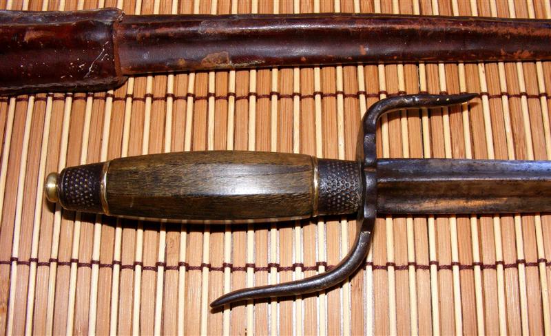

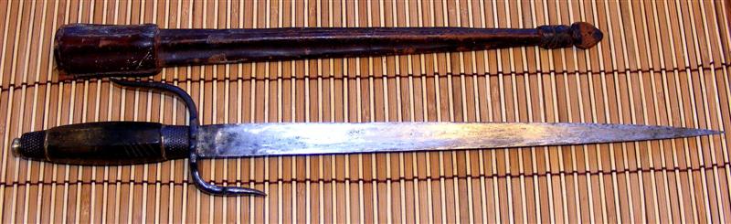

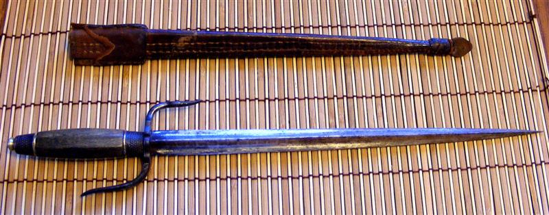

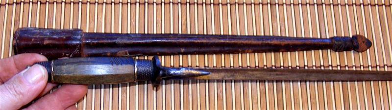

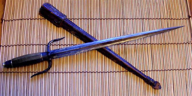

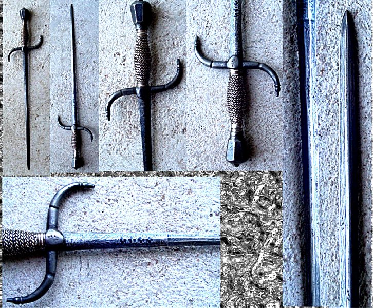

I really need help in identifying where this dagger is from. It looks Spanish Colonial to me but from where? The total length of the dagger is 17 inches. What looks to be the original leather scabbard is with the dagger (for a change) and I hope it will help in its identification. I do not have this yet and these are the only pictures of it that I have. All comments and help with this would be greatly appreciated.

Looks like those North African, Saharan blades? Spanish Sahara? There is a thread with lots of these blades which I cannot find. Love the thimbles finish to the grip.

What a nice piece Robert!
First thought was that it reminded me of the Hudiedao (have a look at Gavs impressive selection).
The scabbard is really familiar and I'm sure I've seen something similar... somewhere.......
As Tim noted, the 'thimbles' are kind of distinctive. Iron with a brass band? I've not seen ones like that before. I'd say they are a good clue for identifying the place of manufacture (thimbles are quite collectable, must be a forum somewhere).
Then the handle shape looks Phillipine....
How about a fusion piece? Many Chinese immigrants worked in the clothing trade?
I absolutely love it though! It looks very well made. An extremely interesting piece.

Nice looking knife,
All guess work but I would say distinctly Philippine by form, most possibly made by one one the many Chinese traders in the regions during the Spanish occupation of the late 1800s as the guard does has a Chinese feel too it (see some of Josh's old blades too)....though I can't quite pick it, I have seen that guard somewhere before.... the blade most likely a reprofiled Spanish court sword.
I would be interested to know what you gleam from handling it when it arrives.

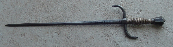

I believe this is thread Tim is referring to. I can certainly see similarities.
http://www.vikingsword.com/vb/showth...hlight=bollock

I tend to agree with Gav.; the scabbard tip looks very Philippine to me .
The use of thimbles for ferrule and pommel cap would indicate scrounged parts typical of village work .
