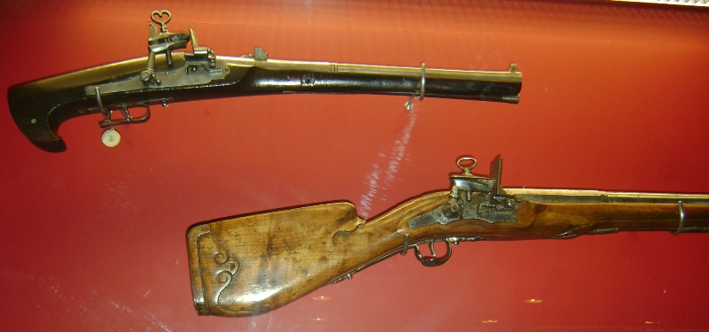

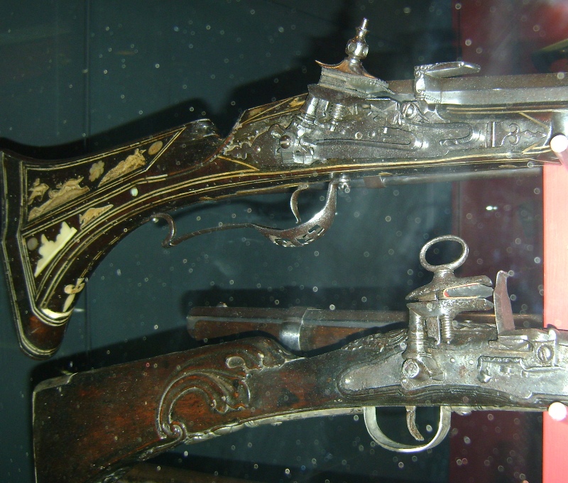

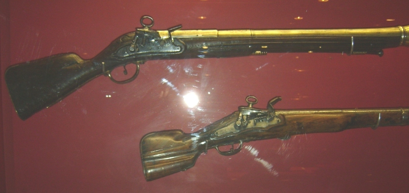

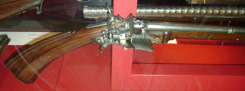

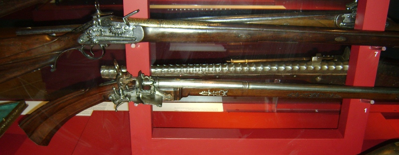

Hi Fernando and Teodor,
The four barrel matchlock gun is an 18th c. Indian piece indeed.
The others are, from top:
- pic 1: lock detail of a presumably Japanese matchlock gun
- pics 2-6, foreground: the four barreled Indian matchlock revolving gun;
background: a Portuguese type snaphaunce gun, attributed by Daehnhardt to the 16th century but probably later; I have known this gun for quite a few years and from a Hermann Historica sale in the 1980's and still have some doubts about it
- pic 7: a Portuguese type spaphauce pistol which arouses at least as many doubts as the gun discussed in the previous paragraph; and a Portuguese miquelet lock gun, late 17th century
- pics 9 and 10: a Portuguese miquelet lock hunting fowler, 18th c., and a late 16th century style Portuguese or Italian miquelet lock petronel, composite, the stock modern and of inadequate shape
- pic 11: a matchlock musket, presumably of Dutch origin, ca. 1600-20, now mounted with a Portuguese miquelet lock and Italian pierced trigger guard; and an 18th c. Portuguese miquelet lock sporting gun
- pic 12: a composite Dutch or English late 17th century flintlock blunderbuss with staged brass barrel, now mounted with a Portuguese snaphaunce lock; and an 18th c. Portuguese miquelet lock gun

Thank you for your expert coments.
... - pics 2-6, background: a Portuguese type snaphaunce gun, attributed by Daehnhardt to the 16th century but probably later; I have known this gun for quite a few years and from a Hermann Historica sale in the 1980's and still have some doubts about it ...
I see your point. Amazingly Daehnhardt vastly refers to this piece, in a book he wrote, as being a petronel made in the Lisbon arsenal around 1560-1580.
It is apparently equiped with a portuguese horse neck 'molinhas' lock.
... - pic 7: a Portuguese type spaphauce pistol which arouses at least as many doubts as the gun discussed in the previous paragraph...
Another one of these things . In the same book, he states that this piece, which exceptionaly keeps its original stock, is of Portuguese manufacture, end XVI century, with a 'molinhas' lock with brake, a la Portuguese. At the time of such publication this specimen was part of Col. W. Keith Neal collection.
... - pics 9 and 10: a Portuguese miquelet lock hunting fowler, 18th c., and a late 16th century style Portuguese or Italian miquelet lock petronel, composite, the stock modern and of inadequate shape ...
I am a bit lost with the info tags, as i didn't mind to picture the index numbers near the weapons and now, in some cases, i am not sure which is which; but i would say that the patilha lock fowler was made by Bamgru, a smith from Pangim, dated 1779; with a Moghul barrel with gold koftgary inlay.
The other flintlock gun would have been made in the Goa arsenal, under Italian guidance, end XVI century. The lock is the Anselmo type, with a dog-catch, the Portuguese-Singhalese manner.
