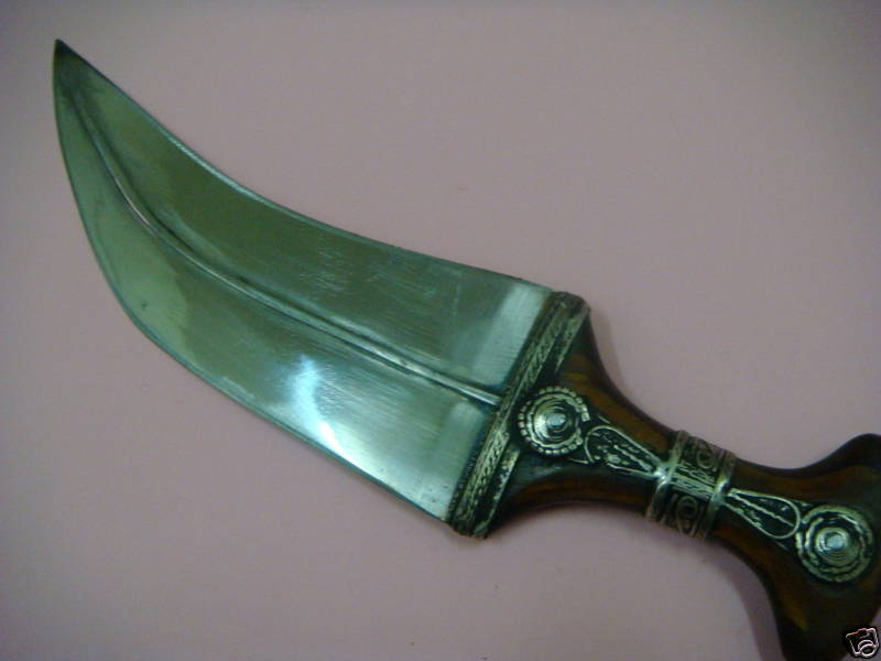

I would like some comment on the construction methods of ribbed Jambiya/Khanjar blades. I notice that a lot of these, particularly later/modern examples originating, particularly from Yemen, are constructed in two pieces, and then fused together in some manner. I personally have always regarded these as "not genuine", but simply a method of easily forging blades to attach to mass produced Jambiya. There are however some modern pieces which do have a solid blade. I have very recently taken a chance on one of these, described as having a "one piece blade", and although I do not regard it as old, it does, at a VERY cheap price, fill a small gap in my collection until I have the serious funds available to replace it with the real thing. I do not yet have it to hand, so can not really comment any further until it arrives. Pics are sellers.
Meanwhile, I would be most interested to hear comments re these two piece blades.
Regards Stuart

The rib on your new purchase is squared which to me seems two pieces pressed together.
Lew

I hoped you would reply to this, and thanks for the link to the previous thread. I see that I replied to that one at the time also, and my thoughts/cautions re Yemeni blades was expressed then. I can imagine that in a poor country, cheap methods of manufacture would prevail for the "masses" but I would still like opinions regarding the genuine-ness (if its a correct word) of these sandwich blades. Your comments in the previous thread regarding age is very helpful, and I would like to comment about a much older piece, but the Forum rules do not allow me to do this at the moment.
Sufficient to say that the piece shown in the pic, has according to the seller, a solid blade. I can only assume from that comment, that its is not two piece. When it arrives I will know more, and by then I should be able to make further comment within the rules also.

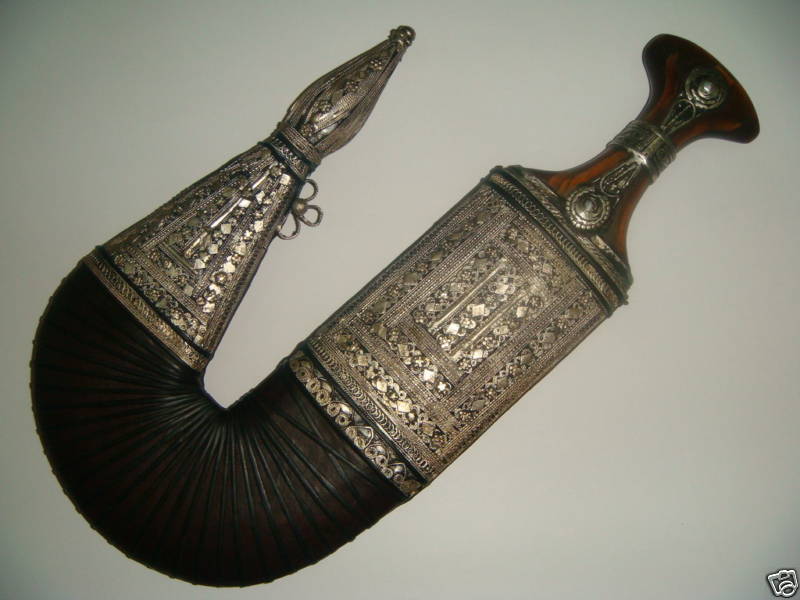

I personally do not think that square vs rounded has anything to do with the scabbard fit. Most, if not all the scabbards of Jambiyas/Khanjars I have in my collection do NOT have "fitted" scabbard centres, but are as shown in this pic: simply a curved profile on both internal sides. IF scabbards are made in bulk and mated with Jambiya at a later stage, the more important aspect would be to do with blade length, width and curvature.

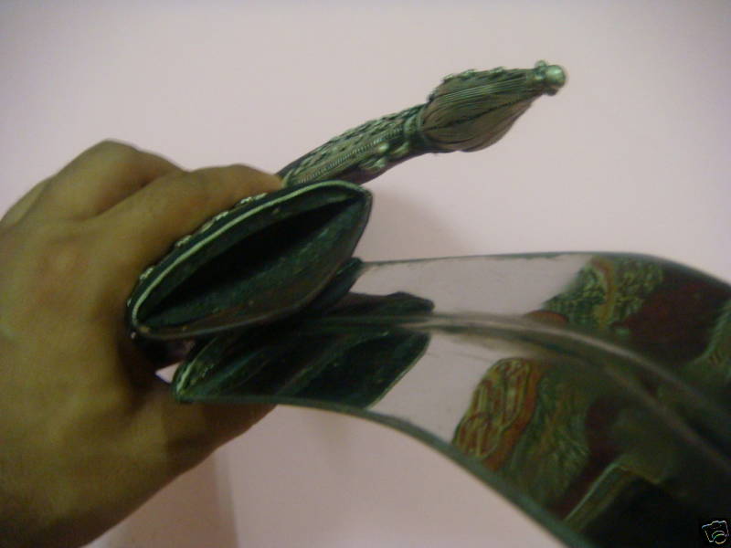

For the benefits of us who are not sure what is the meaning of two pieces blade or sandwich blade or whatever you call it, I took the liberty to show a close up of such a blade which I spared and opened the welding (It was easier than easy).
And fully opened:
I have never been to Yemen and never seen how it is being done (I wish I could but due to certain political obstacles I can not do it). But in my very humble opinion, at least the blade shown above is of very poor quality. It is made of two thin, 0.5 mm thick, galvanized iron sheet pressed in a die (see Lew comment above) and badly welded (not soldered), which make the task of splitting it open very easy. In my very humble opinion, the round rib or the squared rib is only a question of who pressed the blade on what die.
I am afraid we can not regard it as a weapon or a tool and only hardly accept it as a traditional costume artifact.

Thank you for your interesting pics, and your input. I have seen sandwich blades which are only spot welded every couple of inches along the edge.
This is usually very evident in any pics of the blades.
I think it would be fair to say that you have put my mind at rest regarding these blades being genuine or not. By "genuine" I mean a weapon blade. I will continue to avoid them.
