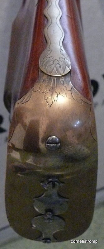

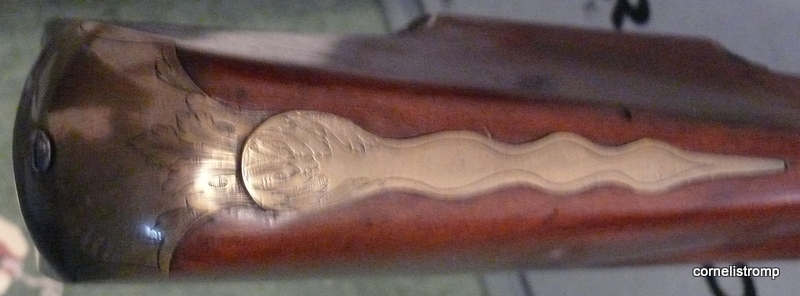

Hi,
as I recently found out it is prohibited to list arms from running auctions herewith a piece from my collection.
it comes from the arms chamber of the count of Erbach (Carl Philip) . Castle Kranichstein.
a nice detail is that the barrel and lock are probably taken from the war against the Turkish ottoman in 1683 at Vienna.
the Barrel (with damask (wootz)) and the lock are both of an extremely high quality.
the side plate is Leda and the swan.
provenance:Keith Neil nr696

Hi Cornelis,
I have to consent to Gav's lines: this is a real high quality piece indeed.
BTW, I would not call it composite; it was common use in all the old nobility arsenals (Gewehrkammern) to restock fine Oriental barrels and sometimes locks in the German manner.
I define 'composite' as composed of older parts at some later time than the working life in order to purport the impression of a homogenous piece. The stock of this piece can be dated to ca. 1740, though, which is no doubt within the 'second working life' of the iron parts.
It is highly unusual in having bone finials engraved in late 16th century style to both the forestock and the ramrod. The ramrod should consequently be equipped with a threaded iron finial on its rear end.
The style of the raised elongated and fluted muzzle section (Mündungskopf) was copied in the Oriental regions from early 16th North Italian and South German barrels. I posted photos of such in quite a few of my threads.
First class provenance as of your gun further adds to both the material and the immaterial value.
Well done, pal! Keep trackin'!

thank you Gav for your kind compliment and of course thank you Michael for
the compliments and expert comments.
may I add only one small note by the Date, the initial C on the barrel refers to Phillipp Carl, Count of Erbach. (1677-1736).
Both Keith Neil and Christies have dated this rifle Circa 1700, I presume because the shape of the (very) thick Butt and flat engraved counter plate which was in fashion at the end of the 17thC.
Thank you and best Regards

HI Michael,
thank you for the comments only one small note on the date.
this rifle was owned by Philipp Carl count of Erbach who lived between 1677-1736. I'm sure he did not use it after his dead
The rifle was dated by Keith Neil and by Christies as a late 17THC rifle.
I presume this is based of the very thick butt type and the flat engraved counter plate.
regards from Holland

Cornelistromp,
Lovely rifle!
Very high quality twisted barrel. Very nice stock, the sort of gun one has to pick up and handle!
I would have to agree with the experts, very late 17th C.
The bridle for the cock is a very effective and unusual arrangement. Altogether lovely!
Great provenance too...
Congratulations!!
Richard.

Hi Cornelis and Richard,
I beg to differ but brass mounts were not common with sporting guns in the 17th century; they were iron instead.
Moreover, late 17th and early 18th century triggers used to be broader and end in a pronounced scroll, only to name a few dating criteria.
The thick butt and butt plate were still in use well up into the 1720's-30's.
Last, as we know that the owner of the gun died in 1736 and I gave a tentative date of 'ca. 1740' I think I got quite well near the facts. The earliest possible date for the stock would in my opinion be 'ca. 1730'.
