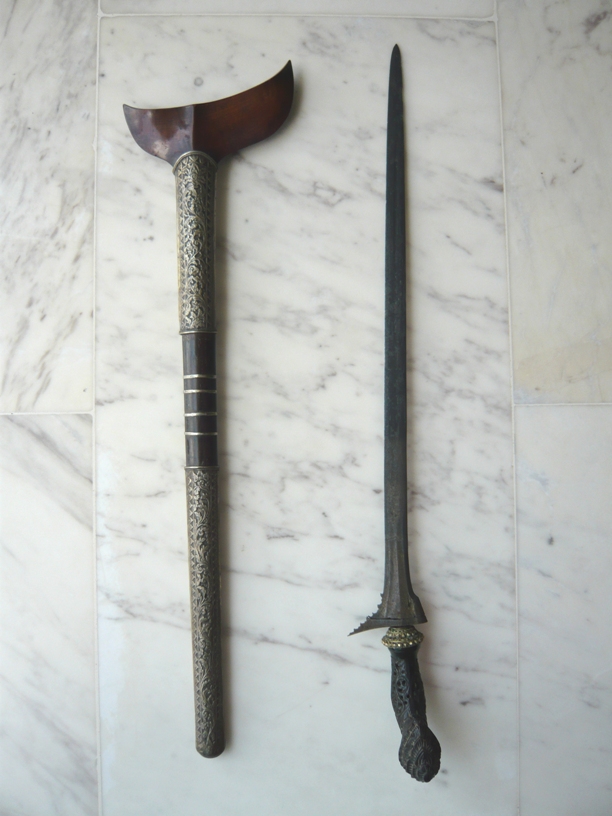

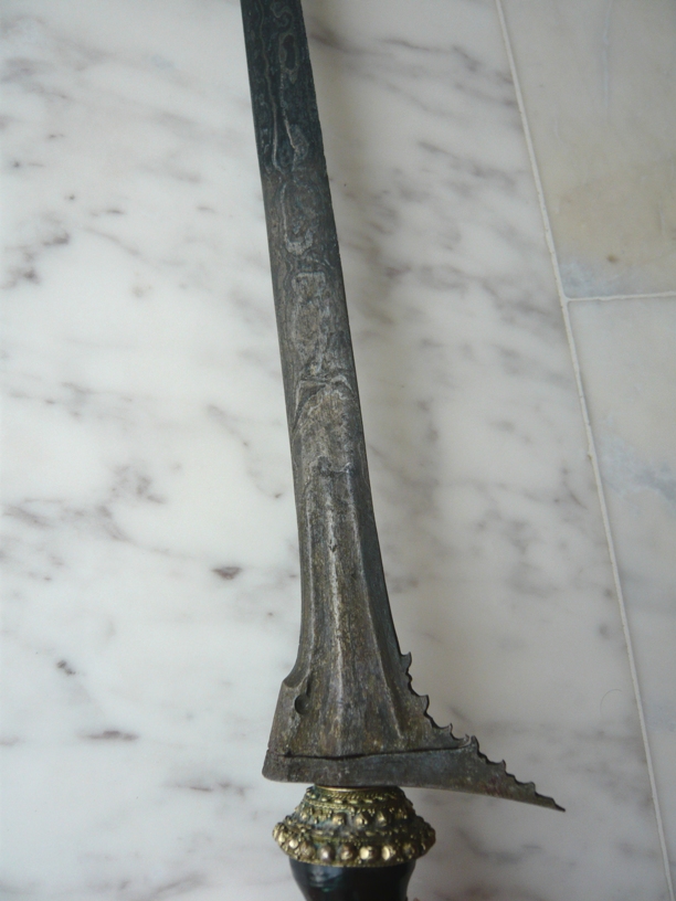

There's this thing about kerises calling their brothers. Very often, I get two kerises with some similar features within months of each other. One of such incidence was when I acquired these two keris panjang within months of each other, and both had blades made using kapit construction. If you look carefully, the base of the blade in both specimen are different material from the rest of the blade.

2nd panjang kapit.
Pls share if your panjang is of kapit construction as well.

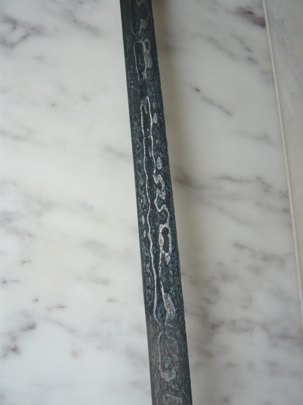

Posts: 1,180
The second panjang is a short one at 16 3/4 inches long. It has a shallow central fuller running the length of the blade, and on one side, there are very clear akhodiat lines.

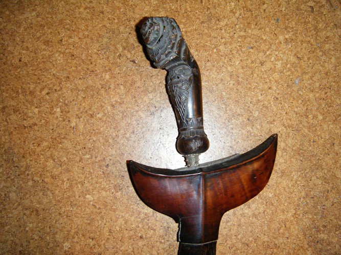

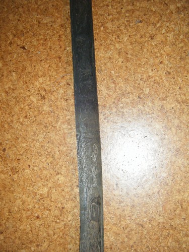

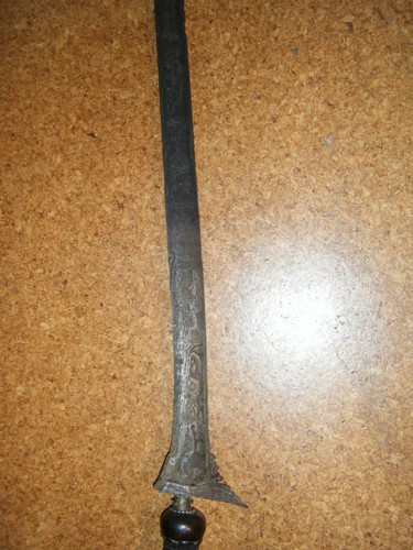

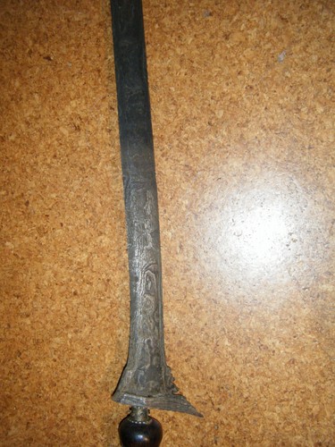

Hello Kai Wee,
here my panjang with kapit construction! Do you know what is the reason to built up a blade in this way?
BTW, two very nice panjang! And with good fitting pendokok (not like mine)

In normal-sized kerises, kapit construction could have been used to re-use the remnants of an old blade (or to repair it). In the cases of these keris panjang, I'm not quite sure really... Maybe has something to do with the length of the blade such that it is easier to add the sor-soran area as a separate chunk of metal. I really don't know.

Hi Blu Erf,
the second Panjang is really beautiful. On the first Panjang pamor on sorsoran looks like a Bintulu - mouth and one eye , or in this case better o)
Probably there must be simply more material on sorsoran becouse of thickness of blade there. Additional material could be welded on (?), if it is not something like V from beginning - the first one looks like this.
