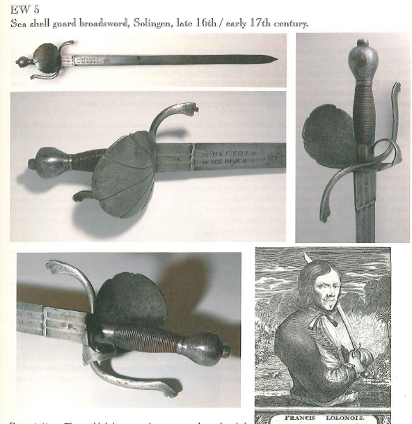

Sim Comfort has suggested that this style of sword may have a naval connection. The sword bears a strong resemblance to the ne in the early etching of the Pirate Francis Lolonois.

The book where the etching of Francis the pirate comes from, is a book in the Dutch language published in 1678 in Amsterdam.
A.O. Exquemelin
Americaensche zee-rovers
it is quite possible and also common because most artists were not sword specialists, that a Dutch sword is used from around the period in which he made the work, but Francis has never used and seen this type of sword.
on the other hand Francis was active as a pirate in the 1660, so that would match this type of sword.

The blade of EW 5 is a type of blade often used on Dutch Swords and often made by clemens Horn in Solingen

I think my example is also one that has clearly employed a Solingen blade, hence my initial thoughts in agreement with that of the previous owner is a date being late circa 1500s or early 1600s. The particular wolf mark and anchor marks support this and as suggested the hilt appears consistent with the blade. No issue with it being Dutch though, until I looked through Sim Comfort’s book I was unaware of the Dutch cutlasses with shell guards.

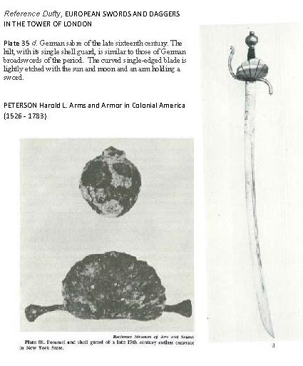

I think, when my friend (sadly now deceased so I can't ask him) originally dated this sword he used Dufty as his reference (see attached exerts from Dufty and Peterson). It certainly looks strikingly similar and has a very similar German blade. I have been looking for a reference book on early Dutch arms but all I have found in one on Firearms at this stage. I will start collecting examples for my data base and as I am currently scanning every book in my Arms and Armour library perhaps I will come across other examples in the process.
