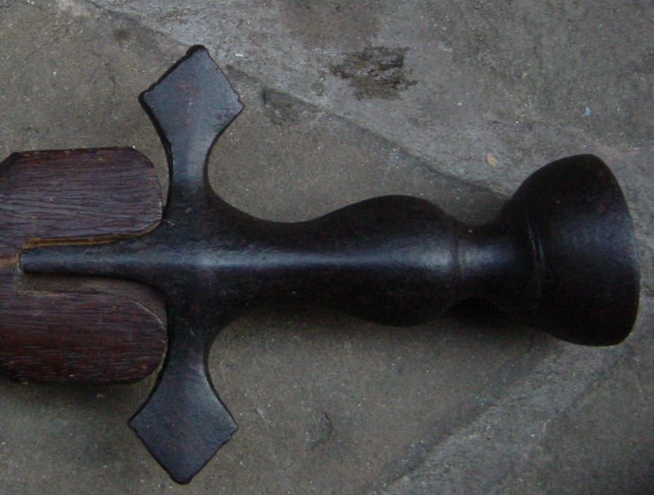

I have this piece and a few other Asian pieces that I may swap. What I like is African weapons {ceremonial/parade}, clubs, I still need a good wire covered knobkerrie. I would like a club from New Britian area, Solomans, Vanuatu. I would like one of the stone ball or disc clubs.

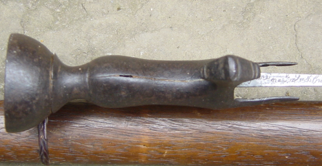

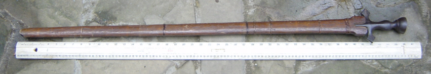

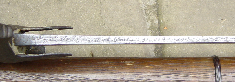

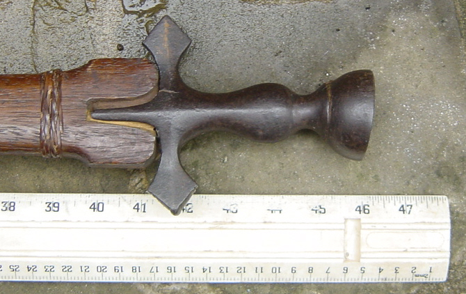

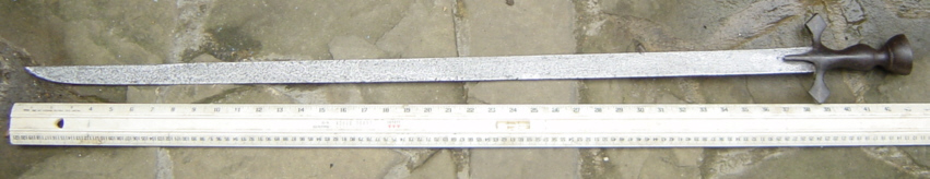

This piece is 43 inches ---- 108cm out of the scabbard. The blade is in very good condition etched showing all the pattern welded steel. The inscription relates to this period of production. 1806-10
ca . 1806 French Empire of Napoleon I
The word impériale is mentioned (Impale)
Mf ure Imp ale du Klingenthal Coulaux frères
More information can be found at this site. It was suggested to me that this form of blade is not common even for Klingenthal production.
http://users.skynet.be/euro-swords/klingenthal.htm
You can email or pm for more pictures. Sorry some of these are rather large for this site but it is a big sword.

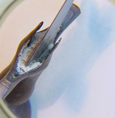

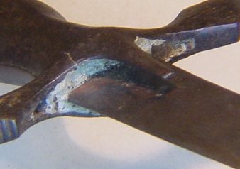

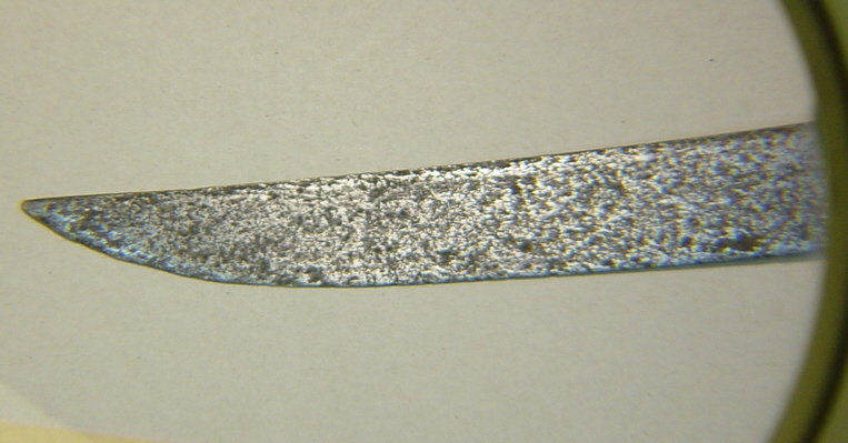

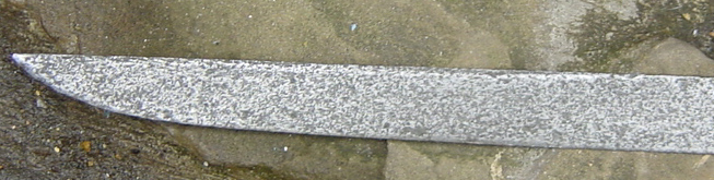

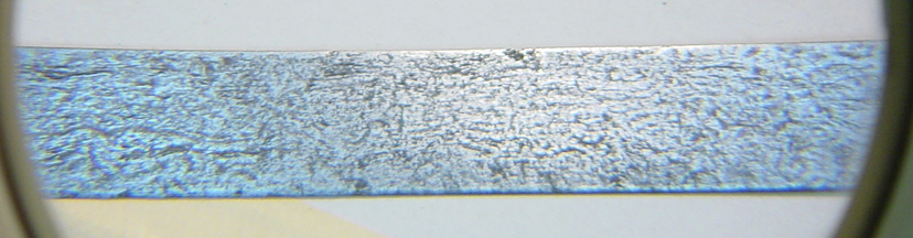

Pictures under a magnification to show the etched surface not rust pitting rather like the surface of a keris or one of those Sumartran sikim? things.

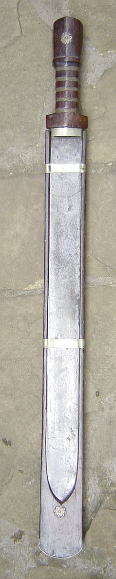

I am also think about letting the Ban go too, blade 17.5 inches or 45.5cm, heavy.

The Piso Podang has a very charming appearance. I think i do love it, but something puzzles me.

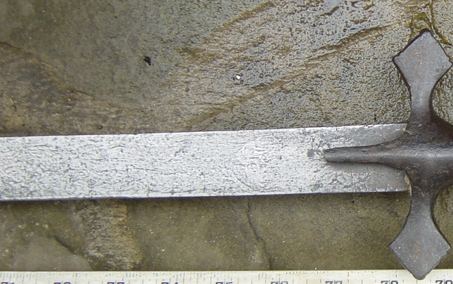

A Klingenthal blade means a French blade used for a Piso Podang. Unusual, but not a complete surprise. But a laminated blade like a keris means it should be a pamor blade. I don't think a European and in this case a French blade is forged in that way. I can hardly imagine it really is.
So the only conclusion is that the rough surface must be caused by rust pitting.

Hi Henk!

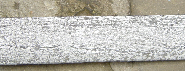

From this picture the blade seems laminated. Maybe the writing was made on a local blade after just a guess

Henk this is not really the place to talk about it but think---- Napoleon's Dutch governer sent to Bali sets up armoury. Imported pattern welded blade adapted to local tastes ie etched. All research information can be found without difficulty. To help people google "Herman Willem Daendels" for a basic history.
The blade of the Ban is laminated, I will try to show this.

Hi Tim, I suppose this isn't the right place indeed. But the Piso Podang intrigued me so much. I cann't recall you showed this piece on the forum for comment.

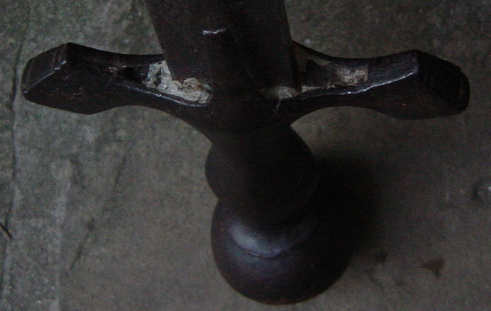

From the pictures the blade seems laminated and the writing could be done on a local blade. Completely agree. But the tip under the magnify glass shows a different pattern. More pitting in contradiction to the laminated part.
But I thank you in the first place for the education in my own Dutch history .
Herman Willem Daendels, it couldn't be more dutch, could be very likely the solution to this Piso Podang.
Old 29th March 2009, 09:12 PM   #9
Posts: 6,000

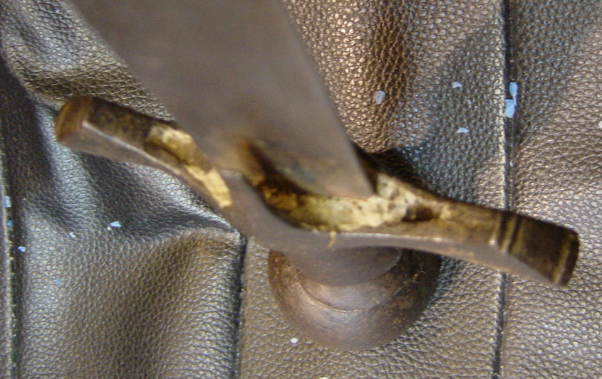

I take these pictures. The light in some pictures under the magnifying lamp make a slight blue colour. On the black leather background there is more true colour. It is a crystaline putty paste substance.

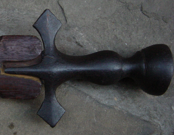

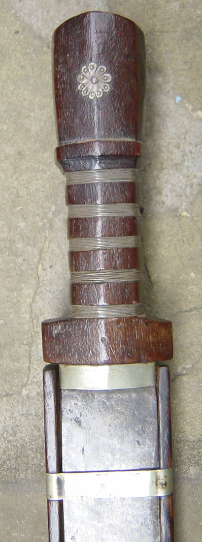

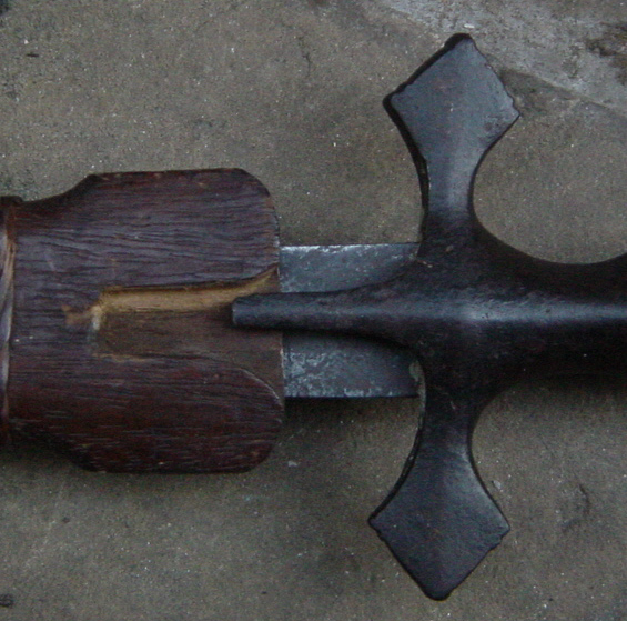

Long scabbard long blade. Blade and scabbard mouth made for each other. Carving a little rough hilt rub scabbard both sides, one side more. The hilt cup it set at a slight angle in the same way as the French handle pommel is. French blade indonesian scabbard and hilt. Most swords are made of three parts.
