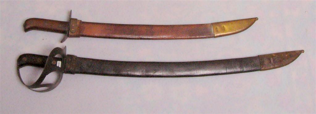

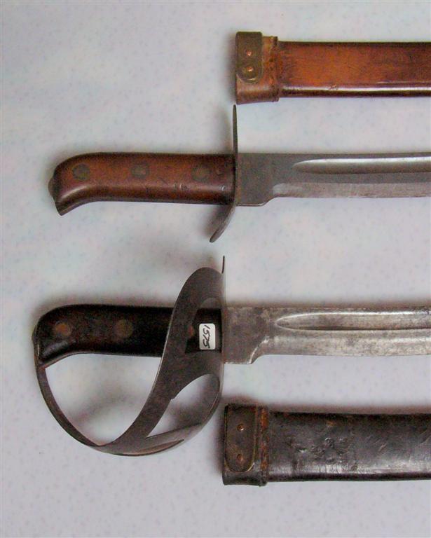

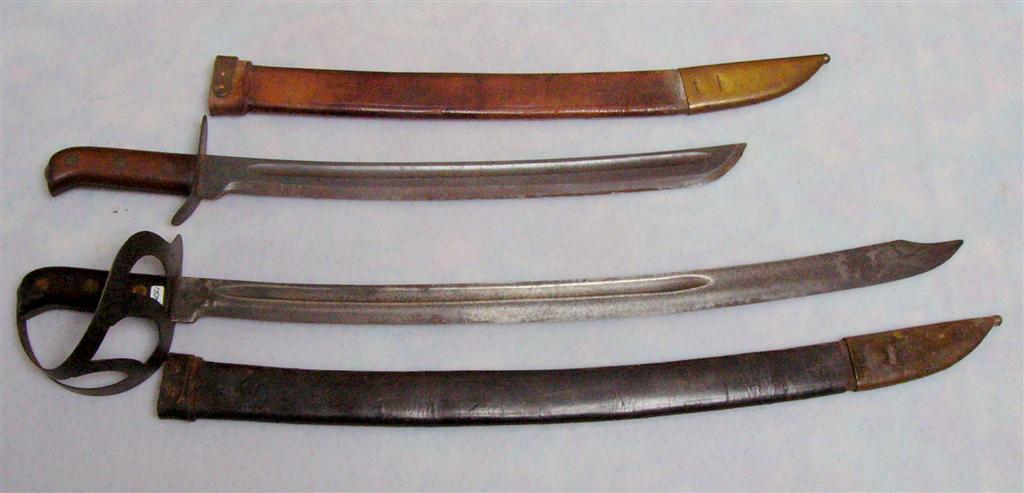

I got my modified Hembrug from UK today. Here are some pictures with a longer standard Dutch Klewang used in Aceh.
If I had not read the earlier thread, I would have thought that my "modified" klewang was made as such and not a shortened Dutch military klewang.

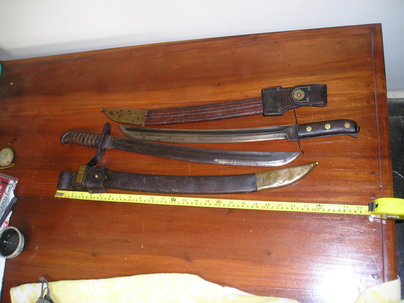

Hullo Kronckew,
Here's a start. The top blade is a cut Hembrug 'heiho', while the bottom one is a South African, 1901 German-made Hakmes. Sorry for the poor quality. Note:- handles are different; also on the South African one, the guard is longer, the fuller shorter.

Hello Amuk,
Do you have any pictures of indonesian recruits fighting for the dutch that are wearing a shortened Klewang ?
I can understand your theory about these native soldiers shortening the klewang because they were not comfortable in using it.
But if I compare a dutch klewang to an acehnese Sikin or Ladieng, I am not sure if the story about size really makes a point.
Also I wonder if the dutch army would have allowed cutting down the klewang.
These weapons where property of the army and not personal weapons.
Ps. why is the 'hakmes' you show us south african ?
Looks to me like the dutch Marechausee sabel which was the inspiration for the dutch Klewang.
