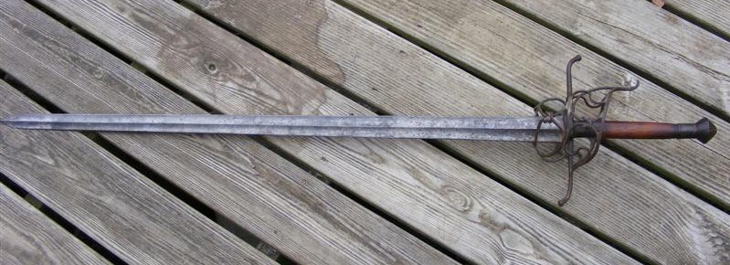

I was ask to post some pictures of this sword in another thread in the ethnographic forum but thought it would be better here. I have posted this once before but did not get any response so now that we have this forum I thought I'd try again. To begin with when I bought this it was covered in layer after layer of old aluminium or silver paint and under that alot of rust. The woman who owned this was in her 80s when I bought it had let her children use in in school plays and grand children carry it around on Halloween. The wooden grip was so dried out that I put a wood preservative on it (I hope this was not a mistake) to help keep it from getting any worse and cleaned off as much rust as I was comfortable with. Her story was that this was brought back from the Philippines after the Spanish American War with other edged weapons (including one with a long wavy blade as she described it) by her uncle but she had already sold the others when I bought this one. There is engraving on the ferrels and the pommel that look a lot like the engraving on the silver hilted Philippine dagger that I posted on the forum awhile back. The blade is what I would describe as hollow ground it 39-5/8 inches long, 3/8 inches thick at its thickest point and 1-13/16 inches wide at its widest point. The blade is not exactly what I would call sharp but not dull either. The hilt is 9-1/2 inches long and the sword weighs in at 3 lbs 5-1/2 ounces. I was told by someone that it could have been made by Ernst Schmidt. If anyone has any thoughts on this piece please post them as I have been trying to identify it for more than a couple of years with little luck. The blade is not as shiny as it looks in the pictures. Thank you for any help offered.
Robert

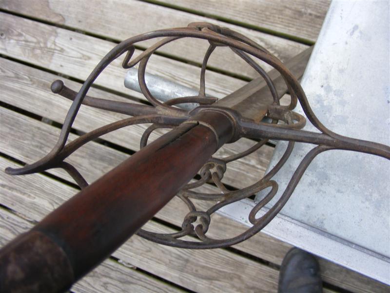

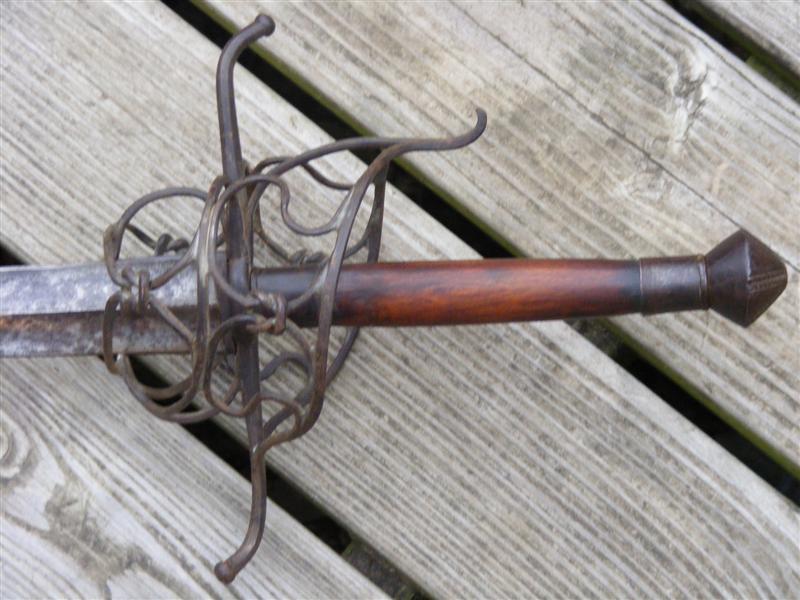

Hi Robert,
What a fine piece!
I do love these mystery pieces and the detective work that happens when one is posted.
I looked at the pictures before I read your history as I wanted a clear first impression.

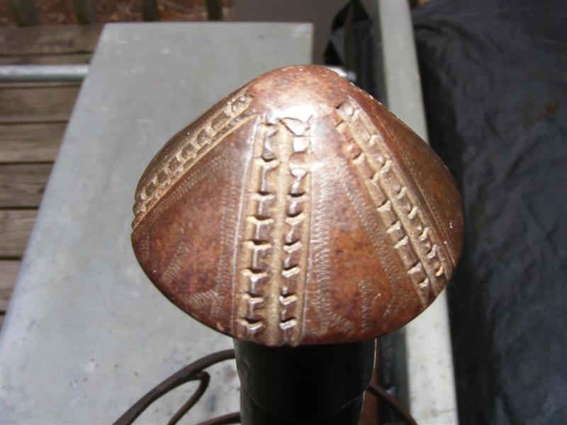

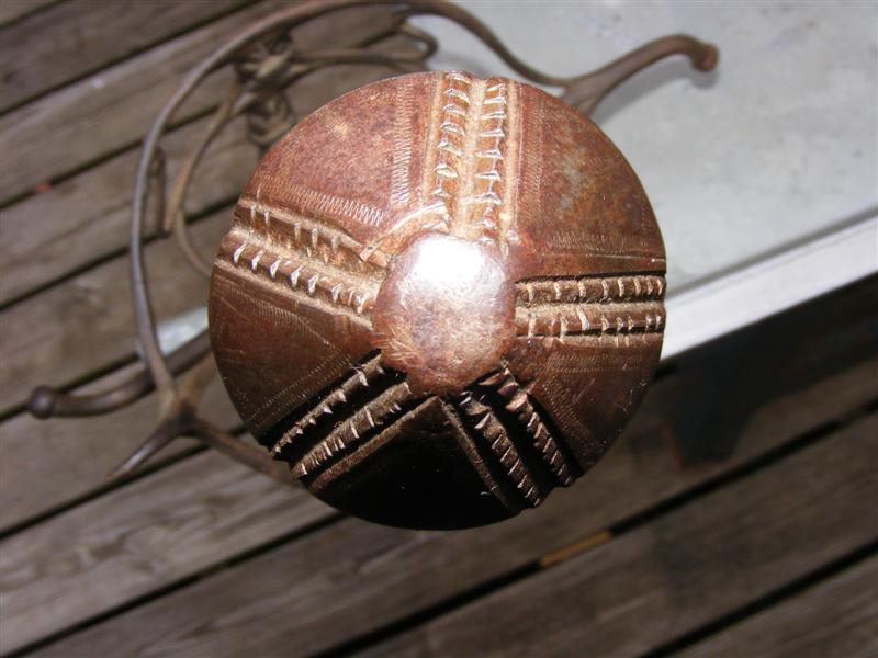

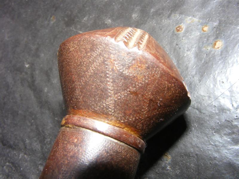

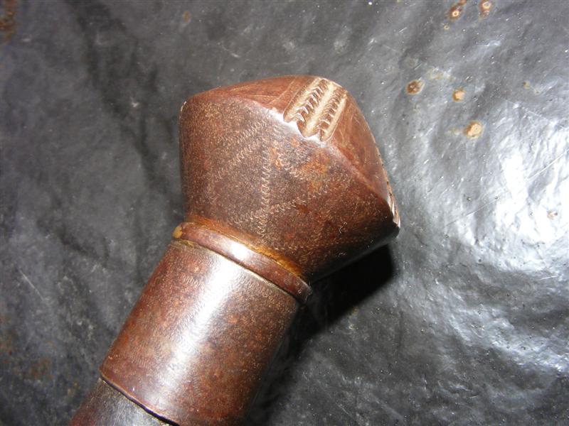

Looking at the pommel, the fine engraved wavy lines reminded me of late 18thC and 19thC items with simple mechanically added decoration. Rather an elaborate pommel, nice and big to hopefully bring the point of balance to the right place.
Big steel collar at the top of the handle? Thats a bit 'sudden' Handle seems rather on the long side, plain, wood has an age split, can't see any holes or evidence of previous wire binding?
Quillons/guard/counterguards! Hmmm, Rather elaborate and nice! Steel, difficult to work, business like and not overly fancy, but certainly attractive and stylish. Rather good, getting more interesting! Quite heavy and the 'guard' elements almost look like they are soldered to the quillons?
Blade.
Looks quite heavy, almost like it would be more at home in a basket hilt than swept.
By now I'm thinking its a fancy continental (Spanish) piece, Nice and heavy fair quality, possibly for work out in the colonies. Date... omg... I don't know. Late 18th to mid 19th?
Post 3 musketeers, pre El Zorro!
But I'm imagining a chap rather like Ricardo Montalban carrying it (from the Zorro film)
Then I read your story! So I think that fits.
How about some better pics of the blade and close ups of the hilt?
I'll be interested when the really knowledgeable members arrive to pin it down conclusively.
BTW, I love it!

I own a 18th C. swedish sword with a blade very similar to this one. Also, the center ridge and the ricasso suggest a good blade, perhaps rehilted for decoration purposes?

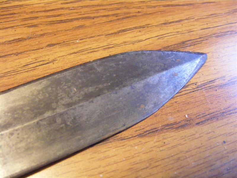

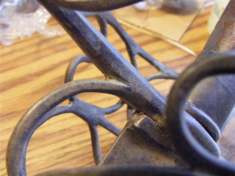

Hi Robert,

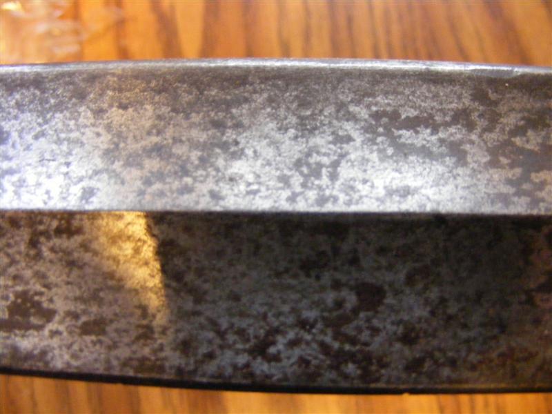

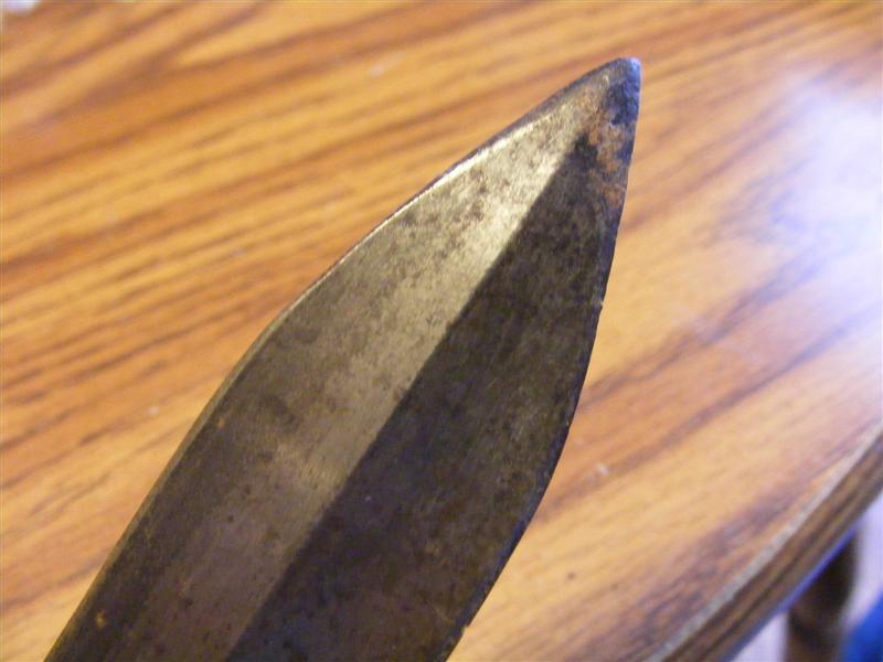

4 3/4" off of the actual crossbar quillons? Or from the bottom of the curling bars attached to them?

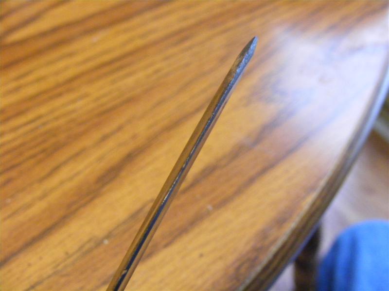

Does the blade look like its shortered? The tip is unusual (from swords I've had) having the central ridge so pronounced right to the end.
Um, pictures of the blade....
Well any marks at all, either side, top and bottom?
Perhaps Manuel can post some pics of his if it looks similar for a comparison?

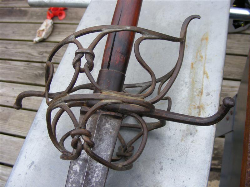

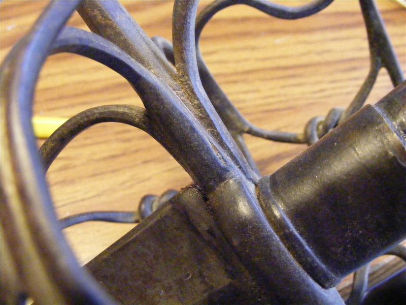

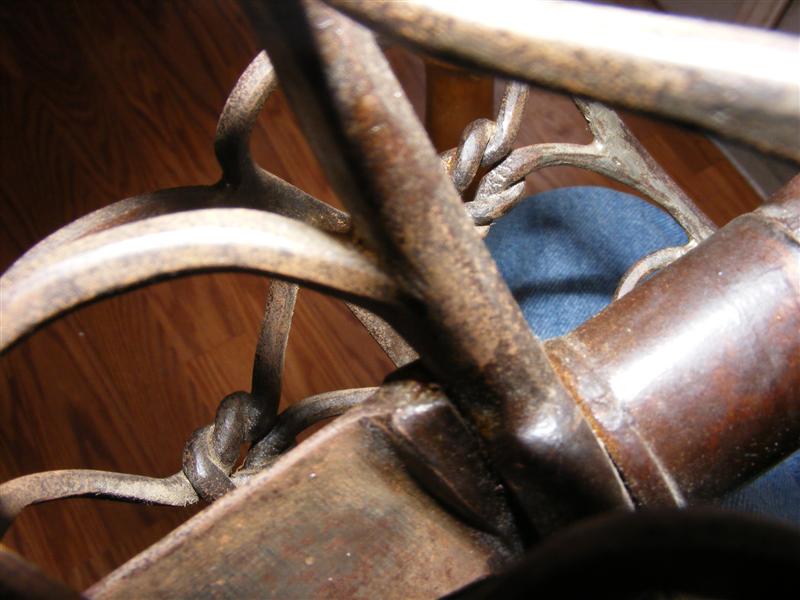

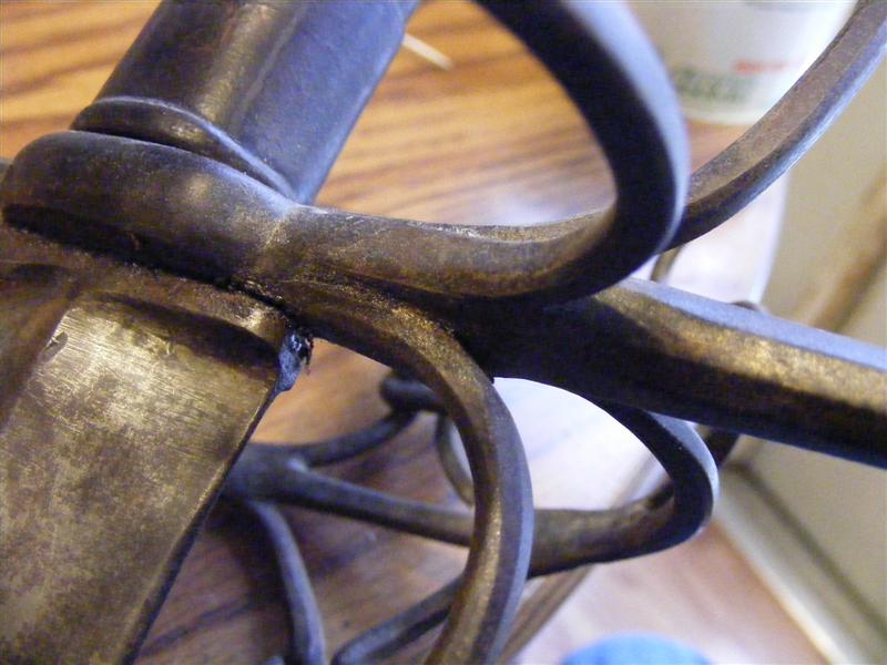

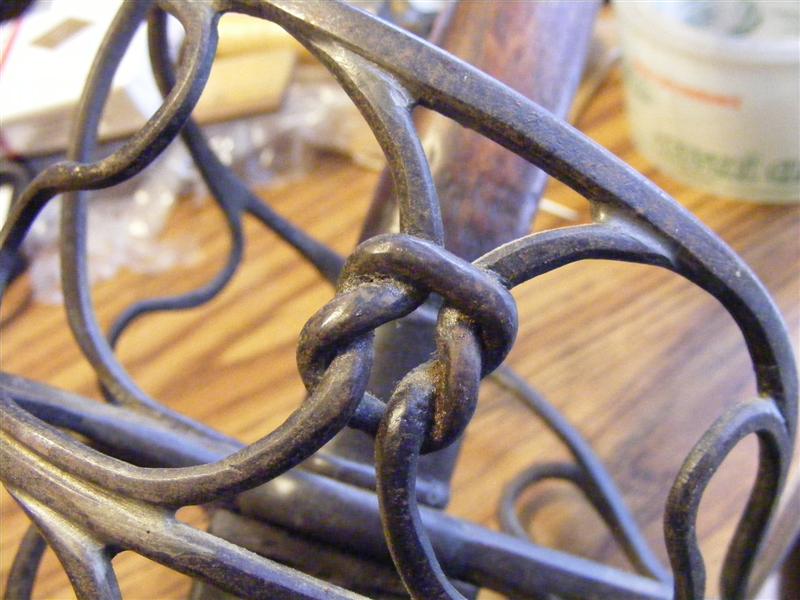

So, those bars.
A close up of a couple of the joins might be a good idea.

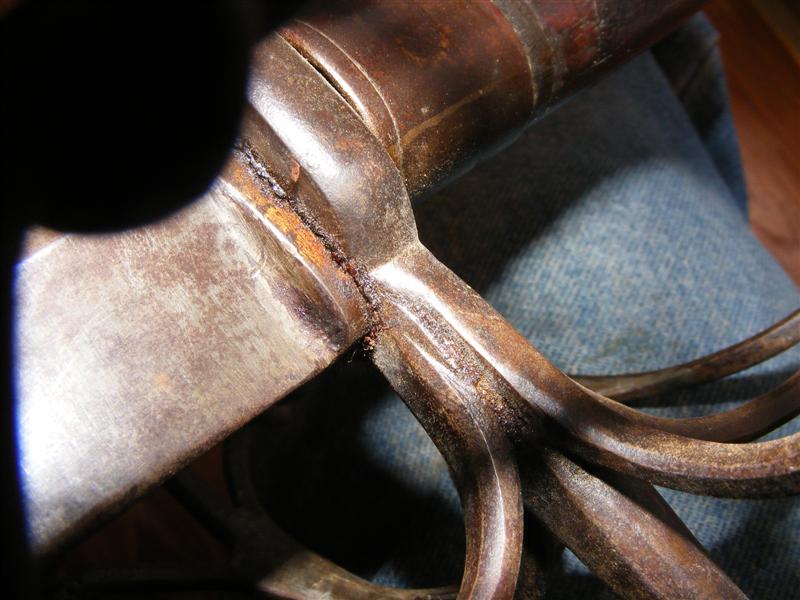

Have you had a good look to see if it is solder?
In fairness you don't really want solder on a hilt as lead is fairly soft.
But there does look like quite a lot of it! Couldn't be remains of some silvering or paint caught in the recesses that someone has put on it could it?
Gene

Hi Gene, The POB is in front of the actual crossbar quillons. I don't think that the blade has been shortened BWDIK. I will post a picture of the tip of the blade but I will have to do it inside with a flash. As far as the solder goes I don't think it is lead solder (it is way to hard) but it could be the remains of some kind of silvering. Could this be some kind of silver solder, or was silver solder even used then? Like I said it is only where the knotted sections are. The main part of the curling bars and the actual crossbar quillons and the rest are all one piece. Could the knots have been added later as decoration? I too was hoping that Manuel would post some pictures and measurements of his sword for comparison. Thanks again and I will post pictures shortly.

Well, from what is visible in the pictures, there is considerable work in those bars, and the main ones seem to be 'forged' and shaped, so it might just be that the secondary elements were attached with some kind of silver coloured braze or hard solder as the maker thought that adequate for their level of stress.
Take a couple of close ups of the bars if your can too mate.

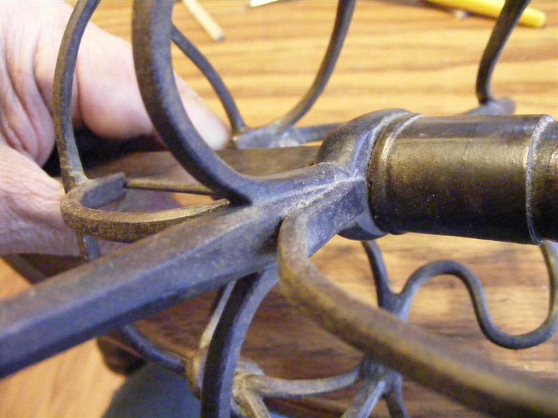

Gene, Here are the best ones I could get inside. A little picture intensive so if this is to many mods please let me know and I will delete as many as needed. These give a good idea of how the guard is put together. As I mentioned earlier the only parts that are not forged together are the knotted pieces. I made a typing error on the POB, it was supposed to be 5-3/4 inches so I double checked it and it is actually 6 inches.
Robert

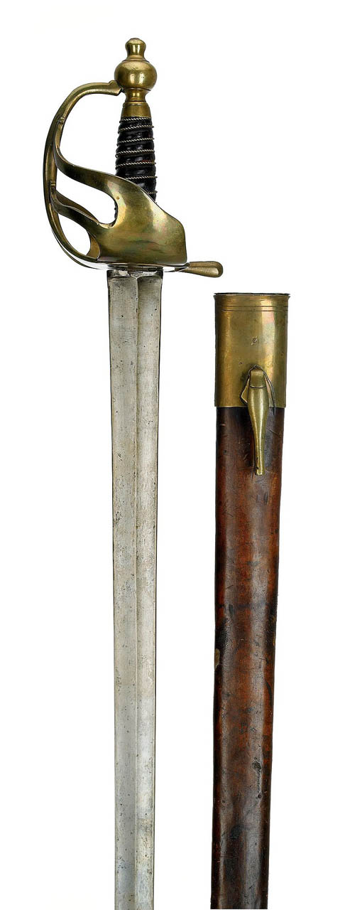

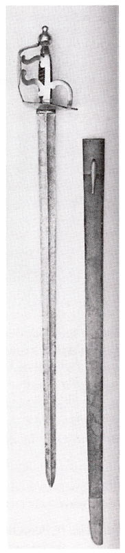

Expanding on what Manuel said, this type of blade is seen on a number of Swedish heavy cavalry swords from the 18th century (and a few cavalry swords from the early parts of said century as well). To provide some examples I'm attaching a close-up of an m/1773 (colour), and a scanned full-length shot of an m/1775 for Småland's cavalry regiment (b&w).
These two would have slightly shorter blades than Coleman's, but there are other, similar models with blades matching very well (m/1761 and m/1778 for Västgöta' cavalry regiment, and then of course there's the possibility of an officer custom-ordering something). I have pretty much no idea at all if, and then to what extent, this blade shape saw use outside of Sweden.
As for the overall package, it looks very much to me like assembled in the 19th century as a decorative.

Kisak, Thank you very much for posting the pictures of the two swords. I do agree that the blades do look strikingly similar and this could very possible be a Swedish blade . Could you please tell me where the stampings on their blades are as I have been over and over this blade with no luck finding any markings at all. If most blades of this age were marked (I supposed they were ?) maybe if I knew were to look and with better light and a magnifying glass I might be able to find something. The other thing that I'm wondering about is the length of the hilt on my sword. The sword handles very well one handed but with the length of the hilt a two handed grip is very comfortable and greatly improves how it handles. I know absolutely nothing about this type of sword so everything I say is pure speculation on my part. Another question is would they have gone to all the trouble of putting the engraving on the pommel and collars if this was just to hang on a wall? I am only asking questions to learn, I am not disputing anything that has been offered in reference to this sword as I know things were done quite differently even 50 years ago. Again I thank you for your interest and help in trying to identifying this .

Hi Robert.
Its difficult to judge these swords.
Manuel and Kisak certainly seem to have found the type of blade.
I would be very interested to see if someone can provide some exact measurements for comparison.
Its certainly an unusual combination, as the handle is unusually long but is swept hilt style and the blade is unusually heavy and of course the swept hilt was long out of favour by the 18th/19THc.
I'd be tempted to take the story you were told at face value and think its a rather strange colonial hybrid.
Its a strange one to label.
I just noticed you mention silver/aluminium paint on the hilt when you got it?
Is that whats in the crevases of the hilt bars?
One thought.
If the blade is a reuse from one of these military swords then the tang must have been extended or it doesn't go to the end of the long handle.

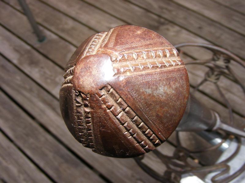

No movement on the pommel is there?

From what I can recall it wouldn't be very rare for these blades to be without stamps actually, though I've never really though about looking for stamps and such when I've seen such swords at auctions, etc, so I'm not too sure.
The length of the hilt is indeed quite a bit, if the blade comes from one of these Swedish swords, then the tang would have been lengthened as well in the process.
Regarding the handling, these heavy cavalry swords are big, sturdy things, so their blades wouldn't be entierly out of place with a two-handed grip (as we can see here). As a curiosity I'm also reminded of George Silver recommending the same blade length for one handed and two handed swords.
And as for the engravings, they could simply be there to make it sell better (decorative work on a decorative thing). If we look at "tourist" versions of the various ethnographic weapons, they are often very heavily decorated (though I assume generally decorated in ways which won't take too much time or skill to produce), to make the customers open their wallets. The same could be the case here.
kisak is offline   Reply With Quote

The POB seems a little forward on your sword, which is clearly due to the rather long and heavy blade.
You can see from Manuels small-sword, and its much narrower lighter blade, it can be offset by a much smaller handle (and shorter).
Small-swords with that type of blade were used throughout Europe, and many look very similar. I assume the heavier blade might also have become quite far-flung in its useage.
The very long handle would seem to me to have two obvious advantages: grip and offsetting that long heavy blade.
If the sword was just a rehilted older blade for decorative purposes then why worry about either factor? Why not just make it look as much like a Rapier as you can and give it a standard size handle which would look more in keeping?
But the distinctive blade and its unusual point is exactly the same as the one in Kisaks picture?
I would think that although a little point heavy still, it WAS made to use.

1. Cleaning.
I think it loks fine already, a few areas look like they need a little more but it seems generally fine. Soooo, a little more of what you've done on the darker metal of the hilt/guard probobly wont hurt. Stick with the w-wool and machine oil, Its a fairly gently way to do it.
I'd say if you are going to do it, then identify the 'solder' or whatever it is first. If its the remains of the aluminium paint you mentioned then it can come off, if its a hard solder then you'll want to be careful if you continue the cleaning so you don't flex any of the joins and crack the solder.
Whatever you decide, I would say do it by hand. Don't be tempted to have a bash with your Dremel or anything powered.
With cleaning, you can always do a little bit more if you need to, but once you clean too harshly or leave grinding marks etc it can be difficult to disguise.

I tend to think the heavy blade and long handle mean it would be best for thrusting from horseback.
The POB on your sword is a little far forward (towards the point) for a rapier, (I would expect it to be more around 4 inches from the quillon block), and the handle and size would make is a little clumsy.
From horseback I can see it being fine for it to be a little further forward 5-6 inches.
So, my 'bottom line' views.
I love it.
A little more cleaning, but dont rush it.
Handle, fine as it is, so perhaps re-wrap if you can find the perfect wire to do it but it really doesn't matter.
POB, fine.
Just my opinons

Does the glimpse of tang give any more clues?
Old 30th January 2009, 07:46 PM   #22
Robert
Robert's Avatar
Location: Centerville, Kansas
Posts: 2,196
Unfortunately no, only about 2 inches of the tang can be seen in the split. It is well patinated (rusted ) but I can see no forging seam from being extended. Not sure if that is good or bad.
Robert

Well its better than seeing a big weld
I think its a great piece! Please post more pictures if you do any cleaning or work on it.

Just wondering, were all the elements of the guards on original rapiers forged in one piece? Did they ever braze any of the pieces into place, or were they only forge welded or riveted? After looking at some of the more elaborate examples and how complicated they were it makes me wonder how they were made. Thanks.
Robert
