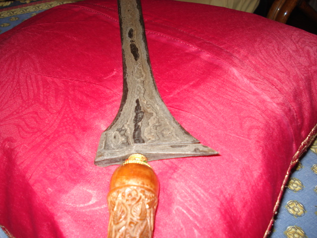

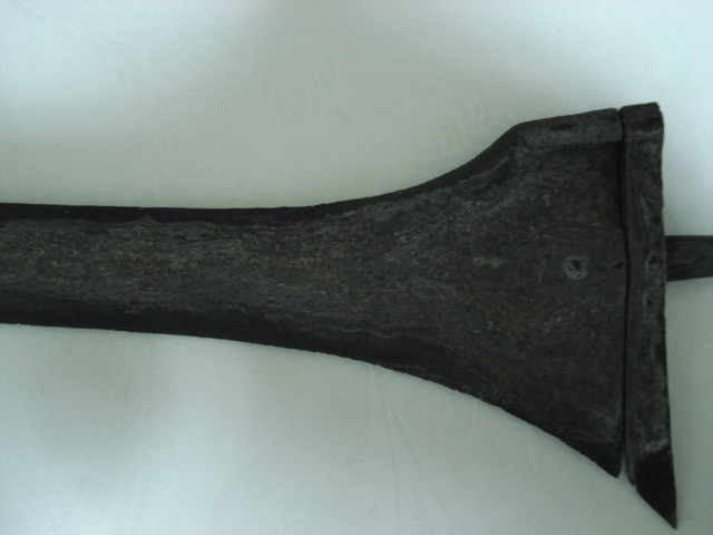

Hi dear keris lovers

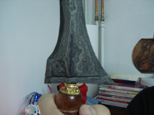

A friend of mine acquired an old keris.
However he would like to learn more about the pamor.
He has been told Madura keris, tanguh Majapahit (?), pamor Bungkus (?).
I know that the tanguh estimation is something very difficult from some photos only, what about the pamor?
Thanks in advance.

Hi everybody...

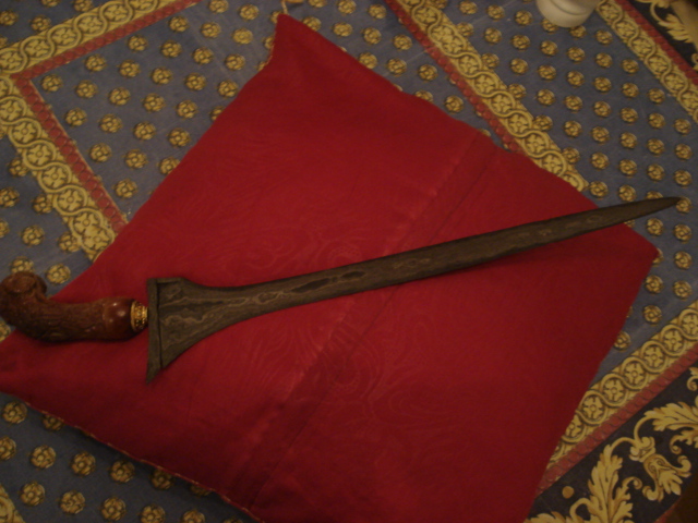

This is my first post in the forum.This keris is mine and my first.Can you give me some information about the pamor?
Yersteday i tried to clean the blade with some lime and water.I'll upload some new photos to show the difference.
Thanks in advance.
Jimmy.

Judging from the photos posted it doesn't really look like your keris really needs too much cleaning. I would just oil the blade if i were you.

Like David said, your keris needed only some oil. I really hope the lime didn't do too much damage to the etching.

Originally Posted by skalomatias
Hi everybody...
Thanks in advance.
Jimmy.
Hello welcome to the forum.
I would say that the pamor is generally pendaringan kebak (dense pamor throughout the blade) + pamor bungkus alright, resembles by the abstract shown on the first picture-on the bottom center of the blade.

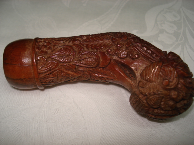

I'm not going far into tangguh as it is beyond my understanding, but it seems like you have a 20c keris there (probably I'm wrong). Hilt looks Madurese but not very clear, what is it made of? Maybe you want to post the picture of the sheath sometime. The hilt ring (mendak) looks Javanese. Dapur (blade shape/style) might be Tilam Upih.

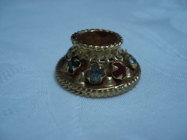

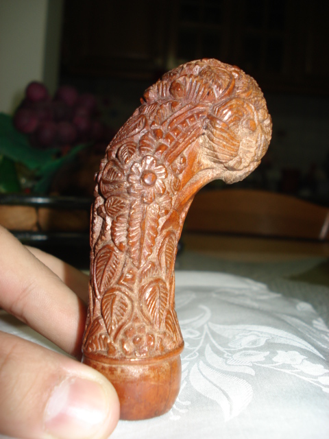

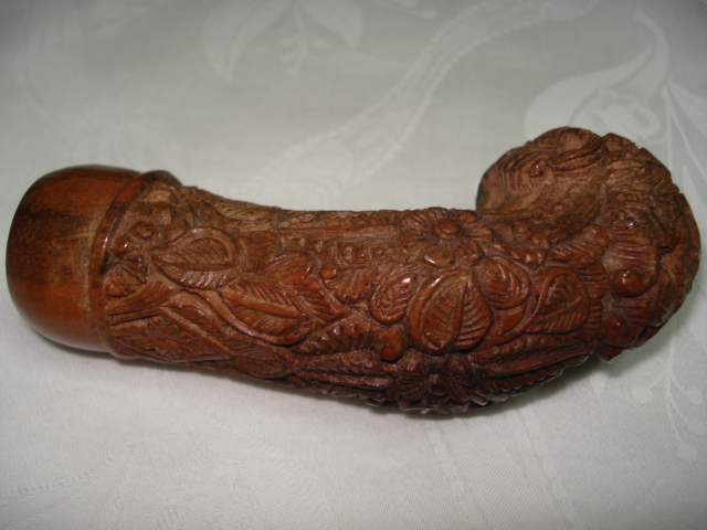

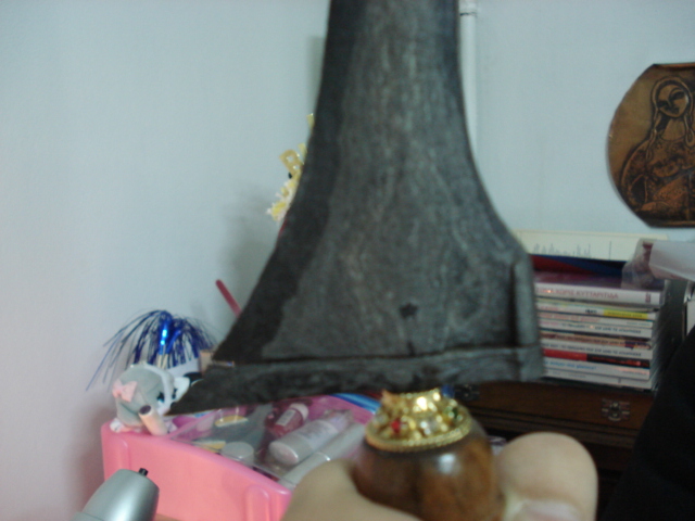

Thanks for your answers.
Some photos of the hilt.
skalomatias is offline   Reply With Quote
Old 21st December 2008, 12:55 AM   #8
skalomatias
Join Date: Jun 2008
Posts: 7

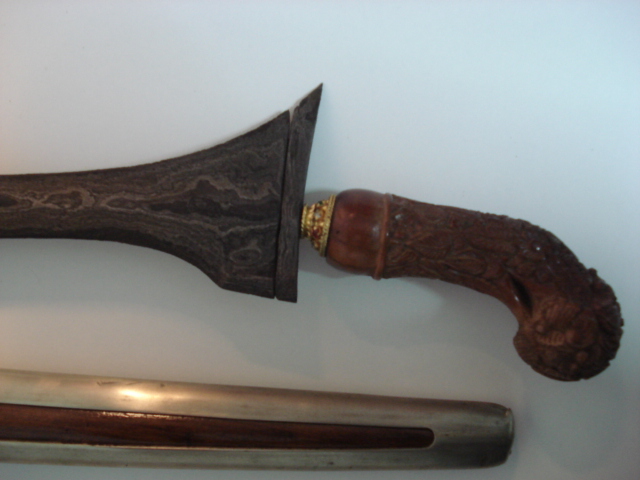

and the hilt ring.(I think it's very new.)

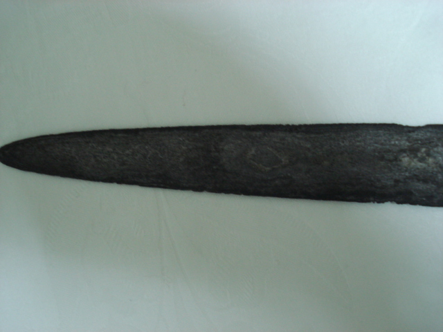

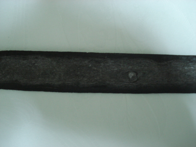

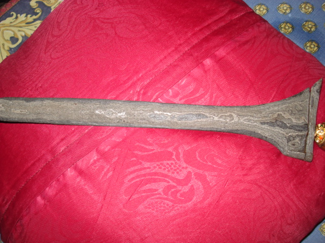

and some photos after some cleaning.
firts side of sorsoran

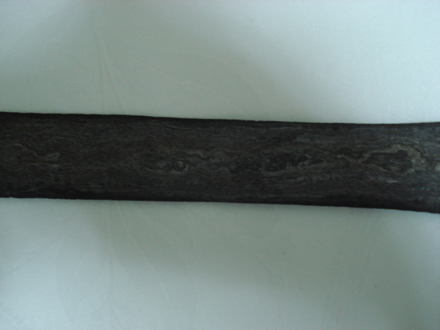

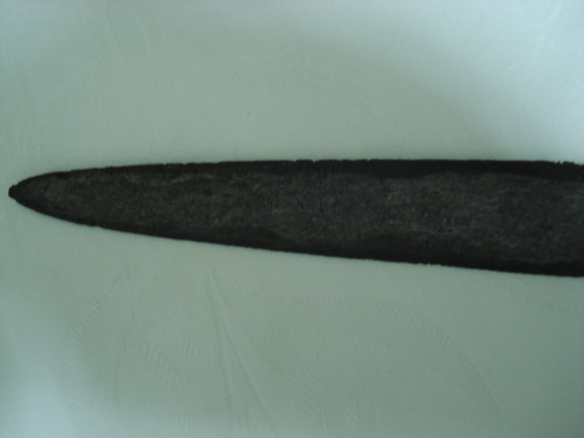

Posts: 7

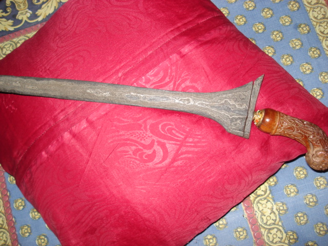

the other side of the sorsoran

Posts: 7,303
It might just be the photos themselves, but i am sorry to say that your cleaning does appear to have lessened the contrast in your pamor.
Old 21st December 2008, 10:37 PM   #12
skalomatias
Join Date: Jun 2008
Posts: 7
No it's just the photos.Bad light.
Old 22nd December 2008, 09:05 AM   #13
Henk
Henk's Avatar
Posts: 1,209
I'm afraid I have the same feeling like David. I can hardly believe the lime had no effect on the pamor contrast.
Old 22nd December 2008, 11:22 AM   #14
Posts: 7,255
May I enquire Jimmy, what sort of lime did you use, how did you use it , and how much did you use?
